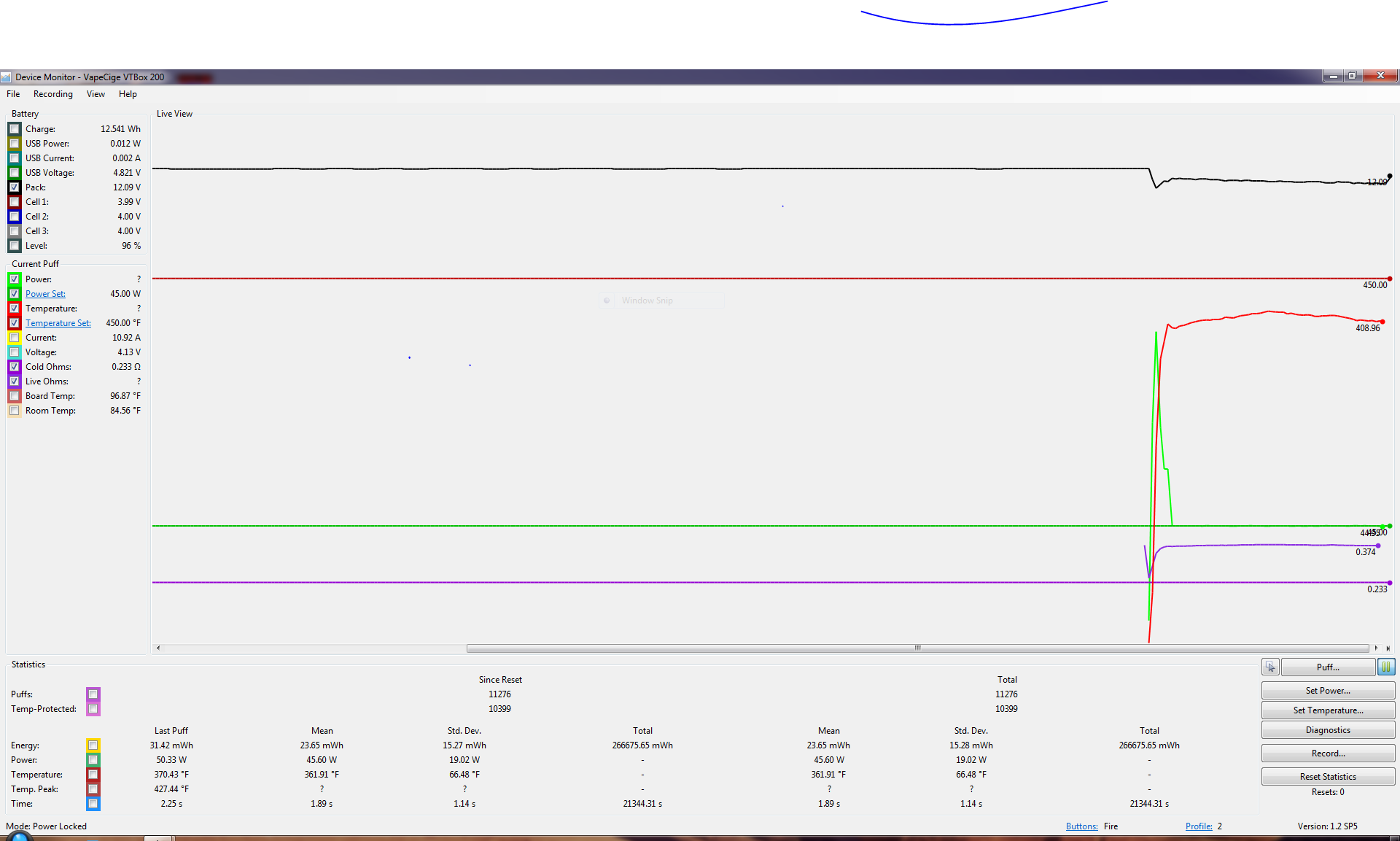

This isn't SS316 but here is a screen with 120 watts for 0.5 seconds preheat and 45 watts after. No air, just holding the fire button down. -

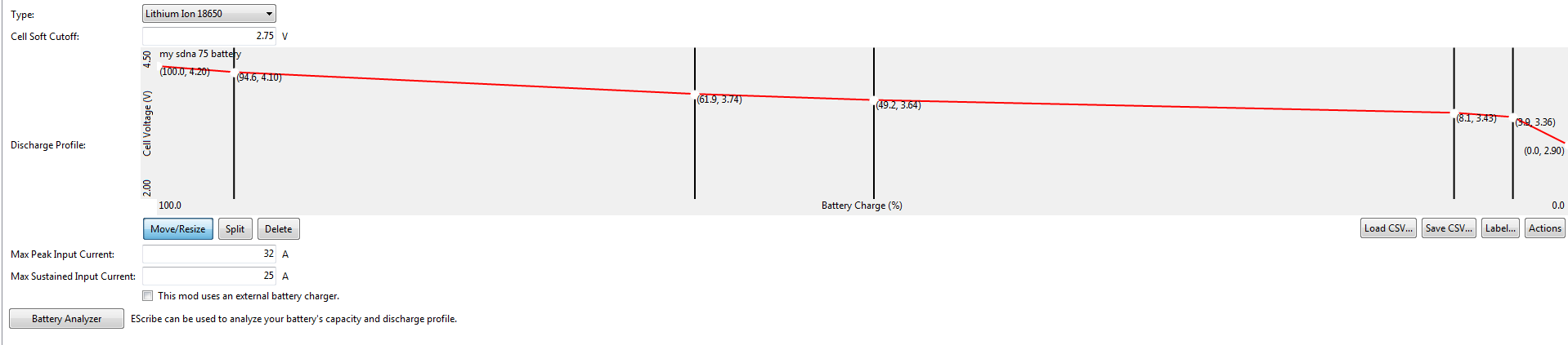

You might try setting your soft cell cut off to 2.65 volts (3.09 is ideal for LiPo)

Factory reset reverts the board to Evolv factory setting... not the mod's factory settings. So if your mod uses 2 cells instead of three the factory reset set it to 3. Use Escribe to change back to 2 if needed.
