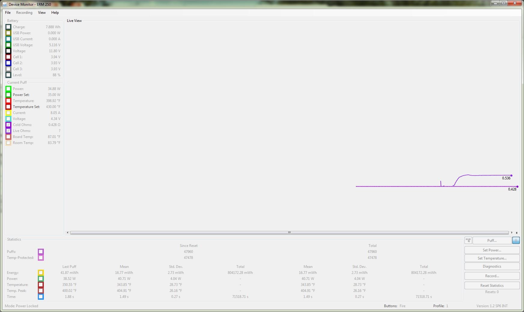

Check Device Monitor when fully charged, you should expect to see voltage around 4.13 - 4.14 volts area.

Use Device Monitor to check to make sure the wire's resistance changes from cold to hot. Kanthal and Nichrome will have the resistance stay the same as cold when heated, Replay will not work without the change taking place.

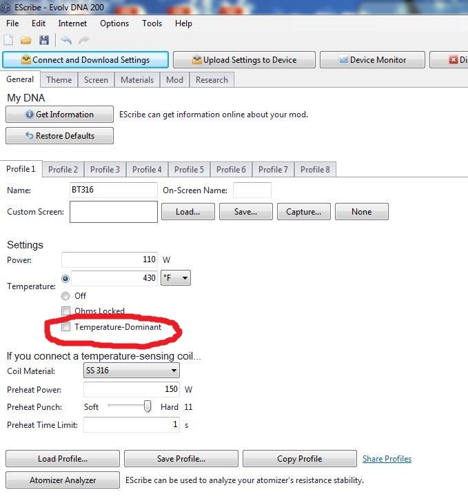

The Escribe snipet is showing Profile #1 but the mod is set on Profile #2

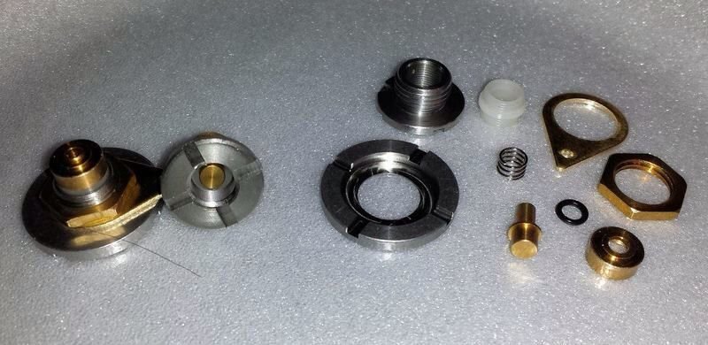

If you think you can and won't void any warranty. (Boxer's, that won't effect Evolv's) I don't know which 510 socket they used but some have a threaded plastic insulator that can be pushed downward, Loctite can be applied to the insulator threads to help hold it in place. I used Super Glue Gel to keep the one that I have like that in place. ( a tiny speck applied with a tooth pick) With seeing it you''ll have a better idea as to the fix I suppose. Below is Fatdaddy Vapes v3 that I'm referring to.
