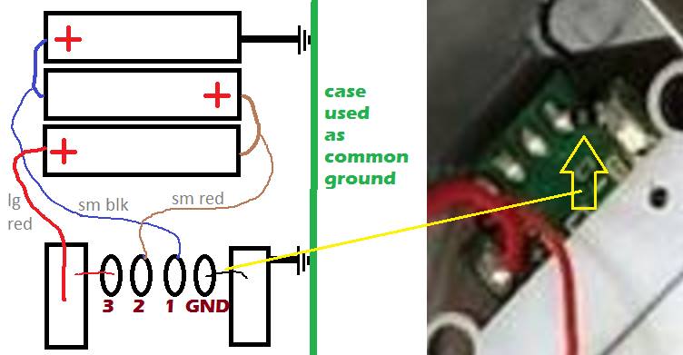

  12. This diagram was posted some time back by VapingBad in reference to the Reuleaux DNA200. If each cell is 4.13 volts then the cell you show having 3.xx volts should be 4.13 volts with the others being 8.26 volts and 12.39 volts. Using this diagram your pack voltage appears correct but voltage on the cell connected to pin #1 is low. Check the wire and it's solder connections that goes to pin #1 and to battery sled. (battery in upper position of diagram) I'm curious as to what pack voltage and cell voltages are showing in Escribe/Device Monitor
