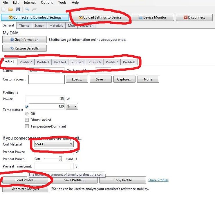

Well for one you need to make sure that Replay is enabled in the profile that you are using. Also make sure your flat wire is SS and not Kanthal or Nichrome. EScribe will be most helpful in resolving this, note difference between cold ohms and live ohms when firing using Device Monitor, TC wire increases resistance while Nichrome and Kanthal remain constant. Without a resistance change when heated Replay can not work.
