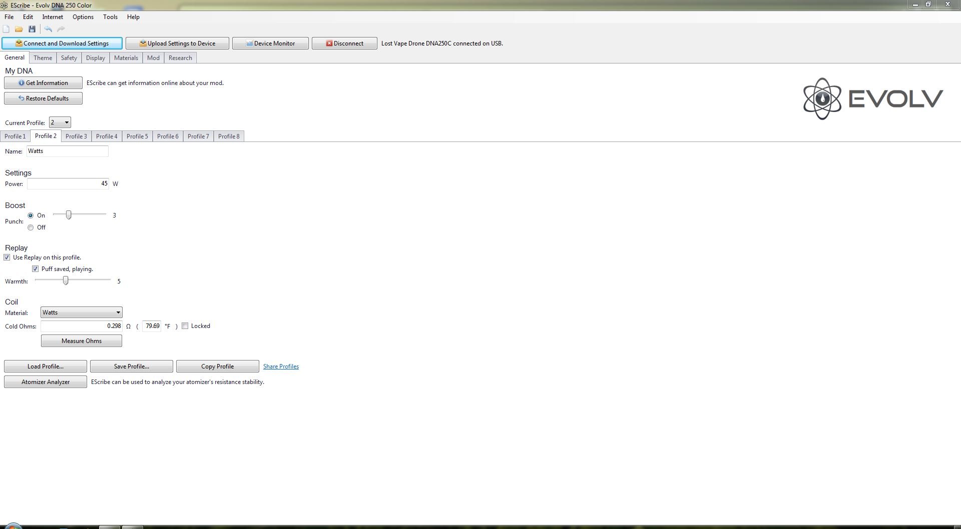

  15. I decided to try replay in the SS316 profile. So I go into EScribe and check the box for Replay and upload the settings. I then try it out, no choice for Reply. I had checked the box in the wrong profile, That's corrected and Replay is working in the SS316 TC profile. Mistakes are easy.

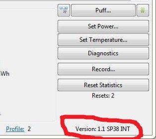

  17. While you seem to be getting slightly less change in resistance I feel it is enough for Replay to work. I was concerned that perhaps you were not using the International firmware so I flashed mine to the US version and Replay still worked. I'm not understanding that unless the Theme is allowing Replay to work. Here is a snip of Device Monitor showing firmware version anyway. It was my understanding that the International firmware was required for Replay but now it appears not, I'll be farther looking into that.

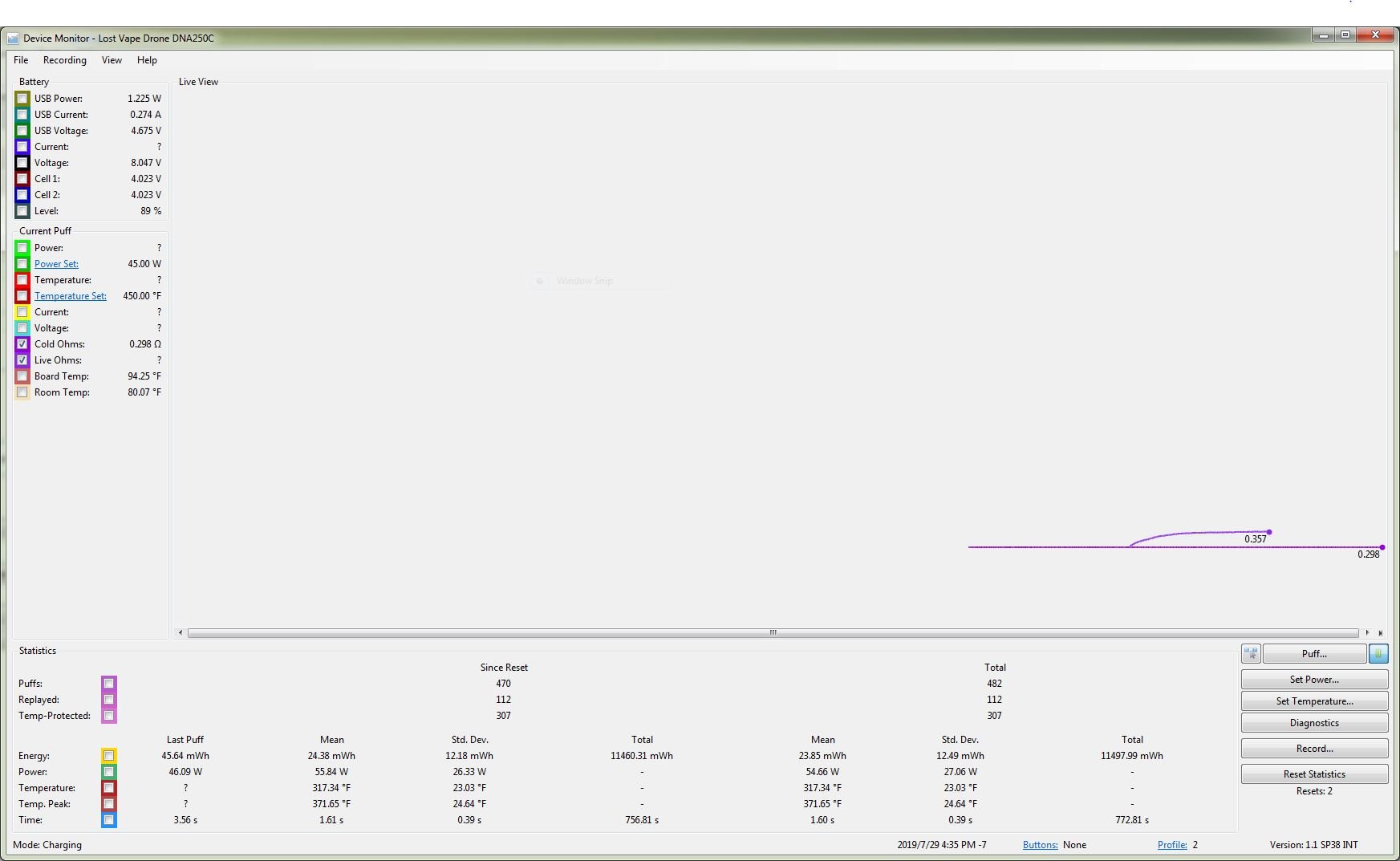

  18. I thought those Kanger coils had too much resistance change, here is SS316L Clapton on DNA250C. Also included is profile page. Replay is working.

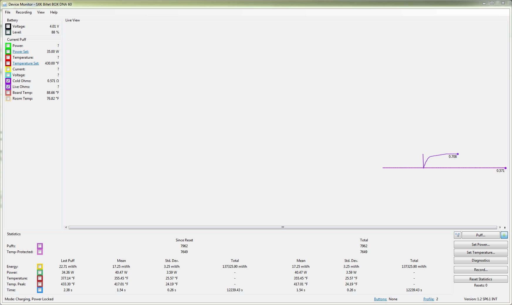

  19. 0.80 to 0.89 is hardly any change, here is mine, while the resistance is much higher than your note the % of change here. You are getting a 12% approx. increase and mine is around 18%, I'm thinking that Replay should work with that. Mine here is with Kanger SS316lL drop in coil heads, I see more of an increase than expected, I'll post a screen using a SS316 Clapton on next post in a couple of minutes.
