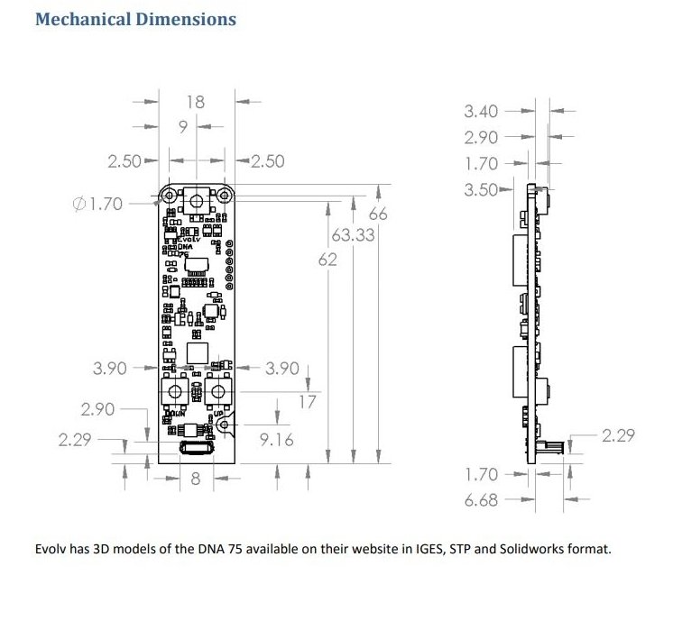

How about something like this? These boards are slightly longer because of the balance tap but otherwise the same as a DNA75
