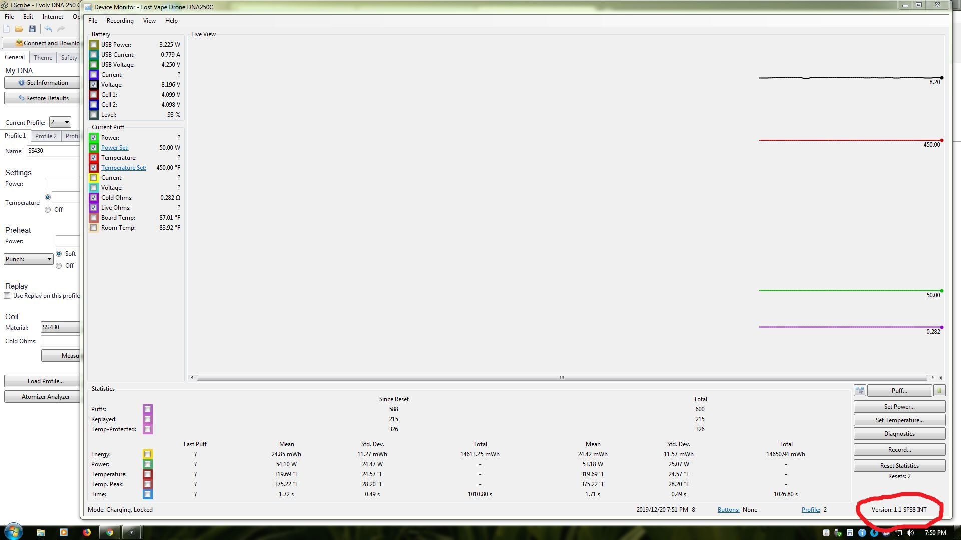

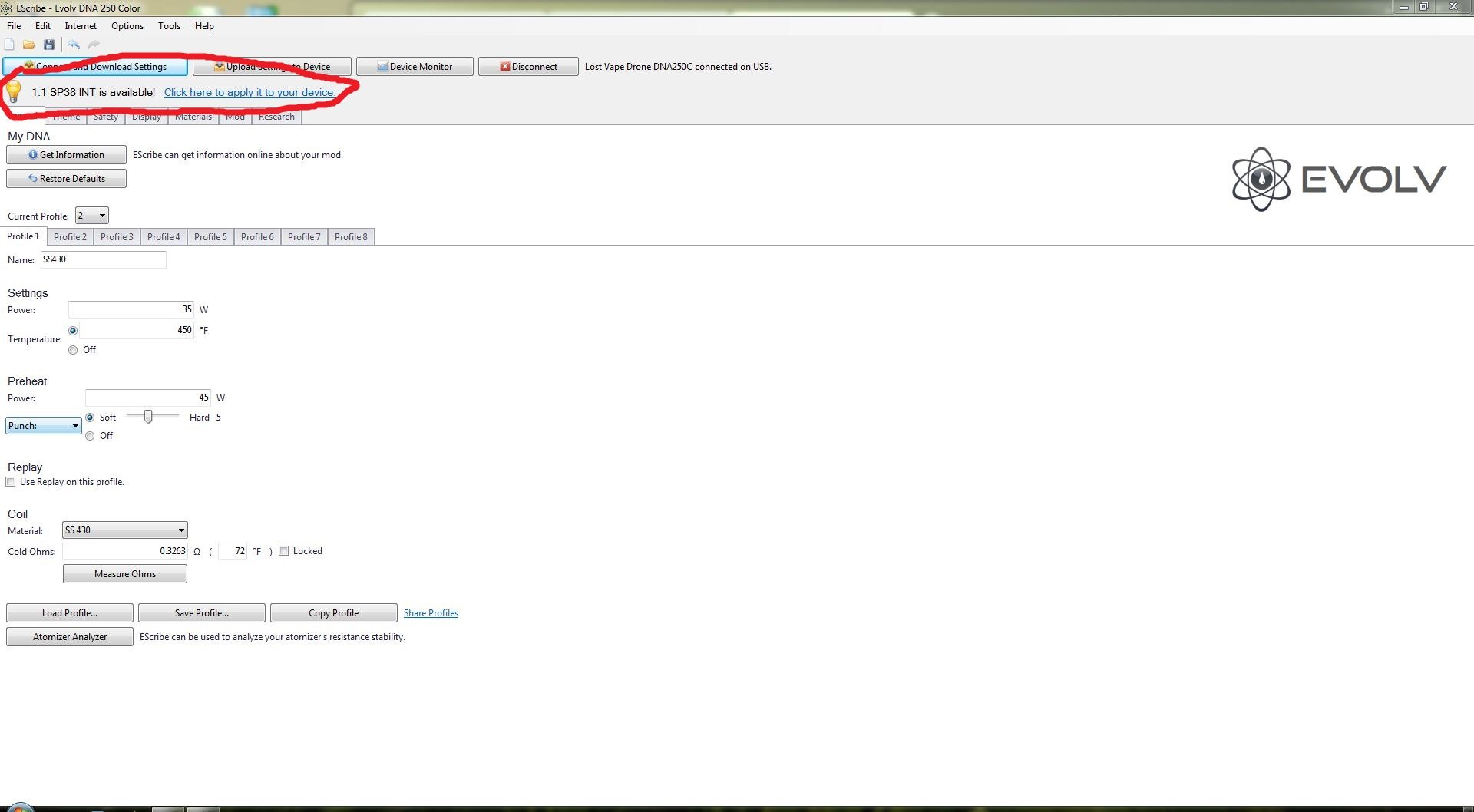

With your mod connected to EScribe and Device Monitor tab selected the firmware version is in the lower right side corner. The latest recommended version for 250C is 1.1 SP35 ( EScribe 2.0 SP17) and early release version is 1.1 SP38 (EScribe 2.0 SP19). https://forum.evolvapor.com/topic/66731-early-firmware-and-escribe-suite/ Most folks opt for the international version over the US version. EScribe will tell you when an update is available but early releases are not included. -

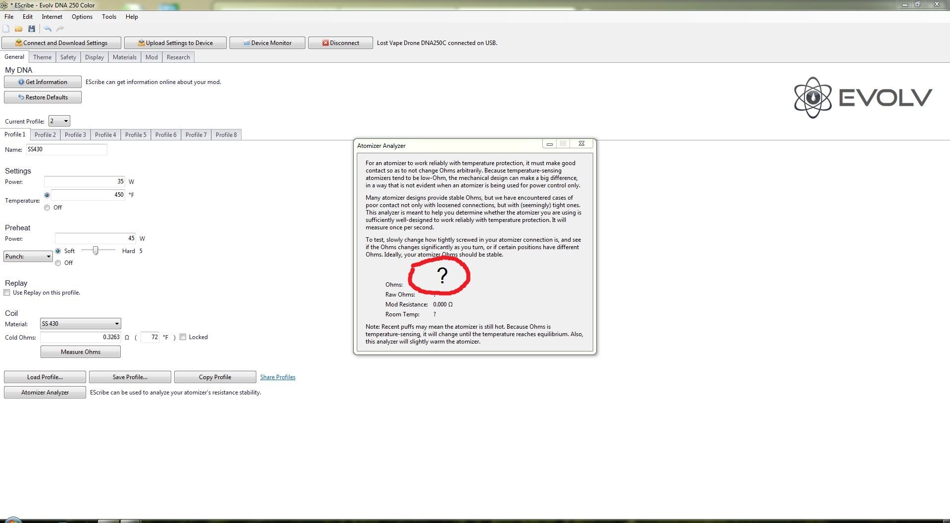

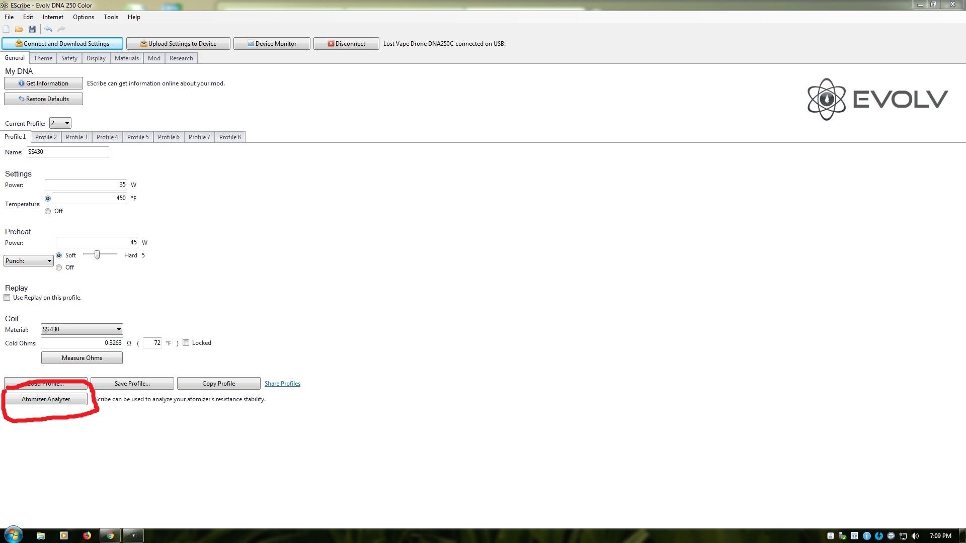

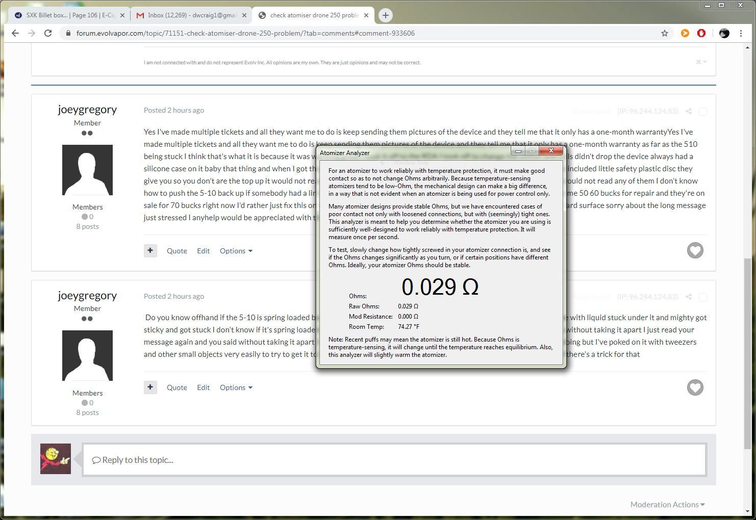

The 510 on the Drone is spring loaded and has a fairly stiff spring. This simple test will tell you if the 510 is electrically sound: Open EScribe with mod connected to computer with data cable with no atomizer and select Atomizer Analyzer at the bottom of the General page. Atomizer Analyzer should show "?" Next use a small screw driver inserted into the 510 to short the positive pin to the ground of the 510 (threads). If you get a reading of Ohms instead of a question mark then the 510 is connected to the board. If no change then the 510 is not properly connected to the board or the board it faulty.
Other than checking if the 510 positive pin is stuck at the bottom of the 510's body there is not much than can be done without disassembling it. Ask for help here: https://helpdesk.evolvapor.com/index.php?a=add&category=1 You will get a response, probably won't be till Monday as they don't operate on Saturdays or Sundays.
