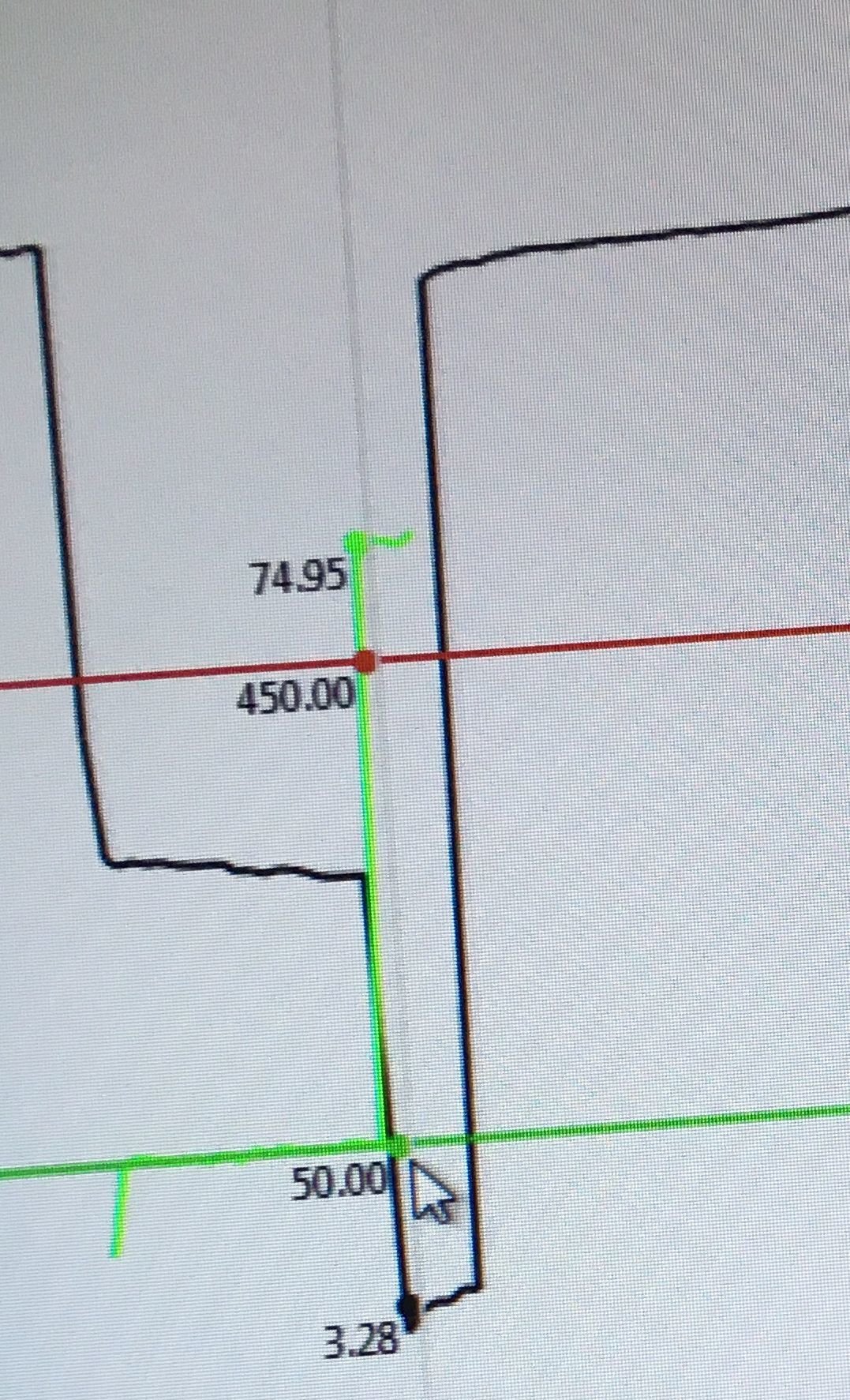

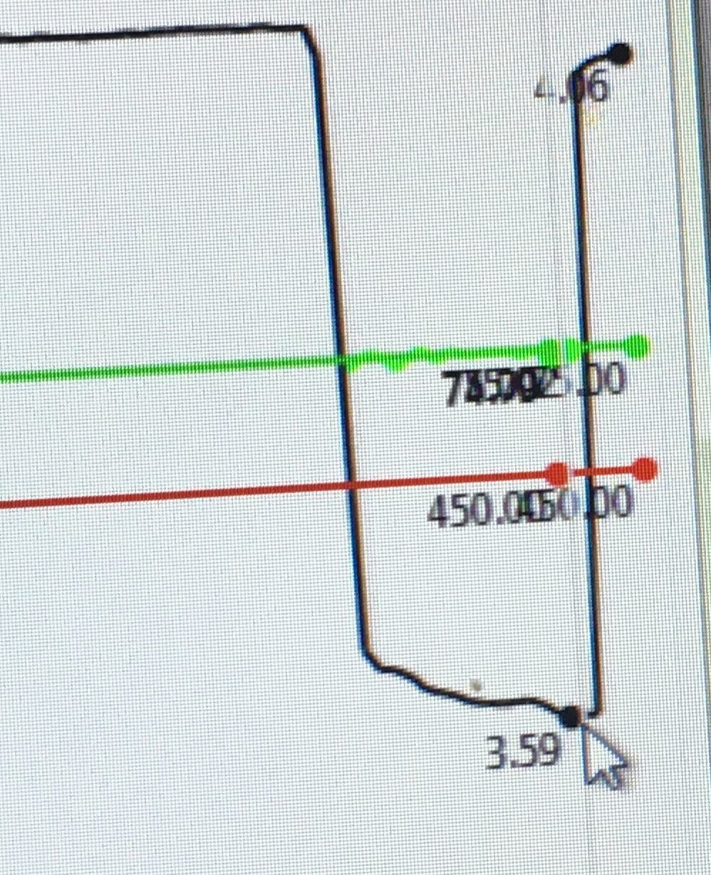

  22. Here is the difference on my VA spade before and after cleaning the battery cap with alcohol and Q-tip. That's a pretty big difference in voltage drop when firing. This is with a Samsung 21700 30T so a lesser power cell would have an even greater difference.
  23. While it could be a weak battery try this first: Remove the battery adjustment cap and clean the threads on it as well as the threads in the mod for it with alcohol. I have a VA DNA75 Spade and have to do this occasionally. Also what wattage are you using and what battery?
