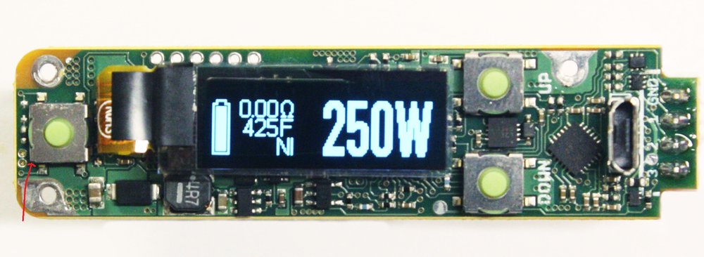

The 3 board mounting hole are of a different configuration between the 75C and 250C. The two top holes are 13mm apart center to center on the 75C and the 250C they are 15 mm center to center. The 250C is also a bit longer due to the balance tap than the 75C. I would suspect that the bottom mounting hole of the board would vary some as well, I didn't look at that.
