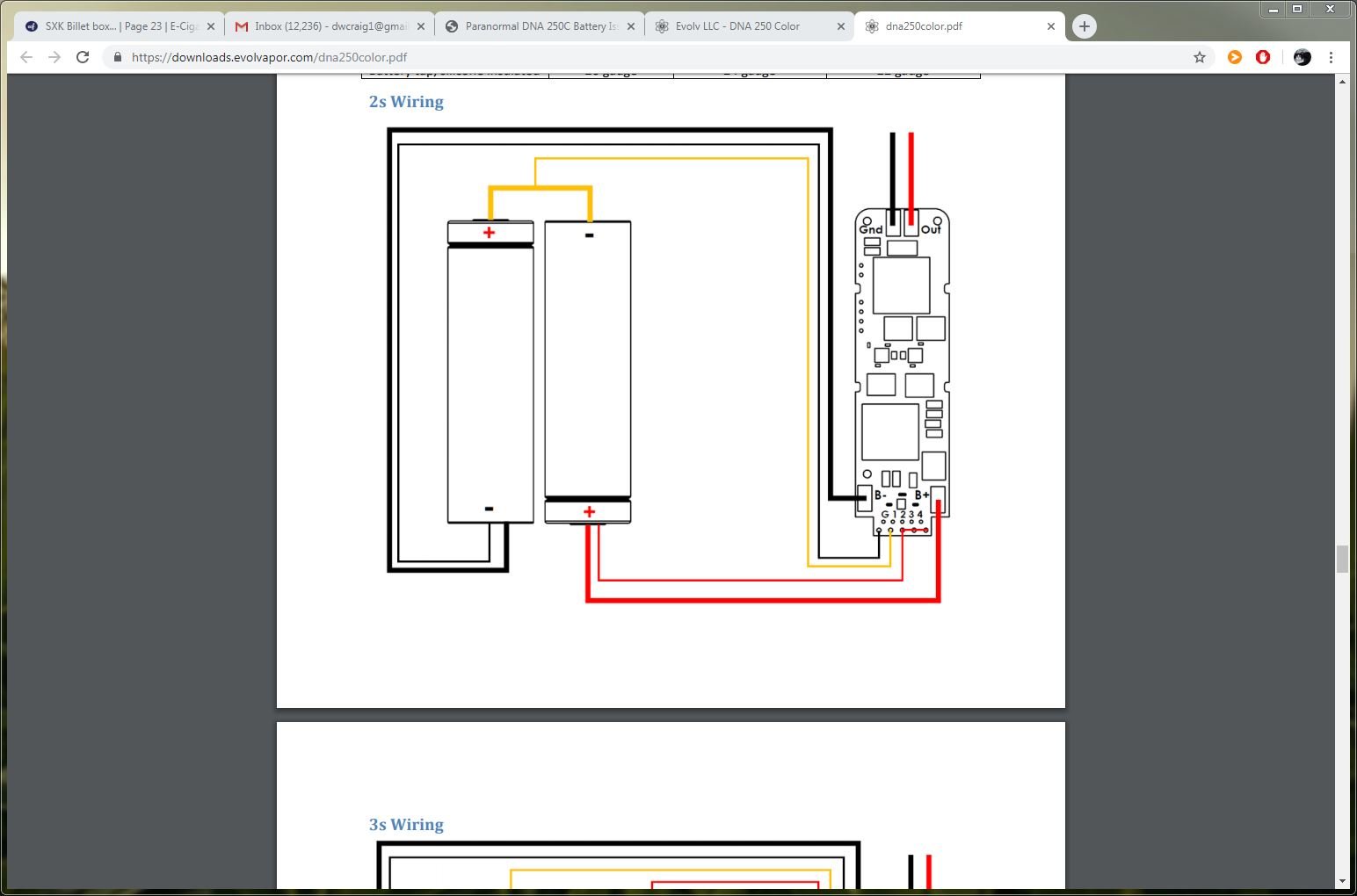

The voltage of the cell are measured via the balance tap at the bottom of the board. Note for 2S #2,3 and 4 are bridged to positive of cell #2, this is the preferred method. I'm not sure how Lost Vape wired theirs. Another way is to bridge batt + with #2.3 and 4, some manufacturers do it this way. I think that you will find your problem with the connection between cell #2 and tap #2 regardless of which way that they wired it. Example would be a poor solder joint, ect.

What does EScribe Device Monitor show for the voltage of each cell?
