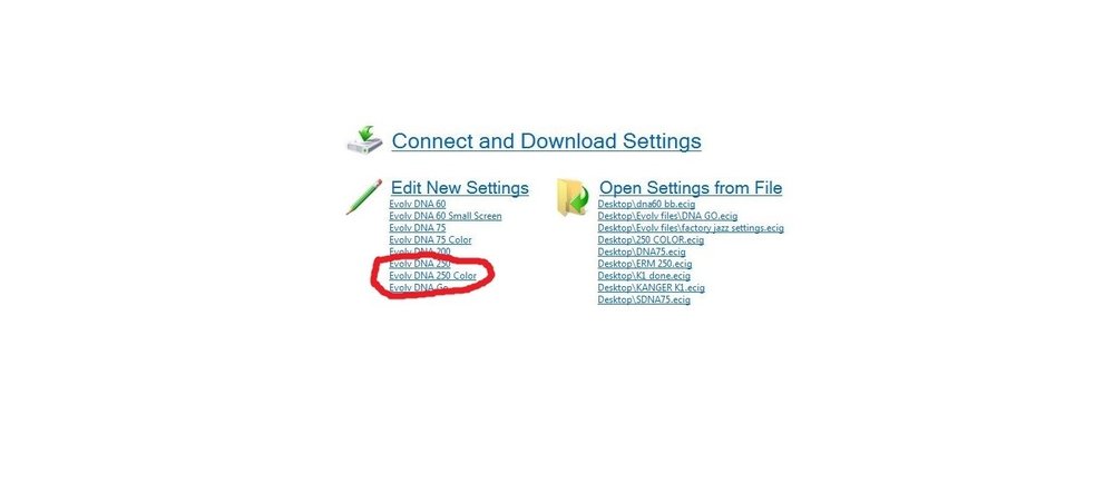

To check whether locked or unlocked use EScribe to verify, make sure to choose the Profile that you are using. If you make a change on the mod via theme be sure to hit the "Connect and Downlod Settings" to see any changes. The lock generally shows slightly open when unlocked but may be hard to see. This varies with different themes. Constantly asking if new coil is normally an indication that the resistance has greatly changed. Use Atomizer Analyzer to determine the stability of your 510 connection, it s should be making connection long before it bottoms out. If it makes connection with the last 1/8 turn then you most likely found the problem. Did the firmware update accomplish anything? Locking should not be necessary under normal conditions.

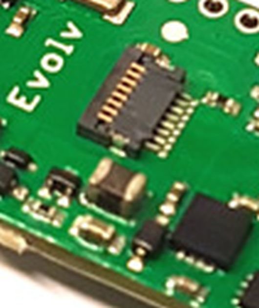

If it were me I would just get another screen and try it again. Try the screens operation before bending. It is most fragile close to the screen. Remember a DNA C board requires battery power to operate.
I can only guess here but I'm thinking that the screens ribbon got damaged during installation....just a guess.

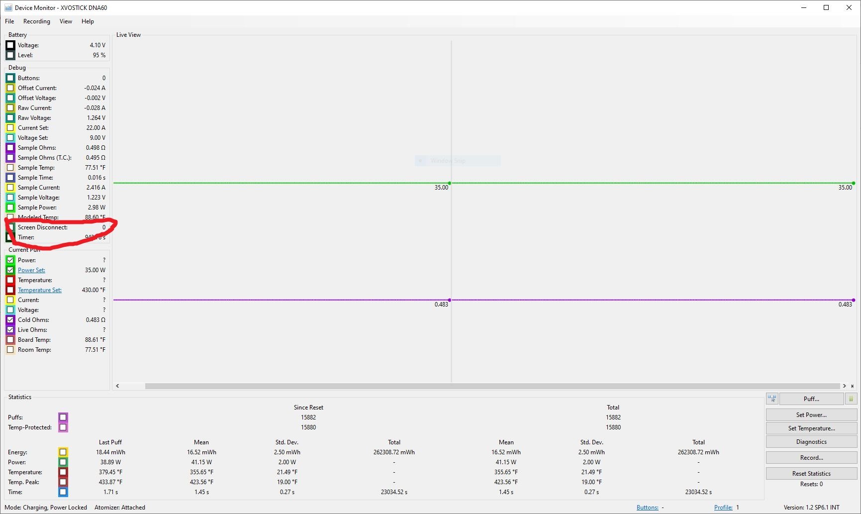

If still having issues with screen connect mod to EScribe. At top left of EScribe select "Help" tab then "About EScribe, the Evolv logo will appear in the center of your screen. Click on the logo 5 times and then open :Device Monitor. You will now have considerably more information on the left side. Look for "Screen Disconnects", if other than zero then the screen is not connecting properly for whatever reason (improperly in socket, bad ribbon, ect)

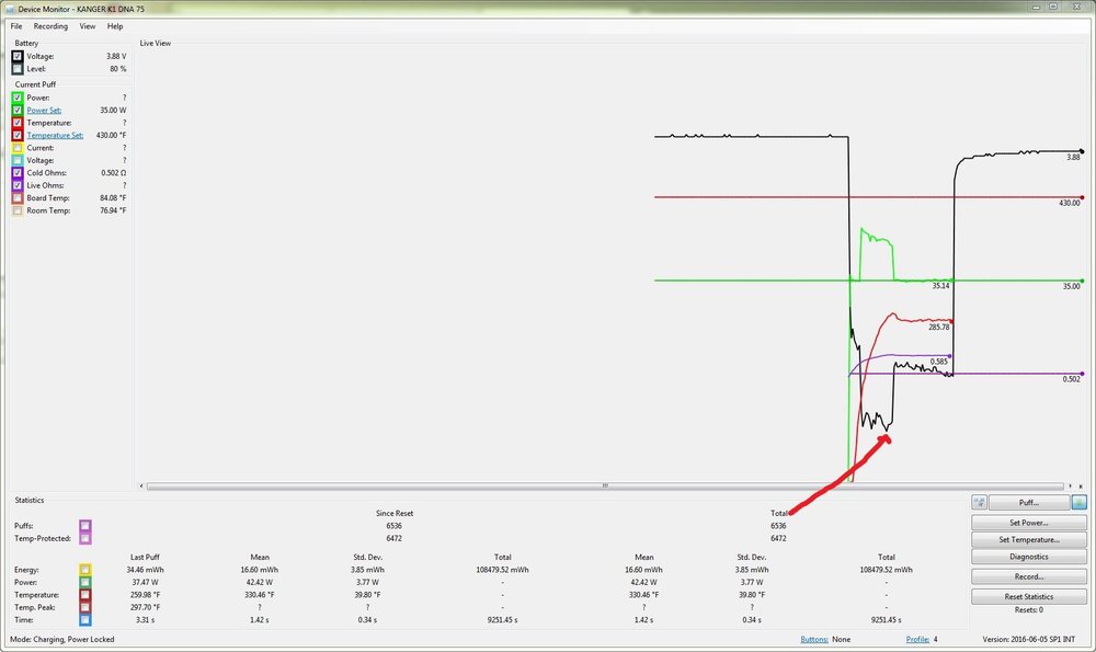

In Device Monitor check the box for (battery) voltage. While firing note what the voltage drops down to. If dropping below 3.1 volts then not enough power is being supplied to the board. This could be low charge on battery, poor battery or bad connections from battery to battery sled connectors.....ect. You should have no problem achieving 30 watts with correct power input. Edit: I'm assuming that Relay is off on above graph.
