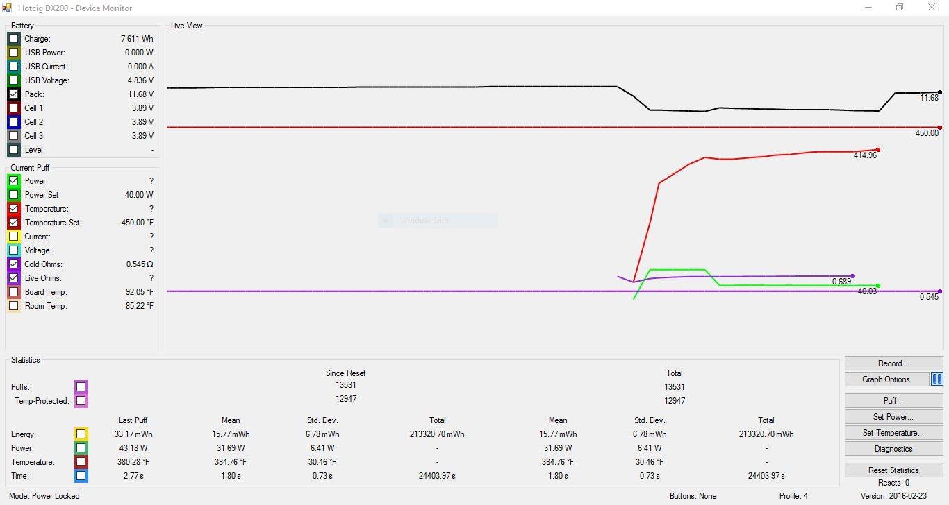

Using Device Monitor in EScribe will show quite a bit of information. Check the boxes for cold ohms, live ohms and power and post some screen shots of this happening. The Snippet Tool in Windows works well for capture. An example here, not replay but still good example.

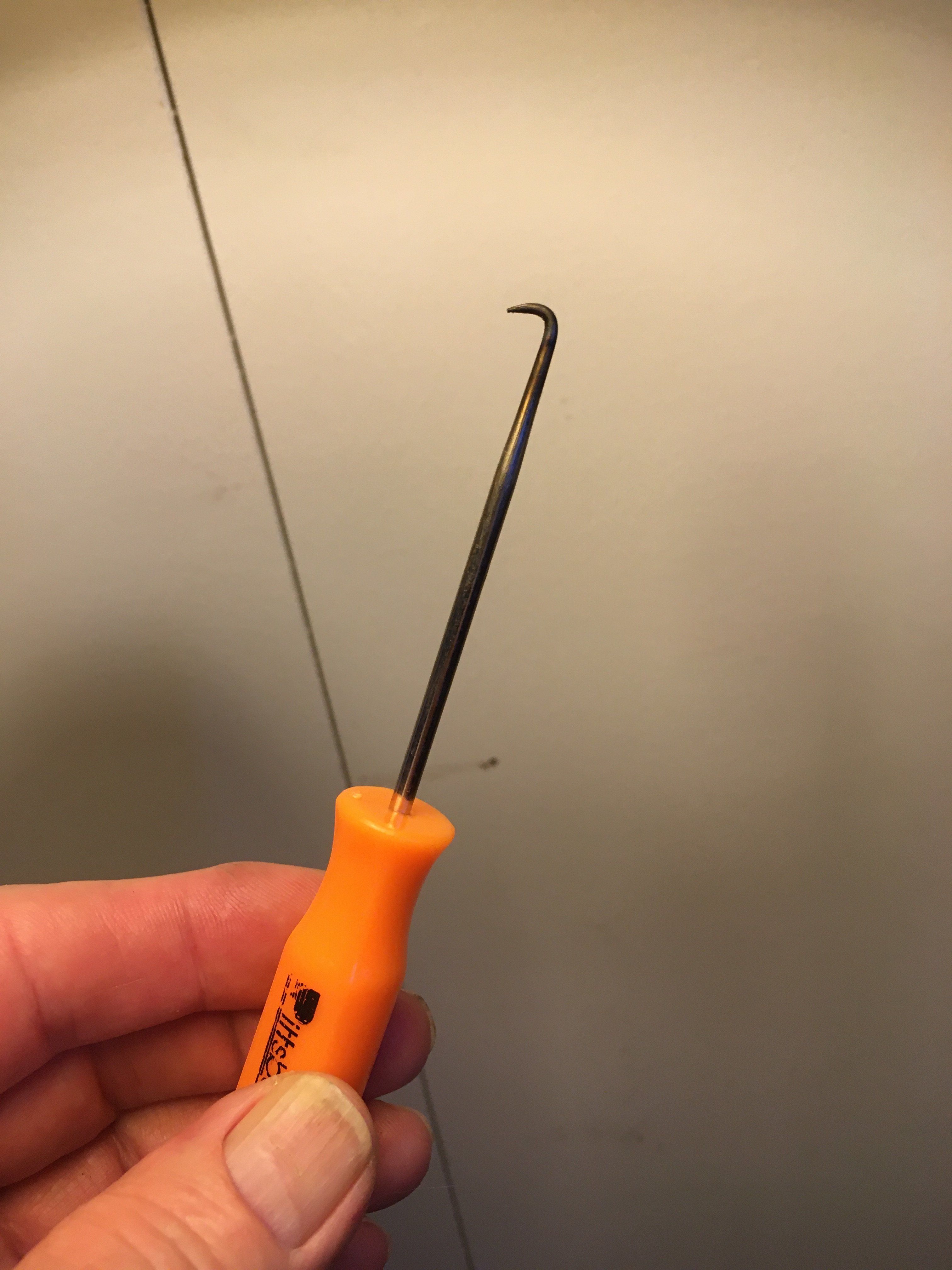

I have always wanted to see how VA wired it. I tried to remove the cover over the board but gave up. The cover is just press fitted in the case. I fashioned a tool from an o-ring pick and got the hooked end inside the little opening and pulled, the cover came right out. Note the black wire, it goes from B- to a spot on the case right under the board. How they attached it I'm not sure, that's copper to aluminum so maybe they glued it.(?) The 3 screws holding the board into the case are able to provide the necessary ground for both the board and 510 socket. All 3 screws on mine were a little on the loose side. I would guess that your problem is with the ground and not the positive.

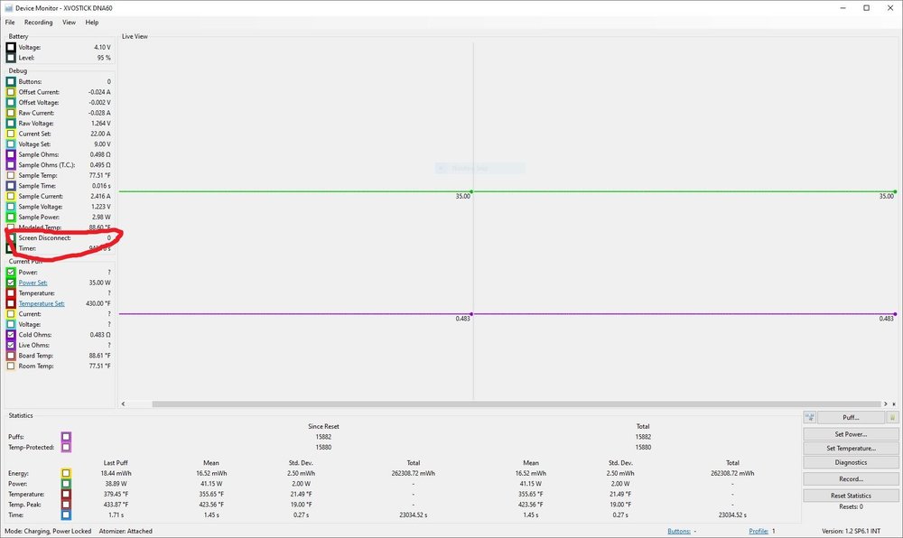

So I hooked up my DNA75 VA Spade to Escribe and started loosening the battery cap, here is the result in Device Monitor. This is what a bad connection between board and battery looks like. In this case the bad connection was between the battery and battery cap. But there are other places that could be problematic. Very possibly the 3 screws that hold the board to the case provide the ground for both the board and 510. Or a bad solder joint on the positive lead or contact. As I said I couldn't figure how to take mine apart, I wanted to see how they did the B- on the board. They could have used a wire to a stud in the case, I don't know.
