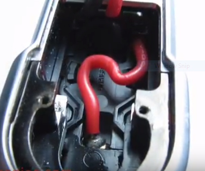

This is a 166 but I would think it would be very similar. https://www.youtube.com/watch?v=srfY6uQxSw0 -

dwcraig1 replied to Nishtara's topic in EScribe, Software and Firmware
Any chance that the 510's positive wire is making contact with the battery sled's positive contact? Does the Profile Unity have a slightly longer 510? -
