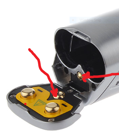

I'm thinking that your saying that the batteries disconnect. I'd be looking at the small spring loaded contact that the battery door connects with when the door is closed. That Is what I'd be looking at first. -

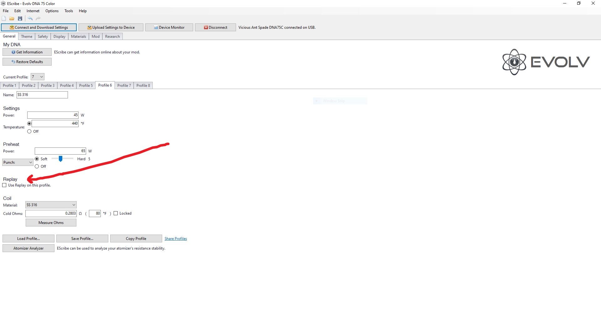

Make sure that the box is checked in the profile that you are using. If you are still not getting it to Replay check to see if you are using the International firmware and if not try that. -

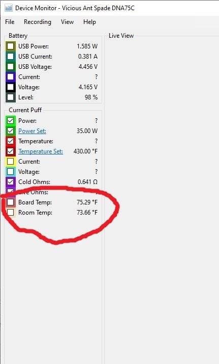

After looking at your Device Monitor snippet I see now what I missed earlier. Your cell #1 is 4..2 volts, that is full charge. Therefore the charger is balancing the cells and that's a bit of a slow process. After you bring all 3 up to 4.2 volts I suspect your problem will be gone. Let us know how it goes.
Device monitor shows that it is charging at a rate of 0.28 amps so it is charging but slowly. Try a different cable and\or power source. Check to see if USB port on the mod has dirt/lint in it. Your cells are slightly unbalanced but I don't think it's affecting charging but perhaps it is. Do you have access to a stand alone charger? If so charge them that way and get them balanced and see if that helps. Charging with data connection max is 1 amp and without data connection max is 2 amp.
