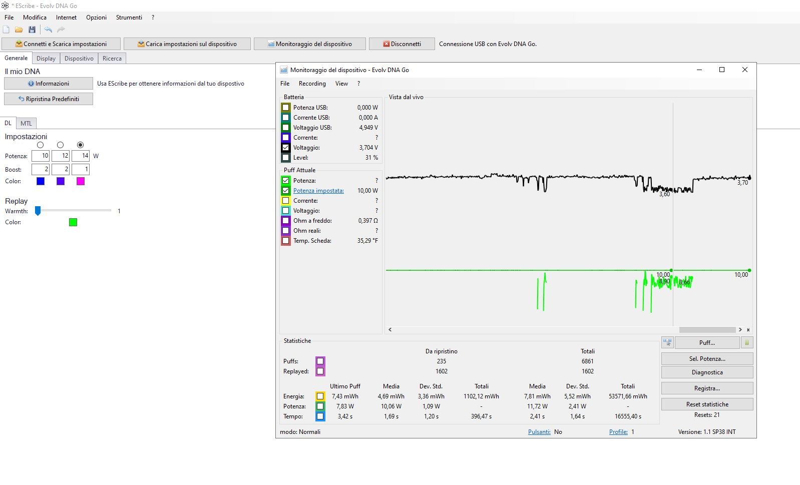

    I also tried to do the same tests that you made me do with the cup of the central pin disassembled, to understand if moving the wires or pushing the pin there was more current in the device manager, but it is the same thing !!!
  4. Pino74
    DNA GO 30-40 watt Born Just for Pod?
    Yes but the same behavior, I have two atomizers a femto rda bf, but i use it with normal pin, it is Made in Japan, and a Purity mtl 22 mm of the ambition mods.on both of the same behavior ... the atom are new, they have 15 days

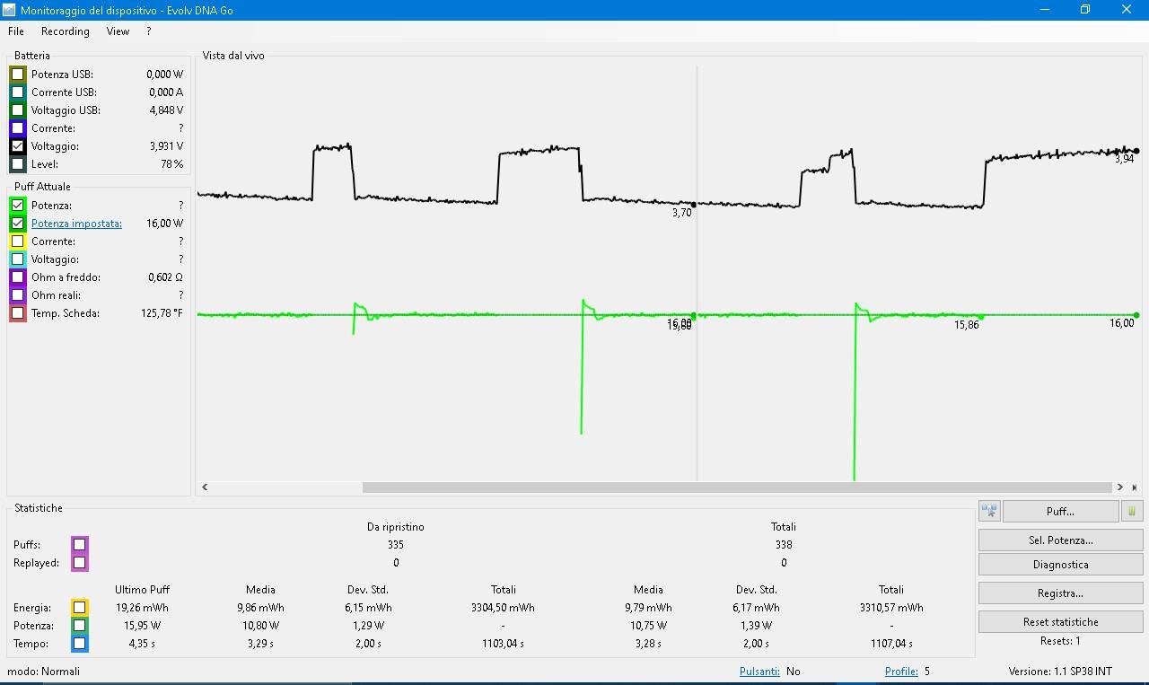

    Now jumping at 97% CHARGE and make one screen
  6. Pino74
    the battery I just charged, just inserted in the mod it gave me 98% in escribe, after the first fire 80%, but I'm sure it's charged !!!

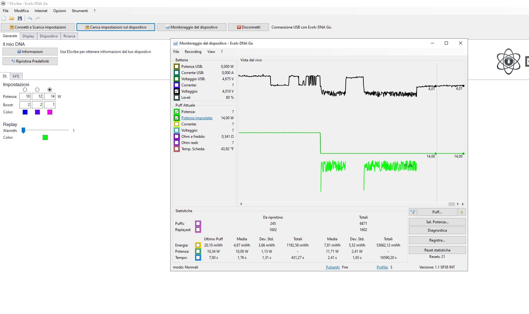

  7. Pino74
    But I noticed a strange behavior, when I change the profile, in the general tab between mtl and dl, the colors on the mod button always remain those of the Dl profile, maybe there will be some mess in the profiles? and then the power of the profile does not match with the power in the device manager .... I don't understand why ...

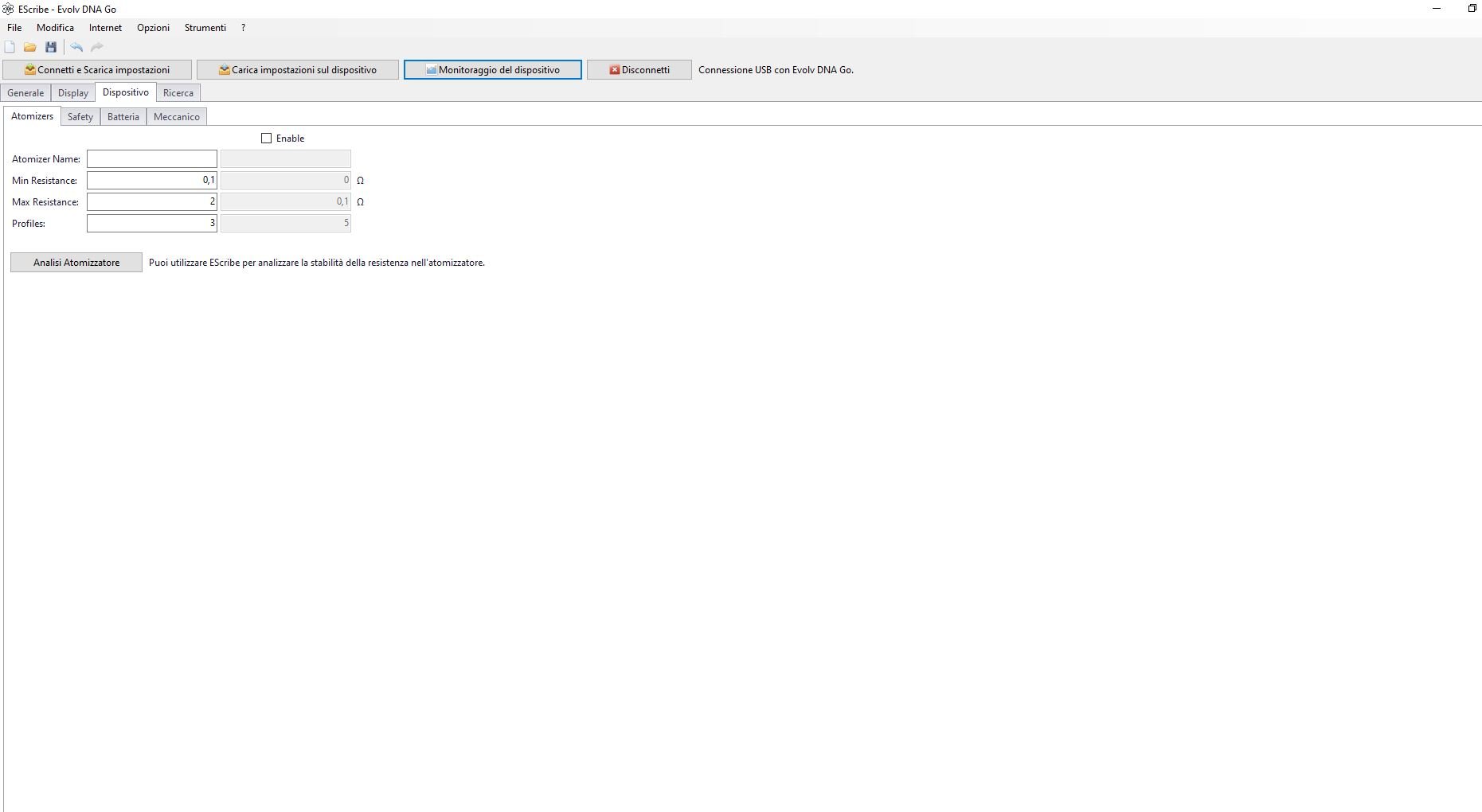

    Sorry retird what do u mean for atty?and for coil configuration? resistance on tip 2.5mm in diameter 5/6 turns ...ss316 26 awg-or 28 awg is the screen okay? I had the mod connected with the atomizer above when I made the screen
  10. Pino74
    MY atomizer setting=default
