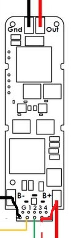

at my wits end with custom mod wiring / battery issue
dwcraig1 replied to yellow13mobius1's topic in Modders' Forum
As far as the total voltage , those readings are coming from the balance taps. I suggest that you open a ticket with Evolv here: https://helpdesk.evolvapor.com/index.php?a=add&category=1 -
Just to be sure, you got 4.18 volts each between G & 1, 1 & 2 and 2 & 3? -
This is how I would most likely wire the taps, I believe that you said that you tried it this way. Maybe use a meter and verify the voltage readings in EScribe. -
