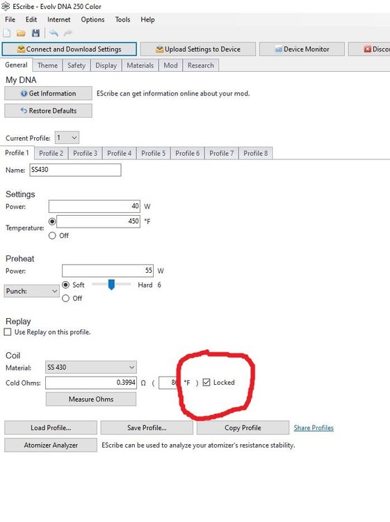

The board needs to know if the atomizer that you just put on is the old one and is perhaps warm from just using it. In such a case when you choose old the mod has remembered what the ohms were when cold and applies that setting. Select new and the board with use the existing ohm reading as cold ohms. Hope that helps answer your question, if not asked away.
