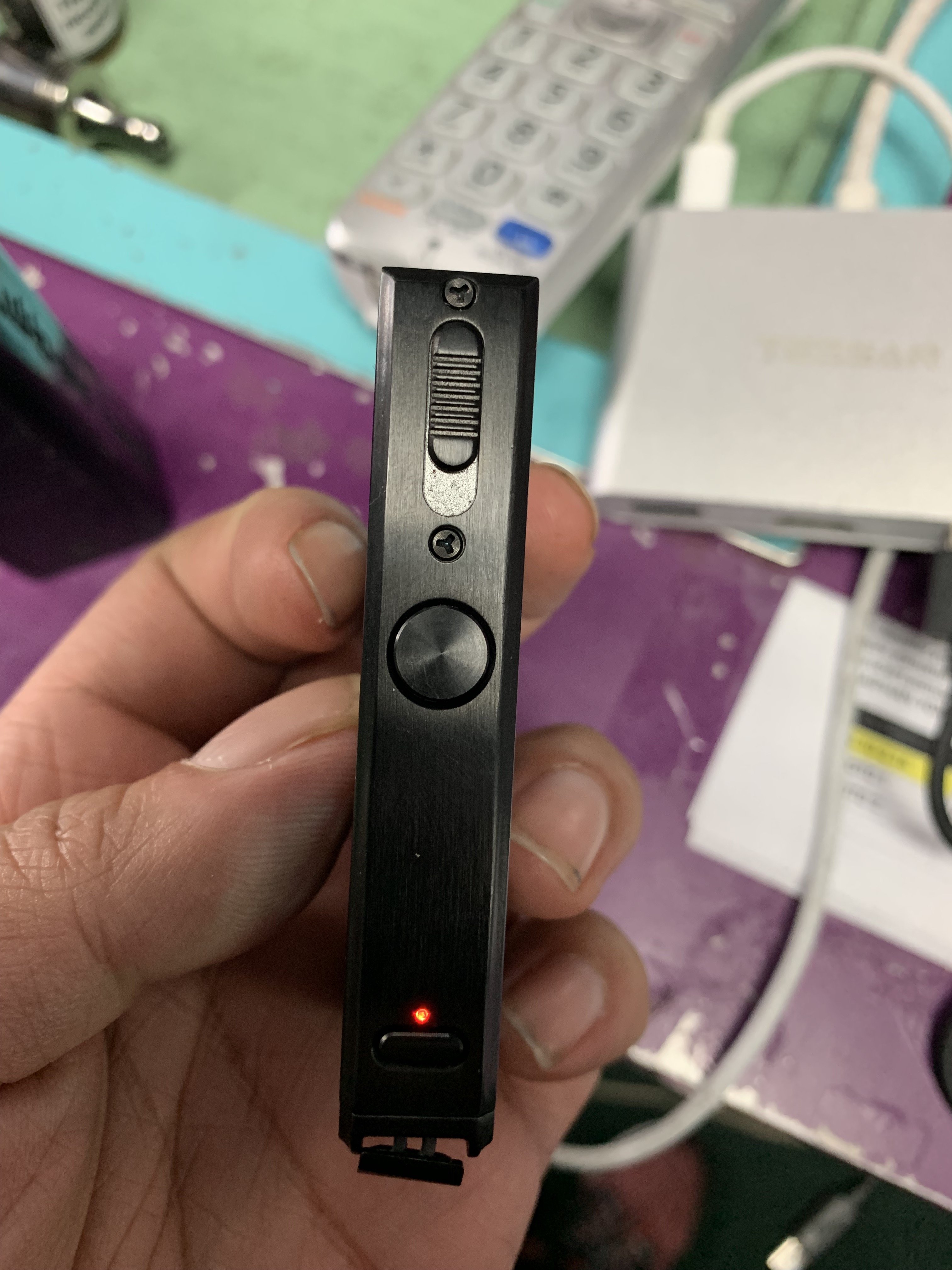

Guest Posted February 16, 2019 Report Posted February 16, 2019 DO NOT UPLOAD SP38 to Orion 40W it will not complete. I tried manually updating to SP38 on my orion and now it just blinks red. any one have any advice to reset to factory settings or previous versions? I tried restoring my settings to factory settings and my mac says cannot find serial number or there is an error with uploading the SP38 operating software. ive already redownload-ed escribe and with high hopes even the international version but no luck. my orion has no bricked with a blinking red light. if anyone knows a solution please let me know.
Wayneo Posted February 17, 2019 Report Posted February 17, 2019 @Robbchillin Was that plugged in directly, and not through any sort of hub? Have you tried another port?
Guest Posted February 17, 2019 Report Posted February 17, 2019 (edited) @Wayneoi had to plug it into a hub because of my mac book pro T.T i dont have conventional usb ports on the pro. #firstworldproblems Edited February 17, 2019 by Robbchillin forgot to add who i was replying to
