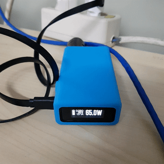

Just an update to my previous posts.. I've contacted for support and had been asked to roll back the firmware and i did, i went back from SP6 INT to SP5.1 and my device no longer suffering from power cut offs.. the downside is i lost the boost feature... dang it.. I hope they found out the problem and got them sorted out..
for now i'll upgrade again to SP6 and enjoy the boost feature and charge my device with 1A only just to be safe :yum:
Quick update
Waiiiitttttt, i re-applied SP6 then issued a Hard Reboot from Diagnostic menu/button, the power cut offs automagically disappears..
i will monitor and update again if the power cut offs came back
@James @Nick could this power cut offs caused by bad flash of SP? or the hard reboot is necessary after an SP flash?
Update again
It is true after doing a hard reboot i've successfully charged from 70% or so to 100% without being interrupted at all.. however unfortunately this morning when i charge my mod i noticed the cut off returns, i've recorded a video of this and still trying to figure out how to convert this to gif so i can post it to the forum thread

i can confirm that no cut off happened while on SP 5.1, and very positively sure it didn't happen before upgrading to SP6 and after downgrade from SP6.. because i have a habit whenever i charge my mod, the screen is always facing my direction, as soon as the battery reaches 100% and current goes less than 0.20A then i disconnect the chargers. i do this almost everytime, except when i go to bed, i charge it with anker powerbank which is intellegently turns itself off after the mod no longer accepts charges..

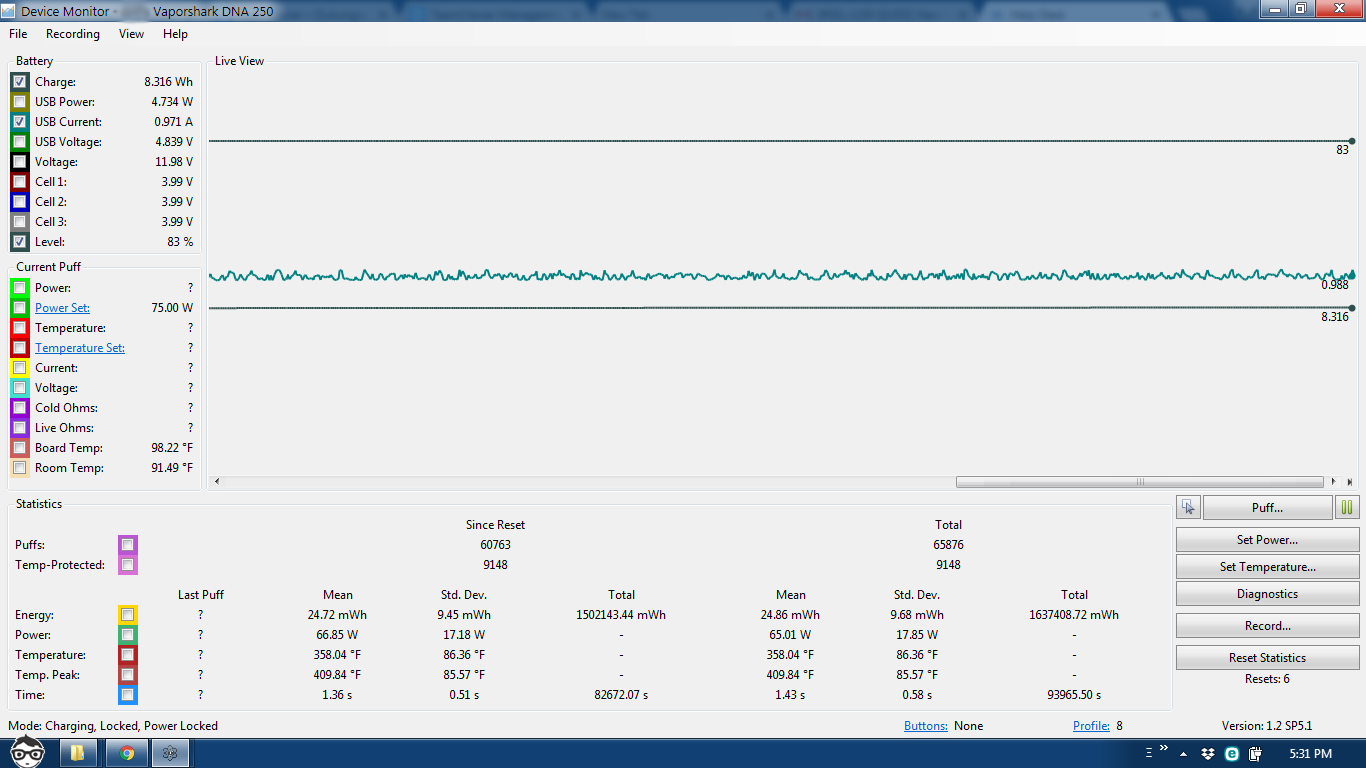

edit: have you seen my graph on page 49? it has down spikes which i'm not sure have happened before, i rarely use escribe for anything except for theme changes 😉
Edited by Twiq
UPDATE
@James @Nick
I have found a workaround to prevent power cut offs from happening on my Vaporshark DNA250 with SP6 INT.
The trick is NOT charging the device directly after a vaping session, but you must let the device to go idle then turns off by itself, after the device is off then plug the chargers,
the boot screen will show and will charge normally.
Note : i don't know a couple of quick draw counts as a session or not and i haven't tried, but usually my session  eats 10%-15% of battery..
i've been doing this 3 times since last night and it's doing great for me.. I'll keep monitoring this
however it's pretty annoying to wait for the device to go off by itself then you can charge
