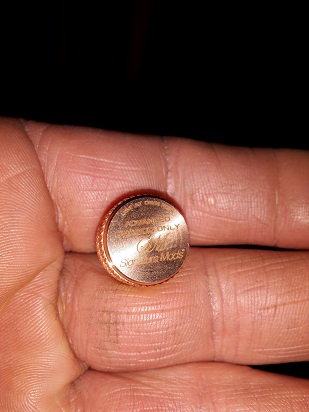

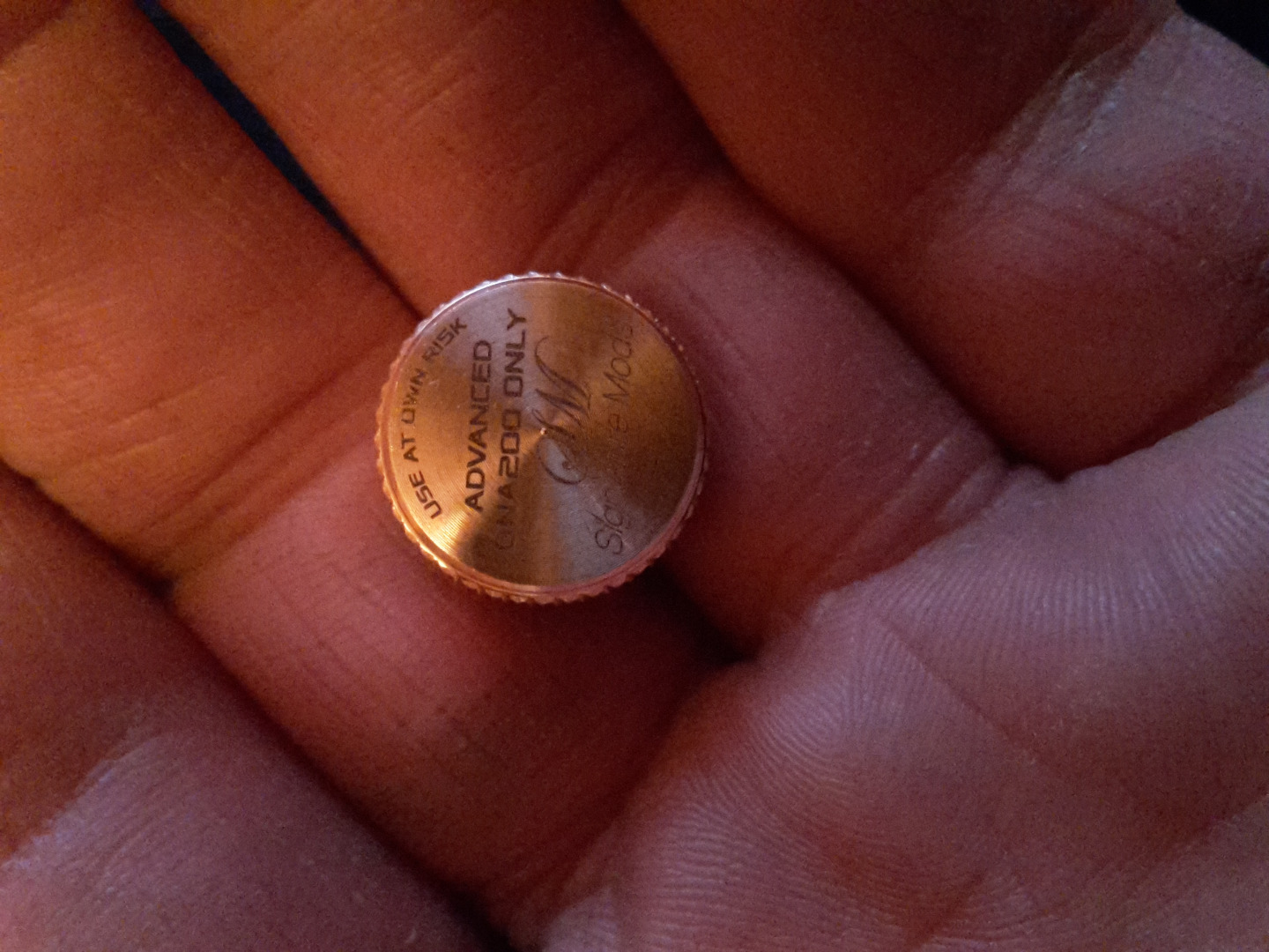

skineedog Posted August 12, 2016 Report Posted August 12, 2016 SteveF said:Why has the internal resistance changed on my mods? Is this part of the firmware smoothing that has improved the response of temperature protection? I have 3 mods 0.003, 0.004 and 0.007. Checked regularly enough but are now 0.007, 0.009 and 0.011-12 Atomiser analyser won't actually register a constant with the copper tool screwed in and only then give a reading as the tool is unscrewed. surely my mods can't have zero resistance now? Is the board now compensating? I too am experiencing this same issue. Mod's resistance is not registering properly as before and coil resistance seems to be dropping lower than I know it to be then coming back up after sitting idle awhile. When using the copper resistance tool the mod shows 0 resistance. This was after the sp3 update.

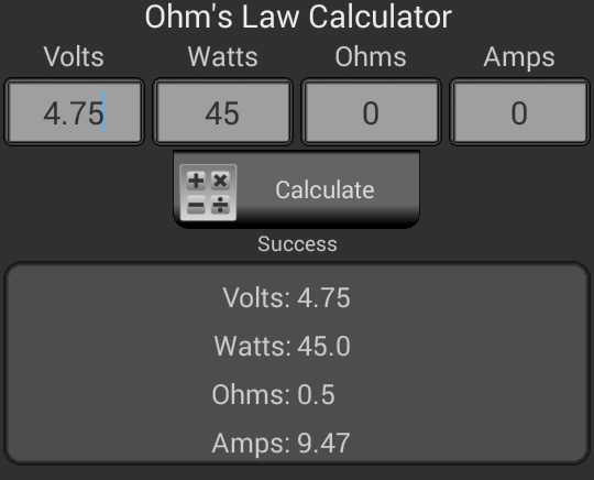

dwcraig1 Posted August 12, 2016 Report Posted August 12, 2016 For what it's worth I just did a little testing using a Magma RDA. I used my VTbox200 running SP3. Using EScribe voltage readings and a volt meter on the RBA's posts. I then rolled back the firmware to 2-23 and compared the two.I also used an IPV2 and took voltage readings off the posts of the RDA.Wattage set at 45 and temp offEScribe with both firmware said 4.75 volts, the voltage readings off the RDA's posts were the same also, 4.39 volts.Voltage readings taken from the RDA posts on the IPV2 also was 4.39 volts.

Modbustersecig Posted August 12, 2016 Report Posted August 12, 2016 dwcraig1 said:For what it's worth I just did a little testing using a Magma RDA. I used my VTbox200 running SP3. Using EScribe voltage readings and a volt meter on the RBA's posts. I then rolled back the firmware to 2-23 and compared the two.I also used an IPV2 and took voltage readings off the posts of the RDA.Wattage set at 45 and temp offEScribe with both firmware said 4.75 volts, the voltage readings off the RDA's posts were the same also, 4.39 volts.Voltage readings taken from the RDA posts on the IPV2 also was 4.39 volts. OK if you are using a ipv 2 to check anything your most likely getting false reading do to ground issue on the 510 pm me I send you a link showing how to fix it as far as power to the atty using DNA 200 my experience very dead on with any firm ware if you are running .5 coil and I believe you are dead on edit had point in wrong spot sorry
dwcraig1 Posted August 12, 2016 Report Posted August 12, 2016 Since it is close to the same (same actually) to what readings I got with tha DNA 200 I don't see any problem. Thanks though.Had I measured the voltage where the 510's wires are soldered to the board there probably would have been a different reading.The main grit of my post was that the output measured was the same on the DNA 200 with both firmware.
SteveF Posted August 12, 2016 Report Posted August 12, 2016 update.All have been to zero, cleaned the 510s again and taken the surface off the copper tool. Its clean.All have been checked prior to reboot, the soft reboot performed and re-run the analyser and the results arewismec Rolo, OE 0.003 before update 0.004 before reboot 0.007 now 0.007DNA200 before update 0.007 before reboot 0.012 after reboot 0.010 but not holding steady reading its flashing ?-0.010-?-0.011-?-0.012 and only reads ? when fully screwed in.SMY-DNA200 before update 0.004after update....0.009after reboot.....won't give a reading now with the copper tool in any position
yoseff Posted August 13, 2016 Report Posted August 13, 2016 Today i upgraded a friend's Efusion Duo. Did measured before upgrade with my tool and it was 0.004 .Immediately after upgrade to SP3 it had the same behavior of mine - the ? So now i am 100% sure. SP3 change internal resistance settings. My doubt now is: Keep the same 0.004 or change to 0?Also is it 0.004 or 0,004?Note: That big guy was like a child with a new toy after try the smoothness of SS16L now. Before was using temp limit as safety, now is using temp dominant in pure temp control.
James Posted August 13, 2016 Report Posted August 13, 2016 I don't think the internal resistance has changed. 1.2 SP3 may have trouble reading resistances that low, probably due to some of the extra protection code we added. I'll have to look at it this coming week. Other than this issue, I am glad it is working well for yall.
