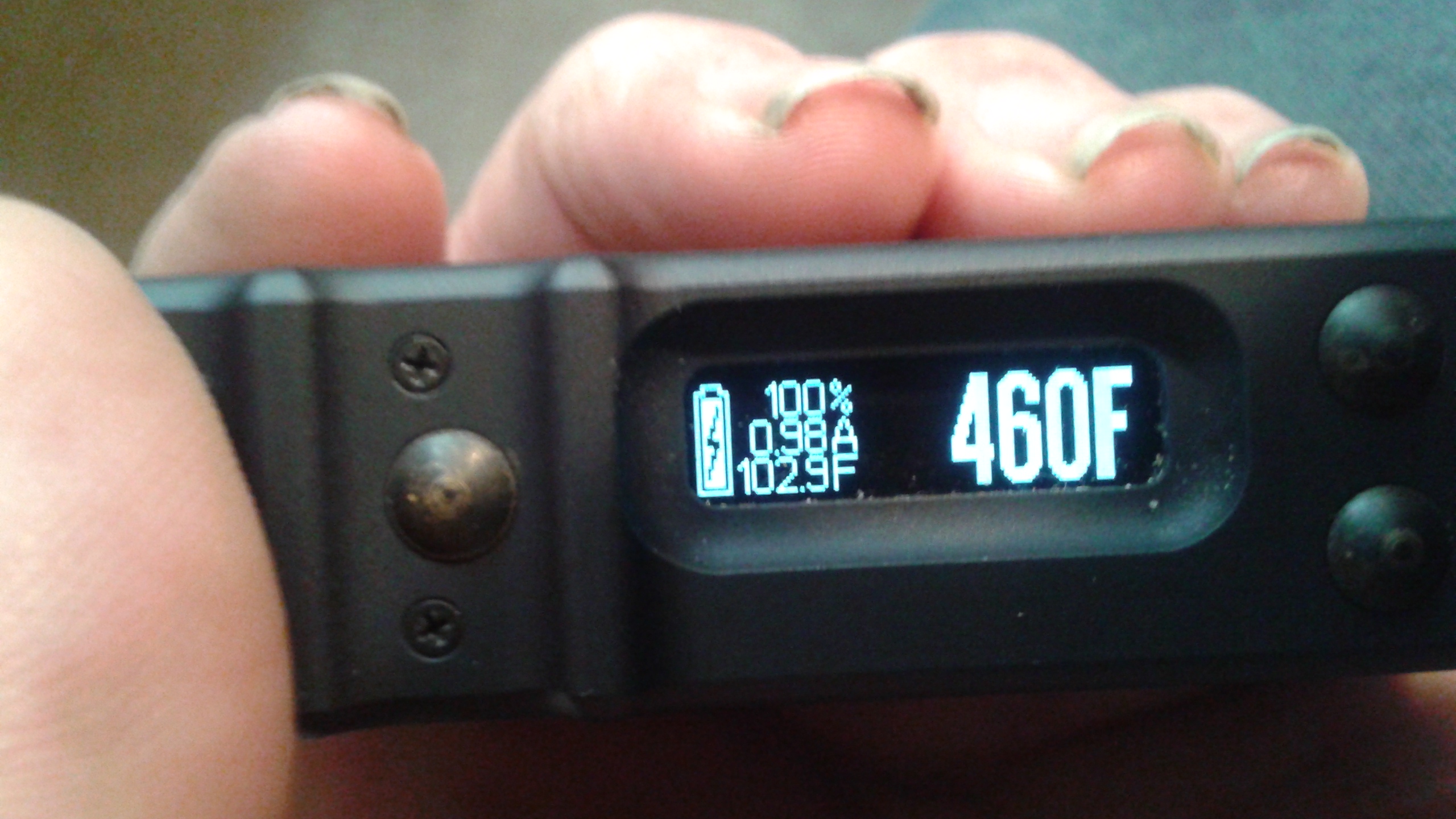

Got a question I noticed 102 degrees board temperature DNA 200 when changing After doing the up date the cells are equal and it is showing. 95/.98 amp charging is there something I should check my other mods all Opus DNA 200 95 degrees is tops when charging room temp is 84 thanks
I've seen that many times before even when the room temperature is 68ºF. It especially gets up there just before the current starts to go down because it is almost fully charged. And I am still running the February firmware.
