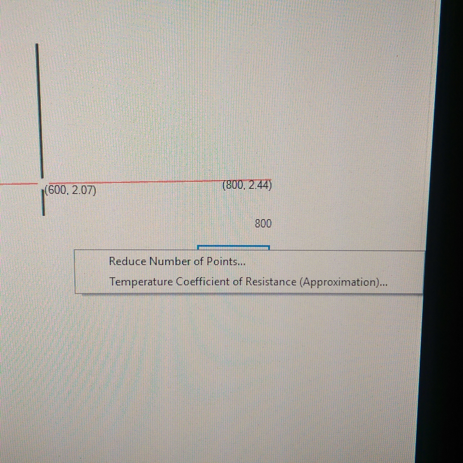

mstave Posted February 12, 2016 Report Posted February 12, 2016 Just installed the new escribe version and updated the firmware in both my devices. Am I correct in seeing that there is no way to set up a profile or material using a TCR value? I'm using the Dolphin tank with a tungsten ceramic element, and this is a bit of problem. I see nothing that looks like a temp coeff graph. Would appreciate some help with this.Edit - it looks like I will have to create a csv file using a TCR of 0.0045 for various temp points, and then import it to escribe. I'm hoping I am just brain dead and missing something, cuz this seems a rather large loss of functionality.
Spector NS5 RD Posted February 12, 2016 Report Posted February 12, 2016 mstave said:Just installed the new escribe version and updated the firmware in both my devices. Am I correct in seeing that there is no way to set up a profile or material using a TCR value? I'm using the Dolphin tank with a tungsten ceramic element, and this is a bit of problem. I see nothing that looks like a temp coeff graph. Would appreciate some help with this.Edit - it looks like I will have to create a csv file using a TCR of 0.0045 for various temp points, and then import it to escribe. I'm hoping I am just brain dead and missing something, cuz this seems a rather large loss of functionality.good point i just looked and noticed as well they took it away or i just can't find it. the box that lets you input your own TCR value is no more? that's a bad move. it was so nice to be able to just throw a tcr value in and call it good. i was hoping for a tcr adj from the mod itself, TBH. like joyetech, yihi, or sxk.

mstave Posted February 12, 2016 Report Posted February 12, 2016 ChunkyButt200 said:[QUOTE=mstave]Just installed the new escribe version and updated the firmware in both my devices. Am I correct in seeing that there is no way to set up a profile or material using a TCR value? I'm using the Dolphin tank with a tungsten ceramic element, and this is a bit of problem. I see nothing that looks like a temp coeff graph. Would appreciate some help with this.Edit - it looks like I will have to create a csv file using a TCR of 0.0045 for various temp points, and then import it to escribe. I'm hoping I am just brain dead and missing something, cuz this seems a rather large loss of functionality.good point i just looked and noticed as well they took it away or i just can't find it. the box that lets you input your own TCR value is no more? that's a bad move. it was so nice to be able to just throw a tcr value in and call it good. i was hoping for a tcr adj from the mod itself, TBH. like joyetech, yihi, or sxk.[/QUOTE]If you know who to ask about this, and could put in the question, that would be great - I'm having a hard time believing that they just shit-canned the function.

HybridFGSI Posted February 12, 2016 Report Posted February 12, 2016 I clicked on material then selected ti then clicked actions.
flem Posted February 12, 2016 Report Posted February 12, 2016 ChunkyButt200 said:[QUOTE=mstave]Just installed the new escribe version and updated the firmware in both my devices. Am I correct in seeing that there is no way to set up a profile or material using a TCR value? I'm using the Dolphin tank with a tungsten ceramic element, and this is a bit of problem. I see nothing that looks like a temp coeff graph. Would appreciate some help with this.Edit - it looks like I will have to create a csv file using a TCR of 0.0045 for various temp points, and then import it to escribe. I'm hoping I am just brain dead and missing something, cuz this seems a rather large loss of functionality.good point i just looked and noticed as well they took it away or i just can't find it. the box that lets you input your own TCR value is no more? that's a bad move. it was so nice to be able to just throw a tcr value in and call it good. i was hoping for a tcr adj from the mod itself, TBH. like joyetech, yihi, or sxk.[/QUOTE]You can change the TCR under the Materiel tap. Mark one of the material and you get the values up and can then change TCR there.
Spector NS5 RD Posted February 12, 2016 Report Posted February 12, 2016 flem said:[QUOTE=ChunkyButt200][QUOTE=mstave]Just installed the new escribe version and updated the firmware in both my devices. Am I correct in seeing that there is no way to set up a profile or material using a TCR value? I'm using the Dolphin tank with a tungsten ceramic element, and this is a bit of problem. I see nothing that looks like a temp coeff graph. Would appreciate some help with this.Edit - it looks like I will have to create a csv file using a TCR of 0.0045 for various temp points, and then import it to escribe. I'm hoping I am just brain dead and missing something, cuz this seems a rather large loss of functionality.good point i just looked and noticed as well they took it away or i just can't find it. the box that lets you input your own TCR value is no more? that's a bad move. it was so nice to be able to just throw a tcr value in and call it good. i was hoping for a tcr adj from the mod itself, TBH. like joyetech, yihi, or sxk.[/QUOTE]You can change the TCR under the Materiel tap. Mark one of the material and you get the values up and can then change TCR there.[/QUOTE]my man flem!edit..... i spoke too soon. ok so i go into materials tab, then select a material from "available materials", where is the option to change the tcr? all i have at the bottom is the 'move' 'split' 'delete'. where's the 'action' tab? to make this clear, i'm using the new escribe james just put out a couple hours ago. i realize the old escribe had this. but i can't find it on the new escribe.

JimScotty0 Posted February 12, 2016 Report Posted February 12, 2016 ChunkyButt200 said:[QUOTE=flem][QUOTE=ChunkyButt200][QUOTE=mstave]Just installed the new escribe version and updated the firmware in both my devices. Am I correct in seeing that there is no way to set up a profile or material using a TCR value? I'm using the Dolphin tank with a tungsten ceramic element, and this is a bit of problem. I see nothing that looks like a temp coeff graph. Would appreciate some help with this.Edit - it looks like I will have to create a csv file using a TCR of 0.0045 for various temp points, and then import it to escribe. I'm hoping I am just brain dead and missing something, cuz this seems a rather large loss of functionality.good point i just looked and noticed as well they took it away or i just can't find it. the box that lets you input your own TCR value is no more? that's a bad move. it was so nice to be able to just throw a tcr value in and call it good. i was hoping for a tcr adj from the mod itself, TBH. like joyetech, yihi, or sxk.[/QUOTE]You can change the TCR under the Materiel tap. Mark one of the material and you get the values up and can then change TCR there.[/QUOTE]my man flem!edit..... i spoke too soon. ok so i go into materials tab, then select a material from "available materials", where is the option to change the tcr? all i have at the bottom is the 'move' 'split' 'delete'. where's the 'action' tab? to make this clear, i'm using the new escribe james just put out a couple hours ago. i realize the old escribe had this. but i can't find it on the new escribe.[/QUOTE]For a while I couldn't find it either but then I just widened the screen. It is at the same horizontal level as the Move/Resize, Split, and Delete but way over to the far right side of the screen.
HybridFGSI Posted February 12, 2016 Report Posted February 12, 2016 ChunkyButt200 said:[QUOTE=flem][QUOTE=ChunkyButt200][QUOTE=mstave]Just installed the new escribe version and updated the firmware in both my devices. Am I correct in seeing that there is no way to set up a profile or material using a TCR value? I'm using the Dolphin tank with a tungsten ceramic element, and this is a bit of problem. I see nothing that looks like a temp coeff graph. Would appreciate some help with this.Edit - it looks like I will have to create a csv file using a TCR of 0.0045 for various temp points, and then import it to escribe. I'm hoping I am just brain dead and missing something, cuz this seems a rather large loss of functionality.good point i just looked and noticed as well they took it away or i just can't find it. the box that lets you input your own TCR value is no more? that's a bad move. it was so nice to be able to just throw a tcr value in and call it good. i was hoping for a tcr adj from the mod itself, TBH. like joyetech, yihi, or sxk.[/QUOTE]You can change the TCR under the Materiel tap. Mark one of the material and you get the values up and can then change TCR there.[/QUOTE]my man flem!edit..... i spoke too soon. ok so i go into materials tab, then select a material from "available materials", where is the option to change the tcr? all i have at the bottom is the 'move' 'split' 'delete'. where's the 'action' tab? to make this clear, i'm using the new escribe james just put out a couple hours ago. i realize the old escribe had this. but i can't find it on the new escribe.[/QUOTE]right side of the screen, under the graph.
Spector NS5 RD Posted February 12, 2016 Report Posted February 12, 2016 that sucks for me, i'm using an 8 inch windows tablet. 'actions' no where in sight! my tablet screen does not let me scroll horizontally in escribe. up and down scroll but no horizontal. oh well......guess it's time to get a real desk top.

Spector NS5 RD Posted February 12, 2016 Report Posted February 12, 2016 macz said:@ChuckyButt200Edit: Try change resolution? Maybe that will work?thanks macz i had to scale down all my apps to the tiniest size. then and only then i am able to see the action tab. i swear i need a magnifying glass just read escribe when it's scaled down that much, lol. at least i know now that if i need to gain access to the action tab it is technically possible albeit the tiniest escribe i have ever seen, lol.

mstave Posted February 12, 2016 Report Posted February 12, 2016 ChunkyButt200 said:that sucks for me, i'm using an 8 inch windows tablet. 'actions' no where in sight! my tablet screen does not let me scroll horizontally in escribe. up and down scroll but no horizontal. oh well......guess it's time to get a real desk top. I was hoping I was just brain dead, and it turns out I was - thanks to everyone who pointed out how to get to the graph and change the TCR
