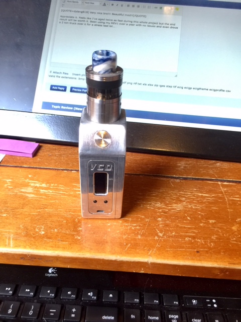

Appreciate it. Feels like I've aged twice as fast during this whole project but the end result will be worth it. Been using my REV1 over a year with no issues and even drove a 2 ton truck over it for a stress test lol... Have since gone and rough sanded up to 1000 grit from 400 due to the pavement scratches but it took the beating like a champ. Obvious major changes since this rev1 (delrin buttons, soft tact fire switch only being used internally now with external flush actuator, and the logo, and of course the minor change in plating Sa

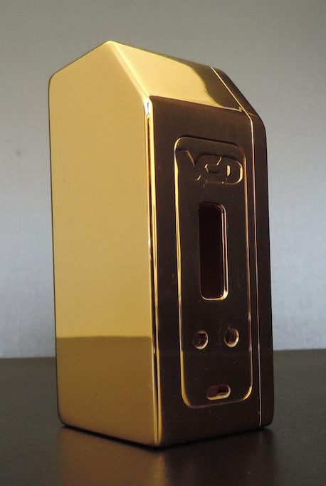

Will have custom actuator flush along with same copper, nickel, show chrome (think motor cycle wheel show chrome), and heavy 24K. All milled from 7075 Aluminum. No epoxy. Custom faceplate pressure fit with backplate held by 0x80 (4) screws threaded to faceplate through delrin backing plate. Lid has milled groove with 4mm of compression via o-rings. Using FDV V3 LP (ceramic core) which is SS and will be 24k plated as well. Been a 8 month project with 50 units going out. Days away from being sent to gold plating from the chrome. Using 3S 11.1V 65C 1550mAh Lipo with its own milled cavity. It's a big f'er.

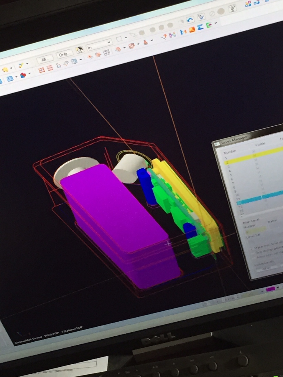

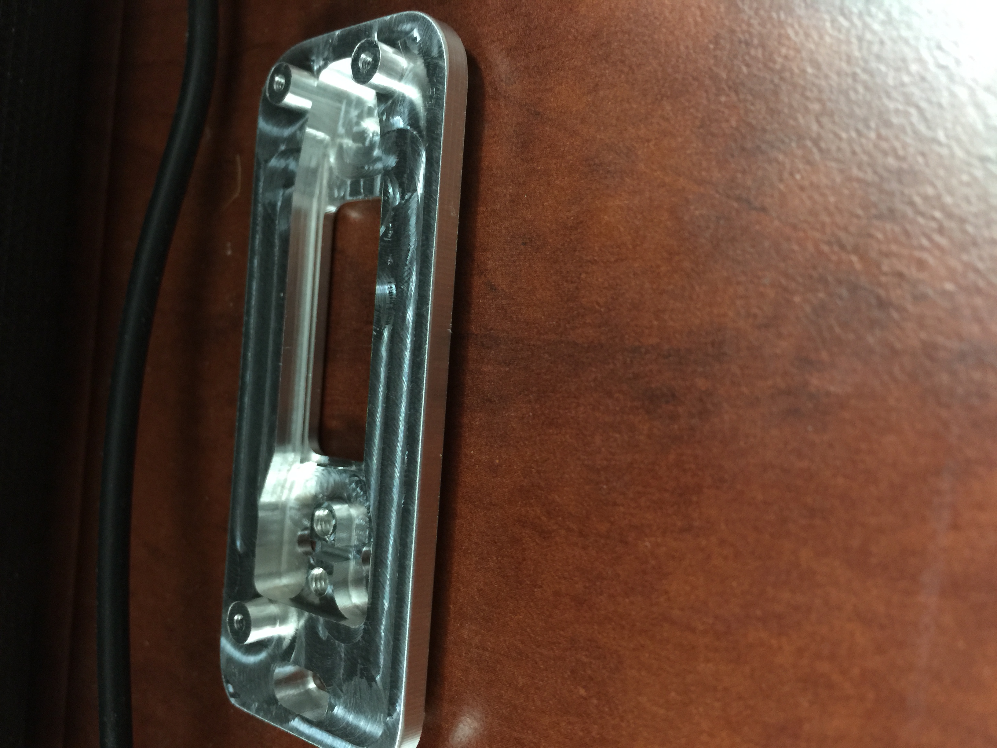

Been working on my own DNA200 design from the ground up and with the help of a very gifted machinist and of course all I've learned from these forums, here is my faceplate design to be pressure fit with 4mm of compression via o-rings. Thoughts or suggestions definitely welcome!
