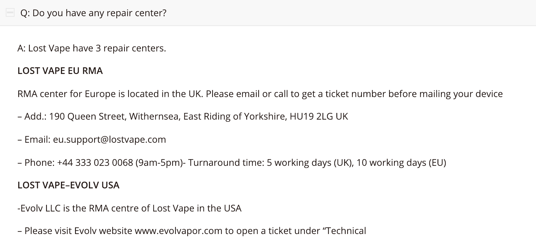

Man, if that was mine and still in warranty, I'd really hit up the place of purchase, or VA themselves. Especially for these high dollar mods, because while Evolv is only responsible for the board, even if they ask to send in the mod, you should read if there's any fine print for disclaimers. After saying that, I've never had any issues.
