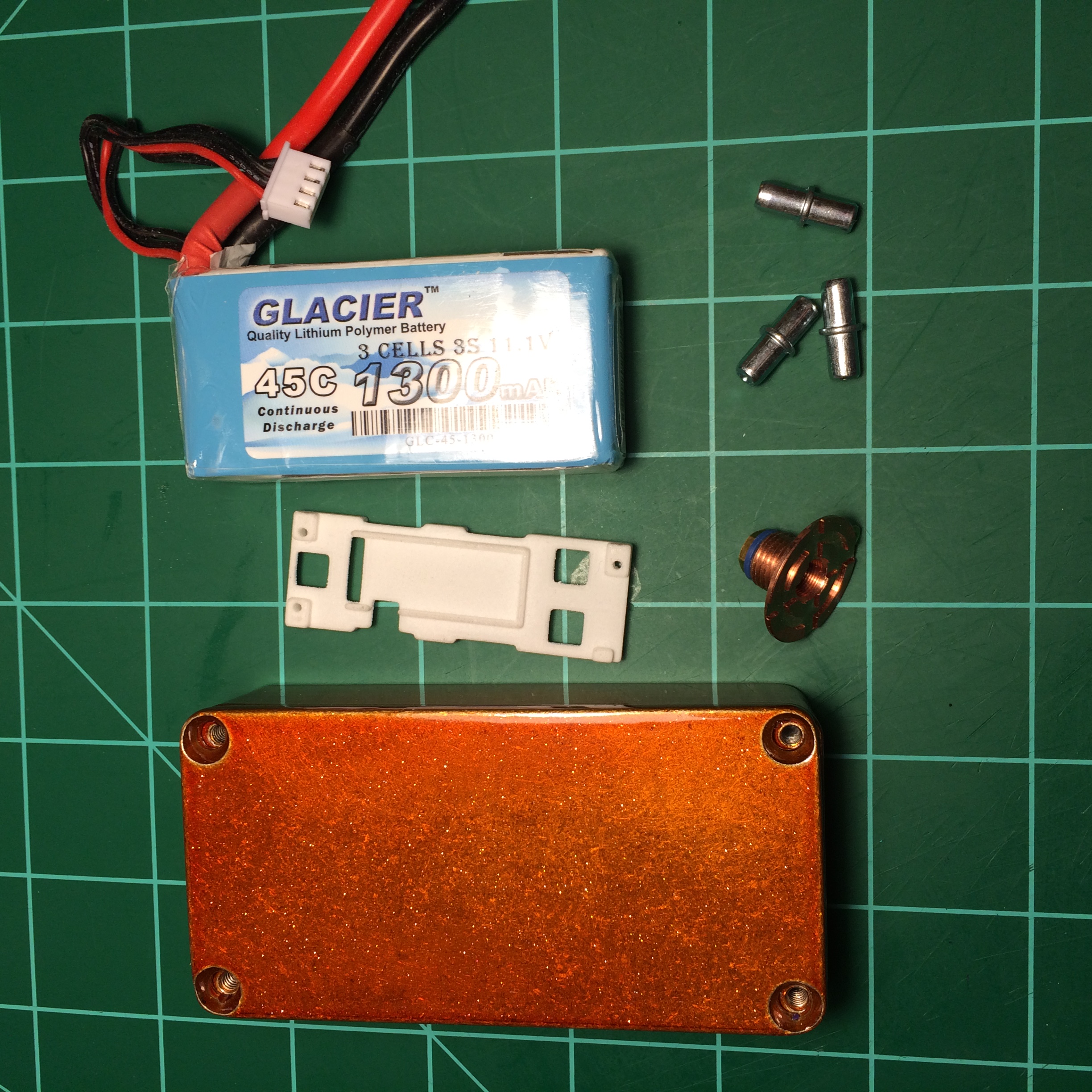

djvanlandingham Posted January 4, 2016 Report Posted January 4, 2016 Gathering parts and getting ready to build my 200! I got the fever!! Box 1590g http://www.mammothelectronics.com/default.aspLipo http://www.buddyrc.com/glacier-45c-1300mah-3s-11-1v-lipo-battery.html510 http://www.fatdaddyvapes.com/shop.htmlChip sled https://www.shapeways.com/product/X2X2U9ZAK/dna200-mounting-plate?li=shop-results&optionId=57699387Buttons http://www.amazon.com/gp/product/B003QSEERI?psc=1&redirect=true&ref_=oh_aui_detailpage_o05_s01 Now I just need to order my board and do some test fitting! I ordered a Turnigy 950 Lipo just in case the 1300 don't fit cuz it's tight!

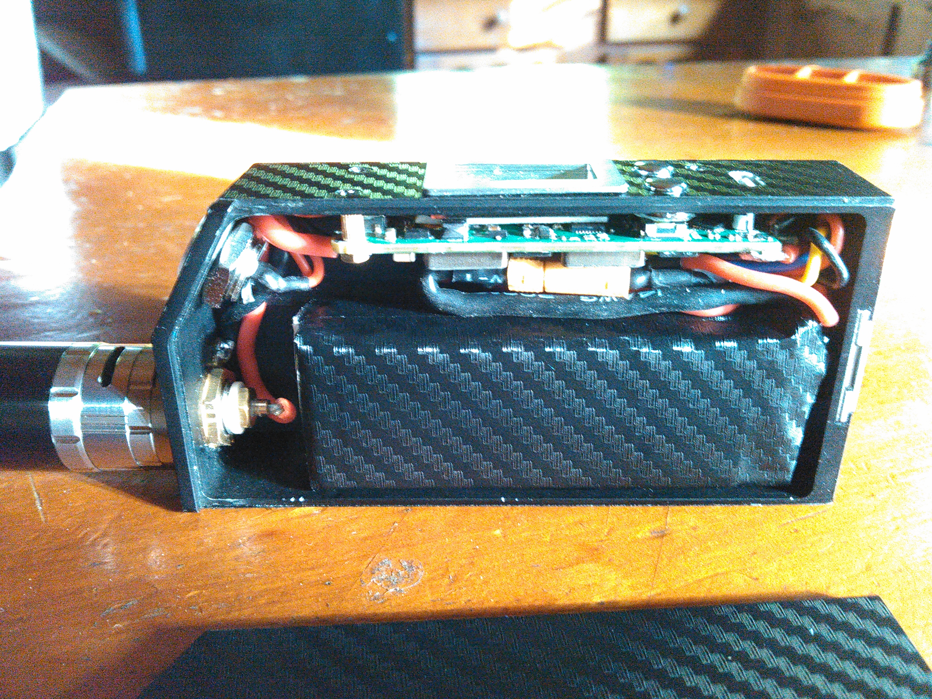

Nykademos Posted January 7, 2016 Report Posted January 7, 2016 It was James Dean, but when i went to cf wrap and put better up/down buttons, i shorted the chip. I've decided that hard-wiring batteries is a no-no. I'm now using the venom 1300 35c (85*30*19.5mm) in this mod and in my copper 1590g, perfect fit for both and a better battery than those squishy turnigys, wrapped the battery to match the mod and have an extra sliding lid that you can change out.
Plangco Posted January 7, 2016 Report Posted January 7, 2016 djvanlandingham said:Gathering parts and getting ready to build my 200! I got the fever!! Box 1590g http://www.mammothelectronics.com/default.aspLipo http://www.buddyrc.com/glacier-45c-1300mah-3s-11-1v-lipo-battery.html510 http://www.fatdaddyvapes.com/shop.htmlChip sled https://www.shapeways.com/product/X2X2U9ZAK/dna200-mounting-plate?li=shop-results&optionId=57699387Buttons http://www.amazon.com/gp/product/B003QSEERI?psc=1&redirect=true&ref_=oh_aui_detailpage_o05_s01 Now I just need to order my board and do some test fitting! I ordered a Turnigy 950 Lipo just in case the 1300 don't fit cuz it's tight! Can you get the exact measurement in mm of the battery? I will be ordering the same one and need to know if it's any bigger then listed.
VapingBad Posted January 7, 2016 Report Posted January 7, 2016 The community spreadsheet includes real battery dimensions it would be great if you have ran the analyser to add these, it also has many categories of resources.https://forum.evolvapor.com/topic/65816-topic/
djvanlandingham Posted January 9, 2016 Report Posted January 9, 2016 I don't have calipers so it's unscientific but i came up with (in mm) A=73 B=34 C=20. The websitehttp://www.buddyrc.com/glacier-45c-1300mah-3s-11-1v-lipo-battery.htmllist the size as A=70 B=33 C=20. I read somewhere on a RC forum that the Glacier battery's were very reliable. I googled it and found the site above and saw that it was one of the smallest 1300 so i thought i would give it a shot in a 1590g case.
Plangco Posted January 9, 2016 Report Posted January 9, 2016 Thanks for the measurements. On another website it listed it as 70x33x26, which is to tall to fit.
