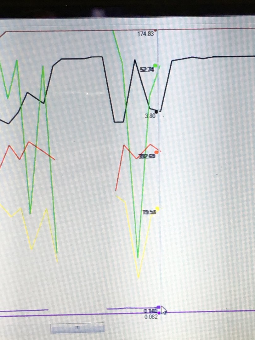

Frogmod Posted August 7, 2016 Report Posted August 7, 2016 There also no amp reading on the DNA 60 screen but it shows that it's charging (I installed drained batts) on the device monitor. Plus how hot can I get the DNA 60 chip? 174.83F on the chip and thats inside the house I hate to see what it might be when its 90F outside. I don't think it likes my .08 TI build
