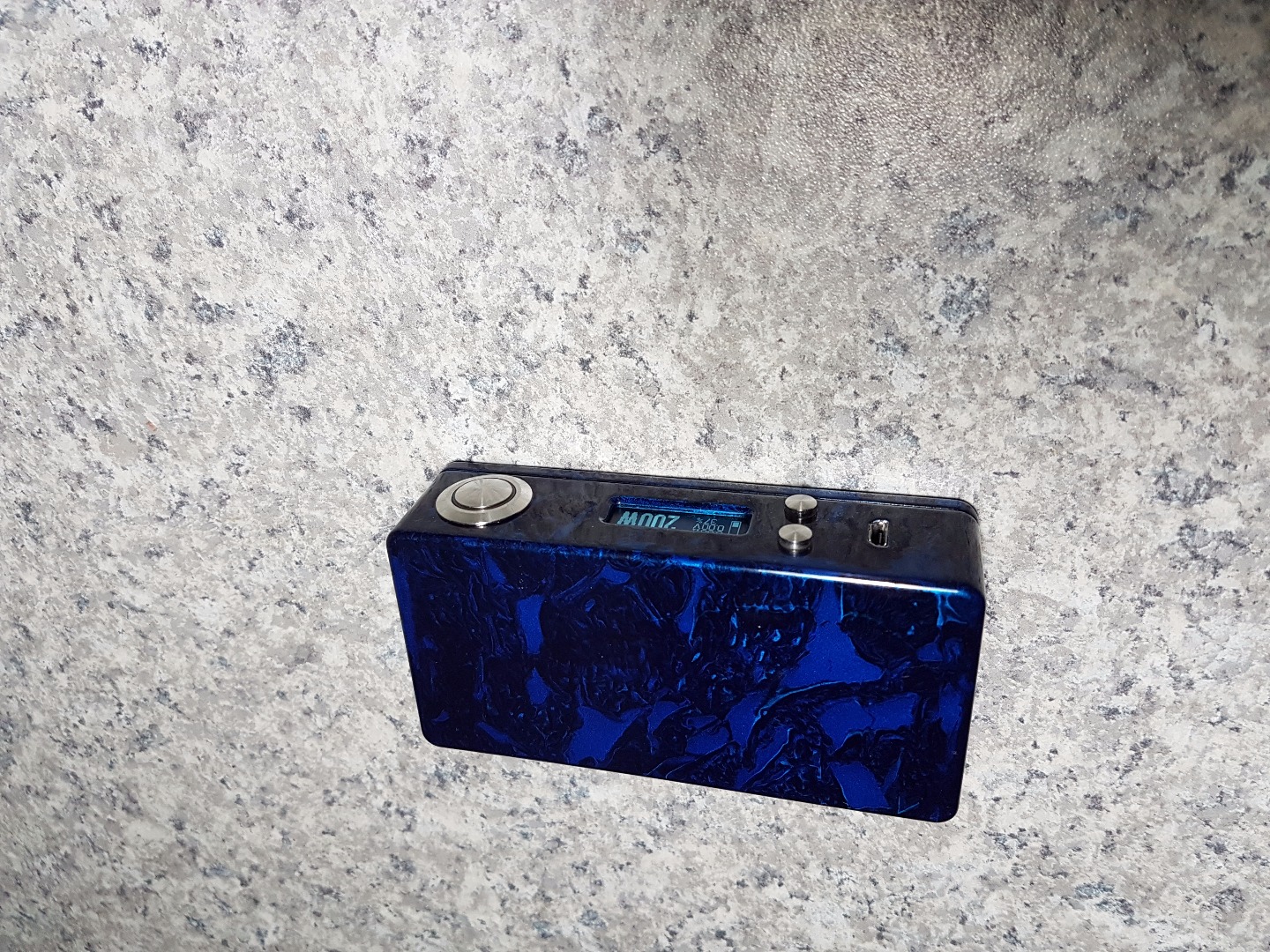

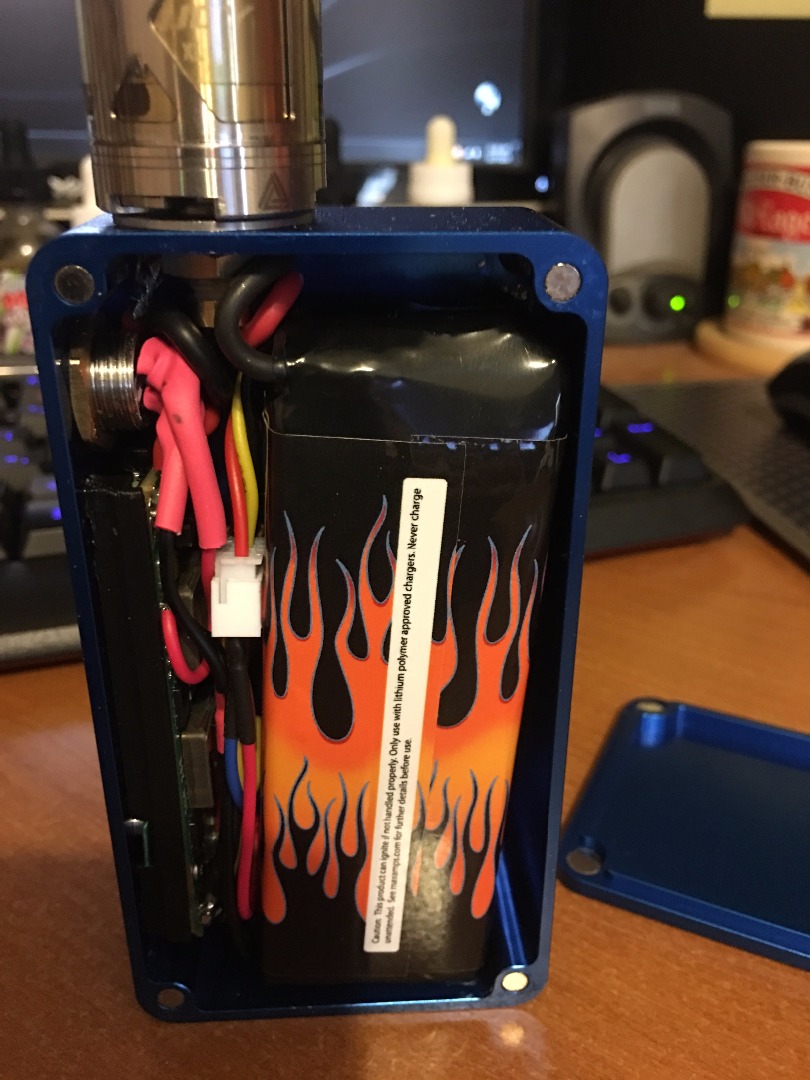

John la Posted October 27, 2016 Report Posted October 27, 2016 I have not finished this box yet think I'm going to go with a blue kandy maybe a red kandy green is really nice too. Thought I'd share this halfway done pic make someone a little jealous so pulled the board from a hcigar vt200 (fire button was going) put it in a g box with 16mm led switch, v2 varitube, and drilled out the + - and used the hcigar buttons, 1300 lipo led switch takes up alot of room maybe a mitech switch next time. Next once the box comes in will be a dna 250 in the gbox. Ps dna 75 in the p box is the other mod in the pic.

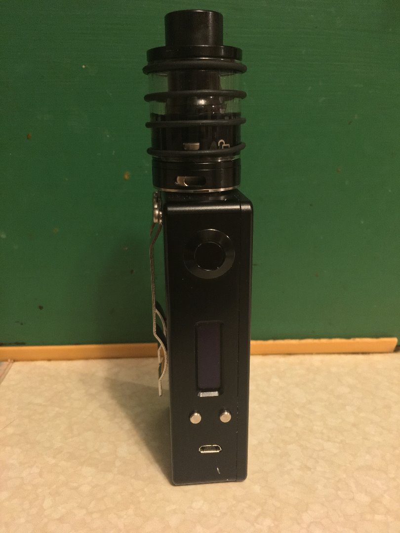

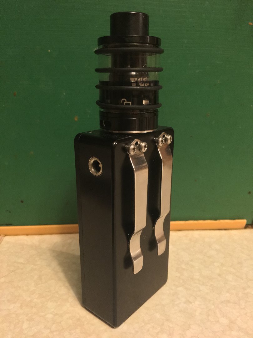

Frogmod Posted October 31, 2016 Report Posted October 31, 2016 I decided to update my 200 by adding some knife clips and a fast 5A charging port. (like on my 1590B) the battery can handle a 5C charge so I'm safe there. charge time takes 20mins from the weak battery display. this add-on mod is so worth it on a vemon 1300Mah battery.
Rob_H Posted November 1, 2016 Report Posted November 1, 2016 Frogmod said:I decided to update my 200 by adding some knife clips and a fast 5A charging port. (like on my 1590B) the battery can handle a 5C charge so I'm safe there. charge time takes 20mins from the weak battery display. this add-on mod is so worth it on a vemon 1300Mah battery. So how did you wire inside the device to run a 5amp charger. Are you still plugging into the stock location or did you run a remote usb.edit: I see the plug now in the first image.

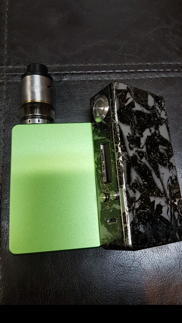

John la Posted November 2, 2016 Report Posted November 2, 2016 Here it is...... so much prettier in person
Frogmod Posted November 5, 2016 Report Posted November 5, 2016 Rob_H said:So how did you wire inside the device to run a 5amp charger. Are you still plugging into the stock location or did you run a remote usb.edit: I see the plug now in the first image.https://forum.evolvapor.com/topic/66841-topic/?do=findComment&comment=901299 this will show you how I connected it up. its the same set up as the 1590 G+

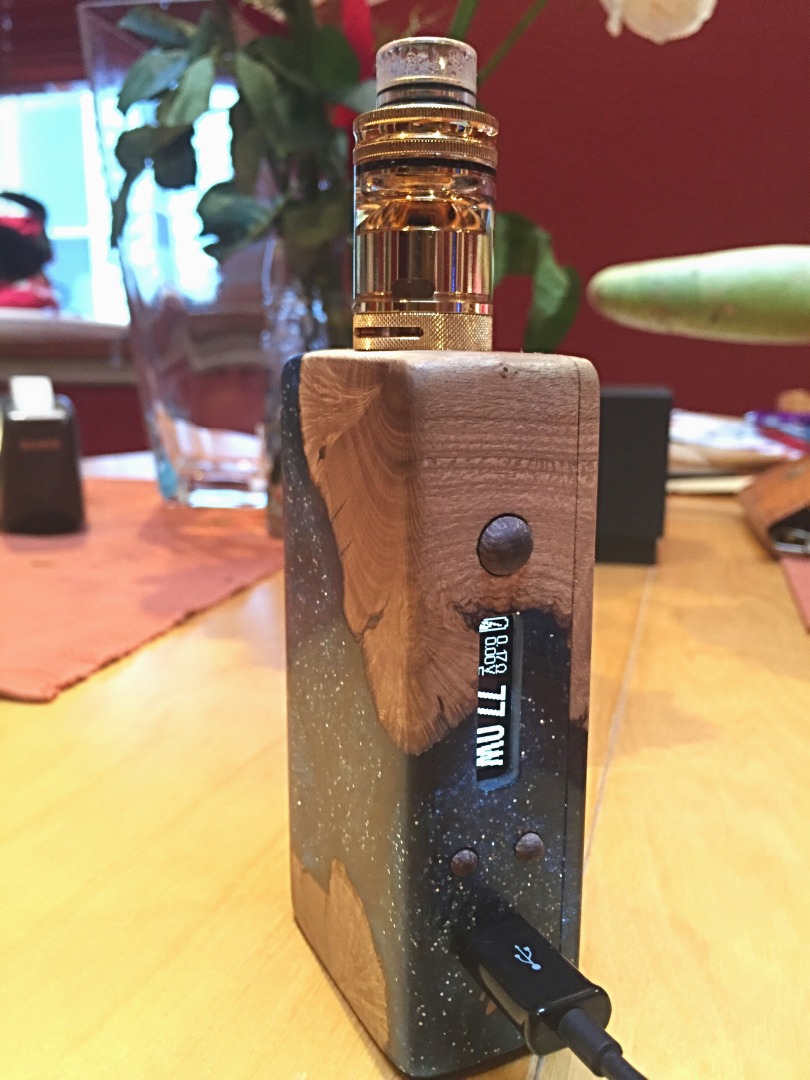

PreciseCreation Posted November 7, 2016 Report Posted November 7, 2016 Been working on this one for the last month or so. Between the design time/revision process was about 2-3weeks than another week of finishing the wood and the actual build Compound DNA mixed materials with walnut, stabilized maple burl, 3d printed internal board mount, and stainless steel hardware.

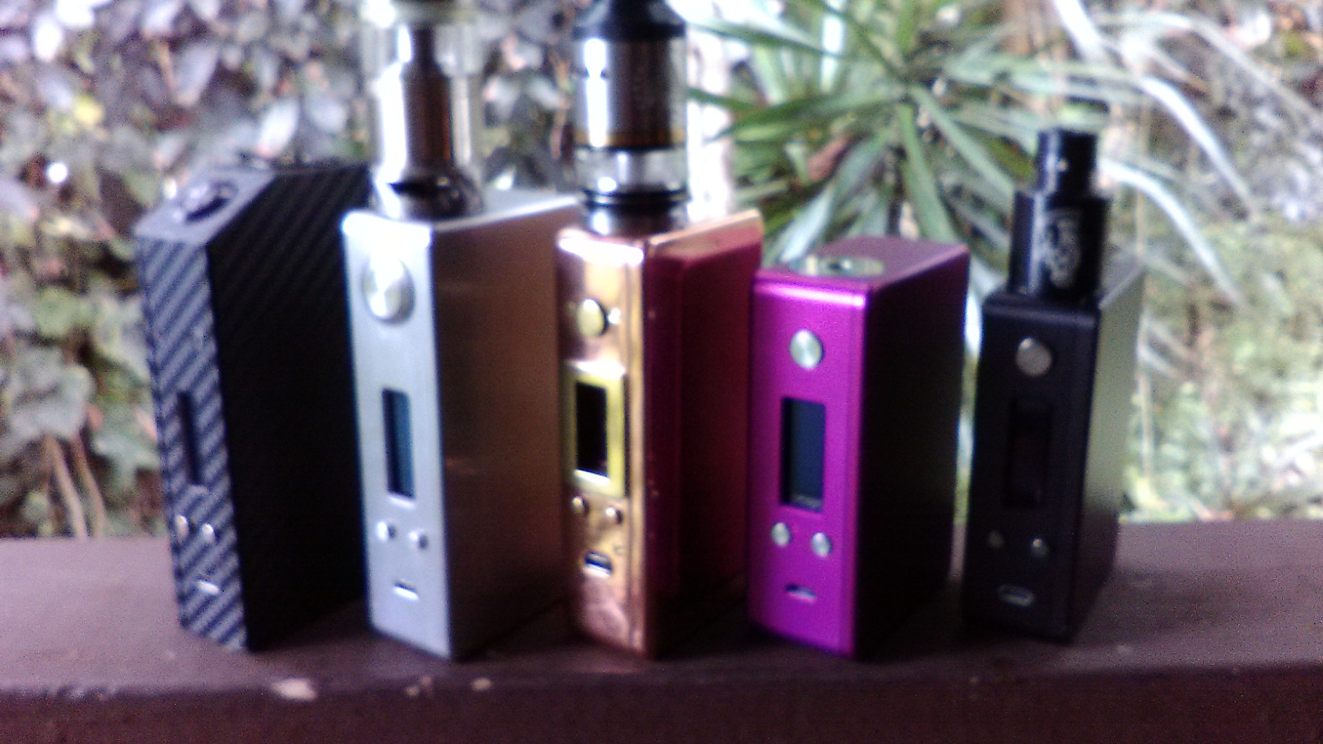

Nykademos Posted February 25, 2017 Report Posted February 25, 2017 UKDTweak said:Moonshot... on the Moonshot mod... I have eyed my moonshot box 100 times thinking of this, but with a maxamps 1800. Very nice sir! Here are some of my babies,
UKDTweak Posted February 27, 2017 Report Posted February 27, 2017 Nice collection there Nykademos Ive since tried to hide some of my bad cutting and the wires with a wee cover and Faux carbon wrap.And here my overall DNA collection, from DNA40, 75, 133, 200 and 250w, all the DNA40 were home made (4 on the left) as were some of the bigger mods.

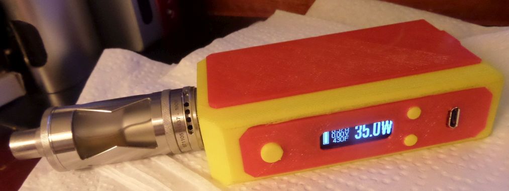

dwcraig1 Posted March 1, 2017 Report Posted March 1, 2017 Against my better judgment I will post this, my friend bought a 3D printer and made this box for me. So I built it. 1
Wayneo Posted March 1, 2017 Report Posted March 1, 2017 @dwcraig1 What material did you use to print it? I'd rock that color scheme.
