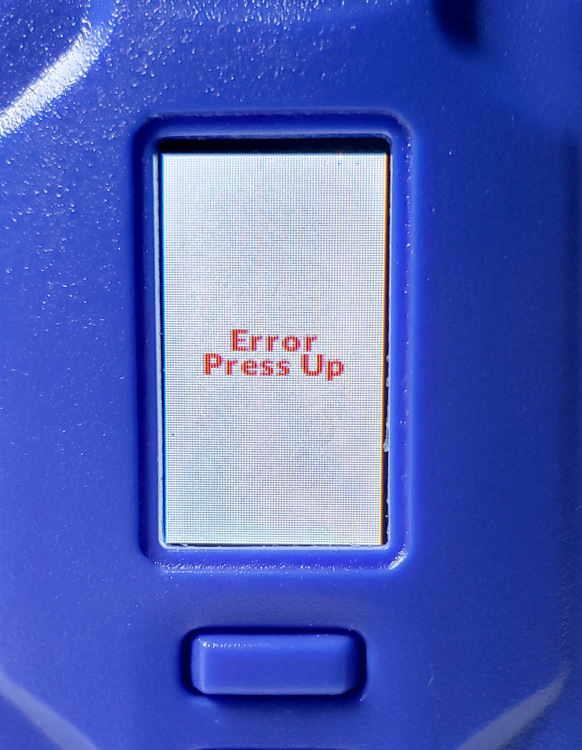

vaperneto Posted November 30, 2018 Report Posted November 30, 2018 SP19 INT, Lost Vape Triade 250c, Error Press Up still happening

AMDtrucking Posted December 11, 2018 Report Posted December 11, 2018 (edited) On 12/3/2018 at 9:56 AM, James said: When does Error Press Up happen for you on SP38? Is it after it has slept for a while, during firing, or..? Thanks! Sorry to barge in on your conversation, but I too started getting ERROR PRESS UP. It happens almost every day after DNA250C has been sleeping for a while, I press FIRE button and see this error message. It doesn't bother me too much, because it resumes working properly, just as soon as I press the UP button. Mod: Vape Cige VTX200W, brand-new. I just loaded the latest service pack. Edited December 11, 2018 by AMDtrucking
James Posted December 11, 2018 Report Posted December 11, 2018 On SP38? What theme are you running, out of curiosity? Could you message me your .ecig settings? Thanks!

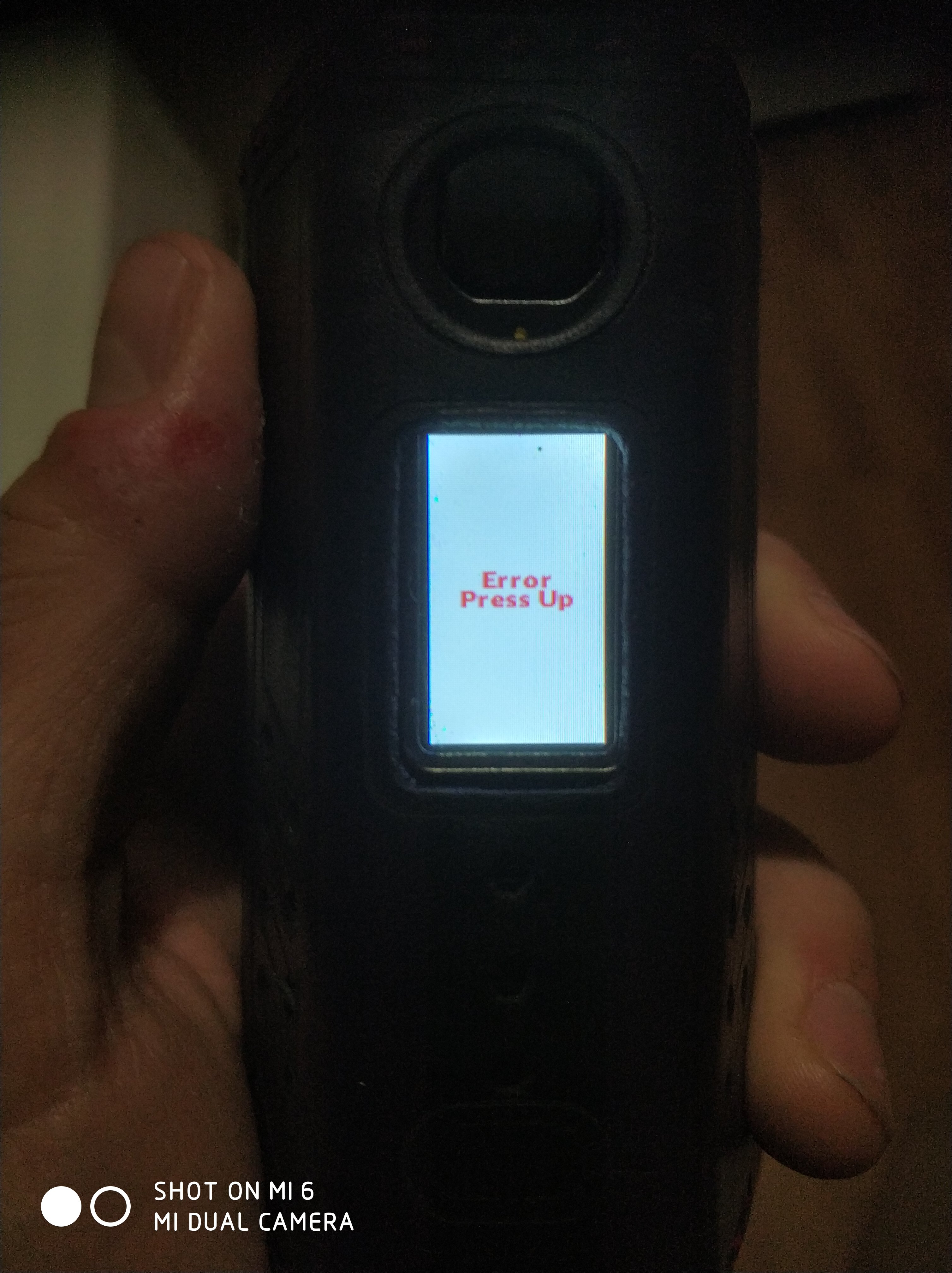

Lord Zog Posted December 11, 2018 Report Posted December 11, 2018 (edited) 3 hours ago, James said: On SP38? What theme are you running, out of curiosity? Could you message me your .ecig settings? Thanks! Hi James. I registered a forum account just to post in this thread. My Lost Vape Triade 250C is doing this also and has been since I got it in August. Seems to show the screen above after sleeping when I try to fire after some time. Pressing up clears and no other issues pop up . This issue happens sometimes once a day to once a week. I have attached my .ecig file the day I got the device and hooked it up to my PC as well as the latest .ecig from today using EScribe SP19 and firmware SP38 since I can't remember the firmware that came with the device and not sure if the files are different or not between the service packs. I am also using the default theme. Only problem I've had since purchase, love the new DNA 250C board! Traide250C - Dec 11 2018.ecig Triade250C - Aug 29 1018.ecig Edited December 11, 2018 by Lord Zog
AMDtrucking Posted December 11, 2018 Report Posted December 11, 2018 13 hours ago, James said: On SP38? What theme are you running, out of curiosity? Could you message me your .ecig settings? Thanks! Here it is... VTX200.ecig
AMDtrucking Posted December 12, 2018 Report Posted December 12, 2018 (edited) I don't know if it matters, but three of my other DNA250C boards, have Version 1.1 SP35 INT. Only this one, with the "Error Press UP" problem, had Version 1.1 SP35 US, loaded in it. I changed the Service Pack, on it, to the international version, hoping it might help. I know at least one more person with the same problem on his DNA250C. He is in Russia. If we could get to the bottom of this, I will try to help him too. I speak Russian. P. S: When I was finishing reloading international Service Pack 35, the "Error Press UP" popped up on the screen again. I guess, it didn't help. Edited December 12, 2018 by AMDtrucking
rozenkreuser Posted December 12, 2018 Report Posted December 12, 2018 Hi, I also have the same problem with my triade 250c. My device is running the latest firmware (int sp38).
Lord Zog Posted December 12, 2018 Report Posted December 12, 2018 7 hours ago, AMDtrucking said: I don't know if it matters, but three of my other DNA250C boards, have Version 1.1 SP35 INT. Only this one, with the "Error Press UP" problem, had Version 1.1 SP35 US, loaded in it. I changed the Service Pack, on it, to the international version, hoping it might help. I know at least one more person with the same problem on his DNA250C. He is in Russia. If we could get to the bottom of this, I will try to help him too. I speak Russian. P. S: When I was finishing reloading international Service Pack 35, the "Error Press UP" popped up on the screen again. I guess, it didn't help. This happens to me on INT firm also, I have tested both thinking the same thing.. It came with INT and I tested with US and got the same thing so put INT back when SP38 launched.

AMDtrucking Posted December 17, 2018 Report Posted December 17, 2018 (edited) On 12/12/2018 at 3:15 AM, Lord Zog said: This happens to me on INT firm also, I have tested both thinking the same thing.. It came with INT and I tested with US and got the same thing so put INT back when SP38 launched. One more observation: This error occurs quickly when the board cools down. It took me 5 minutes, to replicate this error, just by placing my mod in refrigerator. Edited December 17, 2018 by AMDtrucking
