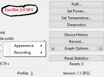

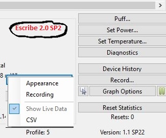

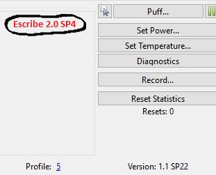

giz_60 Posted July 14, 2017 Report Posted July 14, 2017 (edited) On 7/12/2017 at 7:09 PM, James said: I've posted EScribe Suite 2.0 SP4 as an early version. It includes SP22 for DNA 75 Color, which resolves a few issues mainly seen with Stainless Steel coils. A lot of low-level rework has been required to support the upcoming Mac version, so definitely let me know if this version acts quirky in any way. Enjoy, James Have noticed that in DM, the 'Graph Options' has disappeared in the SP4 update. Have the abilities to set the graph timescale under the 'Appearance' tab & take a .csv snapshot (which disappeared in SP3) been moved somewhere else? Edited July 14, 2017 by giz_60 1
James Posted July 14, 2017 Report Posted July 14, 2017 We had to have a menu for the Mac version (folks expect Quit Device Monitor to be an option for the program menu, instead of clicking X like on Windows), so I decided to move a number of options up there. CSVs have been moved to the Recording menu. Time scale has been moved to the View menu. 1
giz_60 Posted July 14, 2017 Report Posted July 14, 2017 51 minutes ago, James said: We had to have a menu for the Mac version (folks expect Quit Device Monitor to be an option for the program menu, instead of clicking X like on Windows), so I decided to move a number of options up there. CSVs have been moved to the Recording menu. Time scale has been moved to the View menu. Found em....Thanks!! 2
