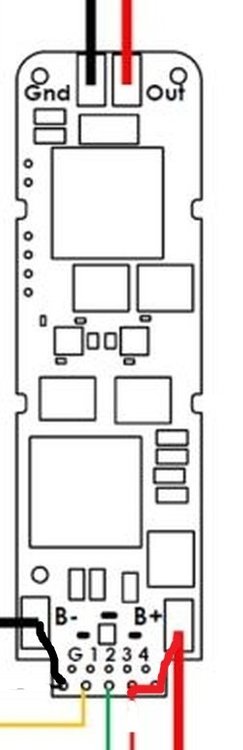

Some images show the board with the rails removed, here is an image with rails. Pay no attention to wire colors as they are for converting a particular mod to DNA60.

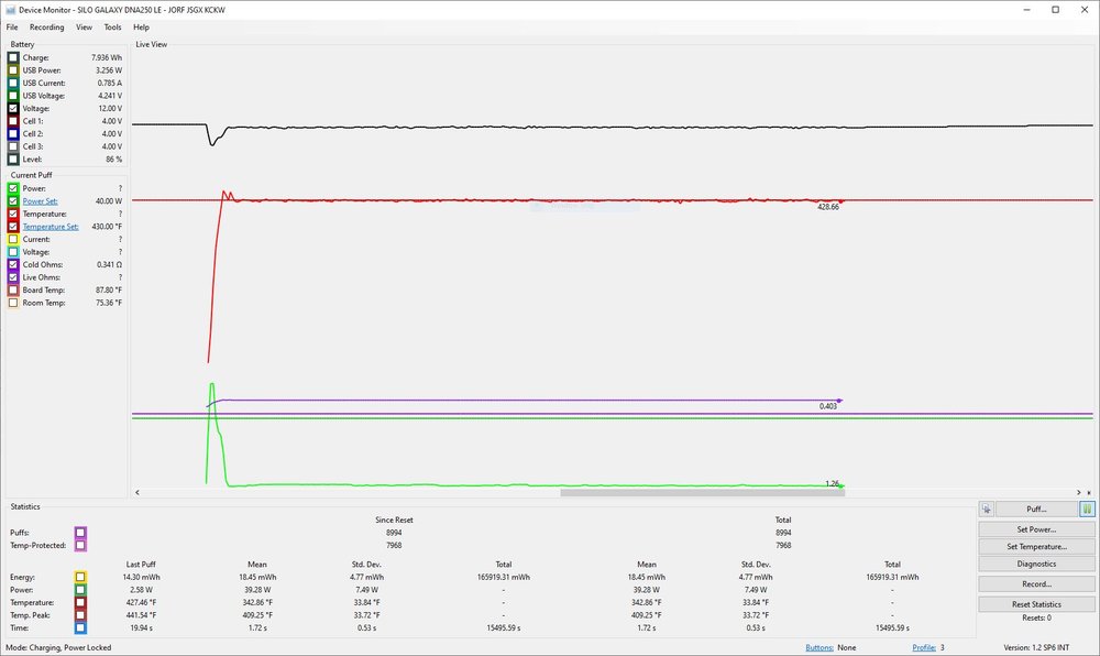

Graph looks good, with use Replay in profile checked you will be able to get a replication of the saved puff. Try heating the wire a little hotter perhaps. But not bright red.

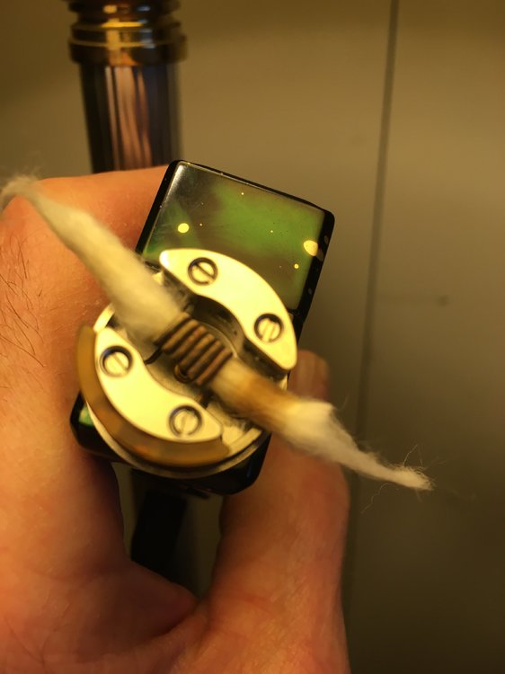

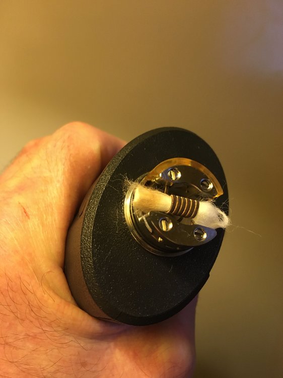

Not actually twisting it makes it stiffer. When I'm done twisting it I heat the length of it to a slight red. I torch all my wire prior to coiling (even Tii). You could use a Bic lighter if necessary but be sure to dry fire with low wattage to burn off the black stuff. Twisted lightly really doesn't describe it, it's twisted pretty tight. This makes the 2 strands equal / near 26 gauge with lots of area for juice contact. This photo is from a couple of years ago, I twist it a bit tighter nowadays.
@RealMcCoy Could you post a snippet firing your coil in wattage mode with battery voltage also checked? In this snippet I have unchecked the "set temperature" box to avoid any confusion. This is wattage with a little boost without using Replay.
The coil used in my post is two strands of 28 gauge SS 430 twisted tightly with a drill and in a Kayfun Lite Plus.
It appears to me that you are trying to get your perfect puff in TC mode, it doesn't look like your getting a satisfactory puff to base Replay on. Try this, set your profile to "Watts" then set your wattage and Boost and upload settings, Keep making adjustments till you get that puff that you feel is right. Use my profile snip as your guide. Then save puff. On my snip the test puff is on the left. look at the live ohms to note duration as it's hard to see as it is flat 20 watts. Use Watt profile. use TC capable wire.
