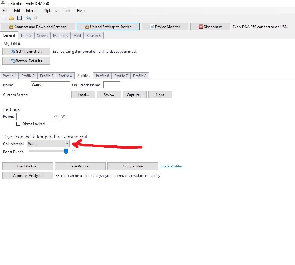

Yes you can simply use the CSV file but you also can manually add it as indicated here: By using the "Action" tab in lower right corner. -

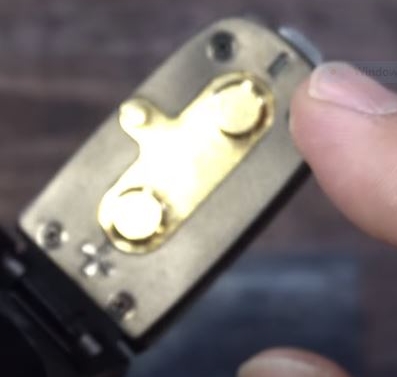

Well are the batteries installed with correct polarity? And does the battery door's little spring loaded pin appear to connect to the brass plate on the battery door. I would suggest connecting to Escribe and use Device monitor to see what is says for the voltage of each cell. Check if it reports one cell is above 4.2 volt and the other is real low,
