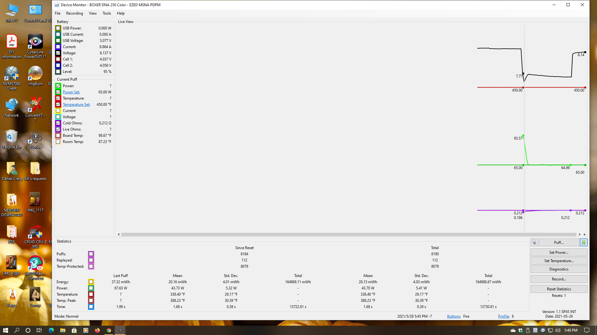

  15. Look at the profile that I posted, that is correct for using Replay with any/all TC wire when not using Replay with Temperature Control at the same time. Your Replay profile should look just like that except for warmth settings and boost

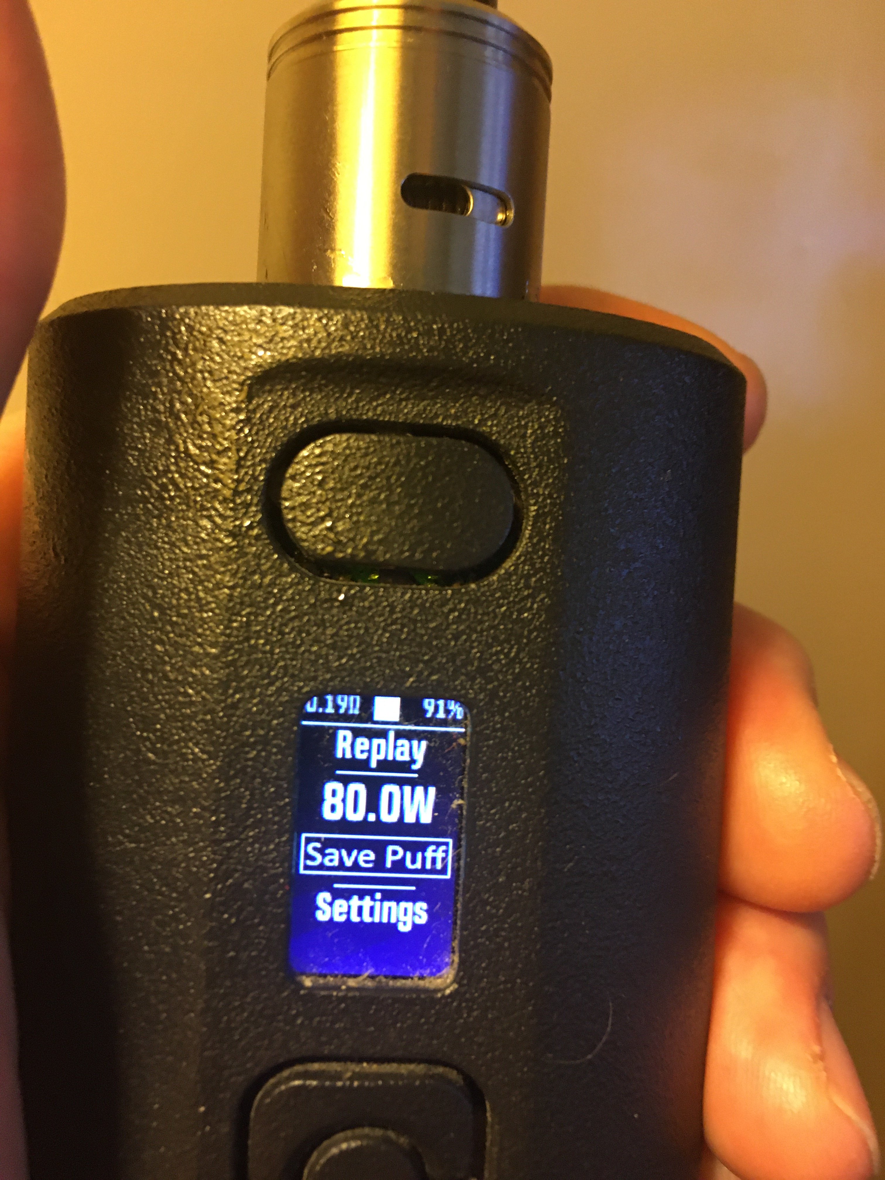

  17. With your theme it will look different. After your puff is it asking to "Save Puff" ?

  19. If you see the resistance change in EScribe and Replay is activated on the profile and theme if needed and Replay still doesn't work then with a cold atty measure the cold resistance and try again.

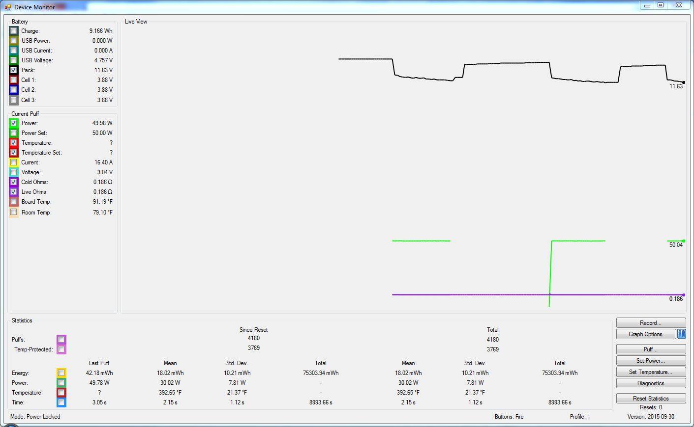

  20. If your coil works in TC then it is most likely TC wire. Use EScribe's Device Monitor to see if the resistance of the coil changes when heated. My example is using SS430 wire which has a greater change than SS316, Replay must 1st be enabled in the profile in EScribe and use TC wire but depending on the theme it may need to be enabled their as well.

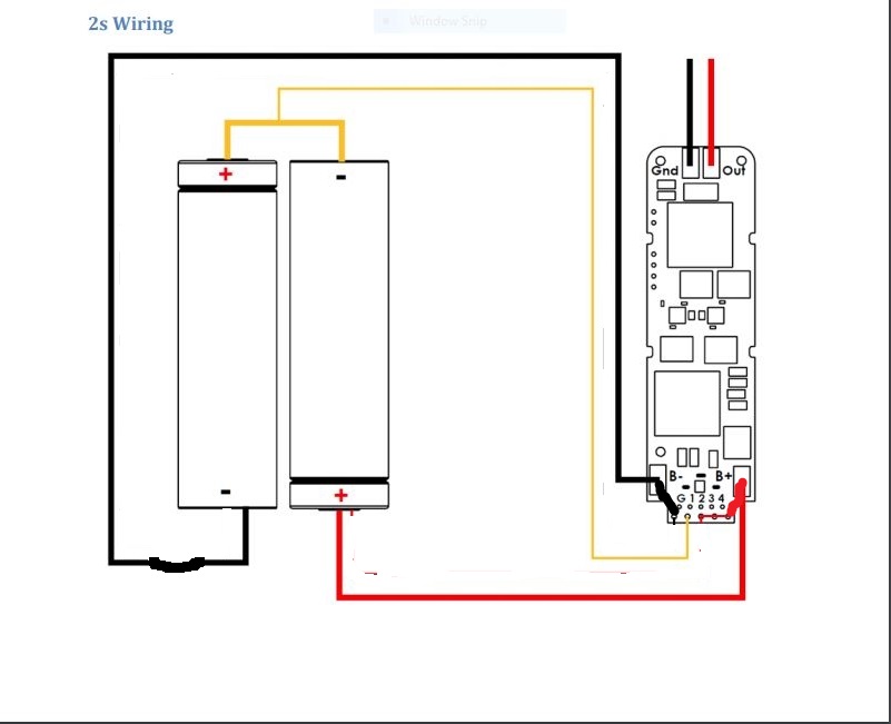

  21. Here is diagram from data sheet and this is how I did mine. I only used the one wire to #1, jumped the rest using small piece of wire or just solder
