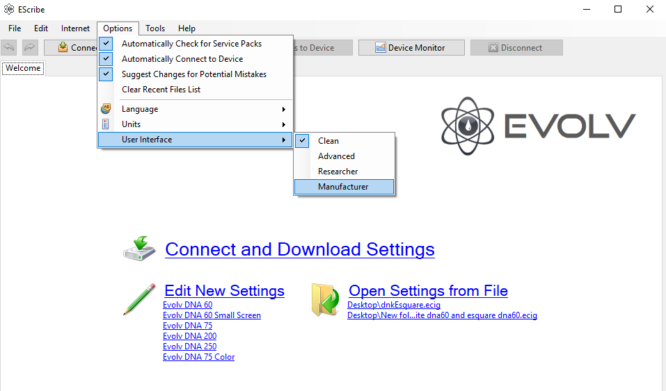

What are the voltage readings for each cell as shown in Device Monitor? What is the "Pack voltage? USB Recovery: Goto Options/User Interface and select Manufacturing, close Escribe and then start it again, then go to Diagnostics:

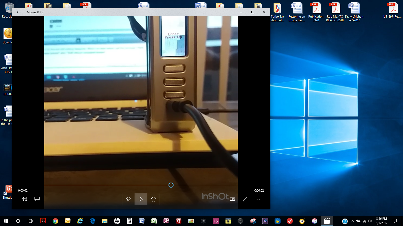

I took a few screenshots of your video.... It starts with black screen then gets white screen (picture 1) then gives an error message (picture 2) then gives theme screen (picture 3) then black screen (picture 4) if this helps James... -
