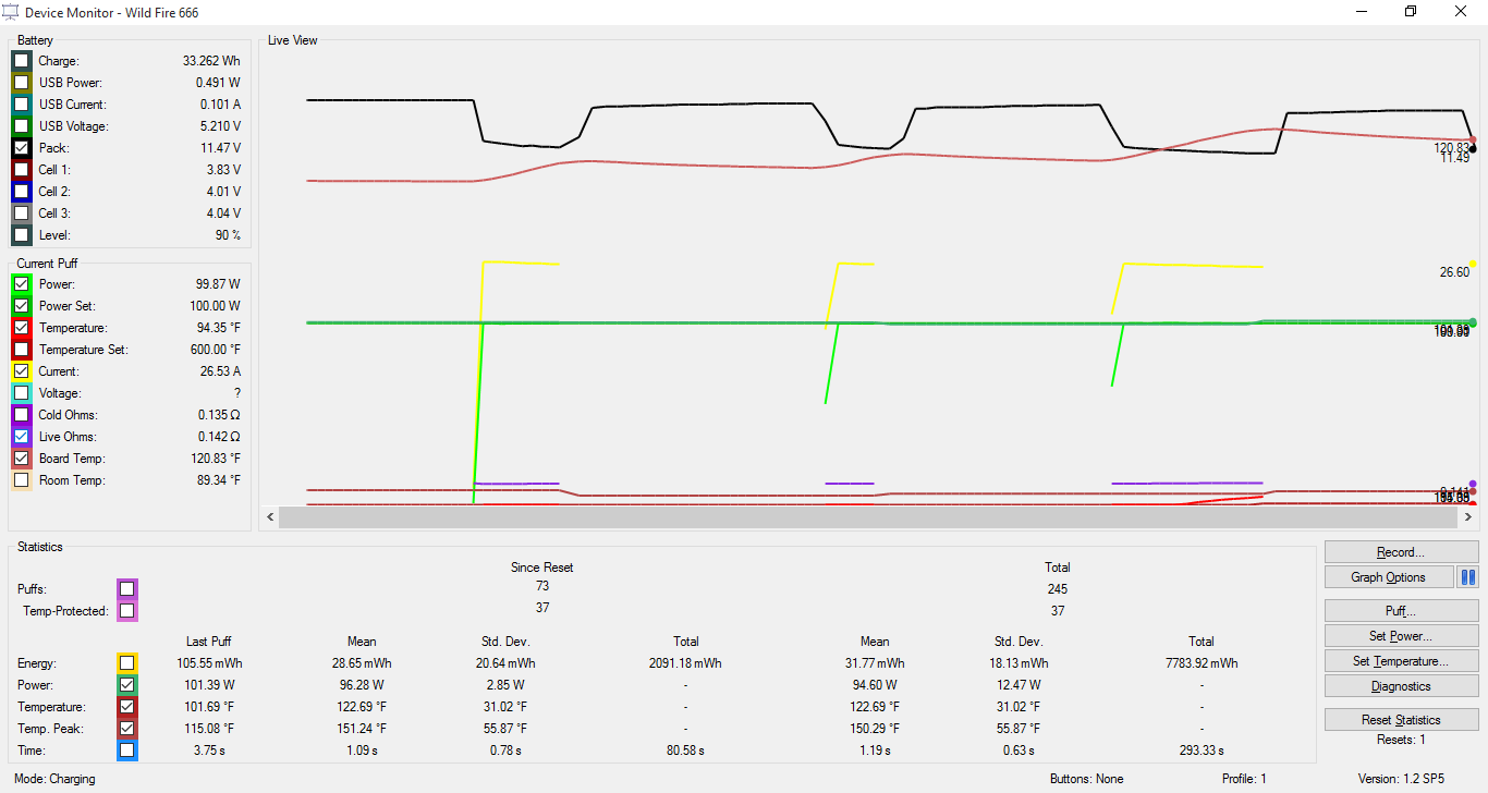

  3. technically there is nothing wrong? sorry for wasting your time. i think i got it if what WAYNEO said that is normal to drop down up to 63.4w the moment i fire it then goes back to 100w while it is still firing.
  4. it goes like that. screen display (100w) not fired. fires it changes to (63.4w) then jumps back to (100w) while firing the device.
  5. the screen changes from 100w to 63.4w every time i fire it.
  6. because every time i fire it it changes from 100w to 63.4 (while firing) the mod. 63.4w is displayed on the screen of the device.
  7. I am new to DNA thing, i have a Triade DNA250 so im still using the wattage mode. i am currently setting it at 100w with Triad RDA alien coil build reading at 0.13ohms but the problem is everytime i fire it it shows that its actual wattage is 63.4 instead of 100w. is there a problem? what do i need to do to address this.
