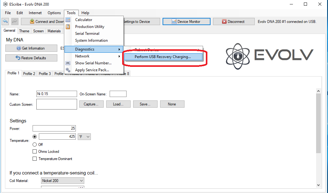

You received your new device with batteries that drained down too low. You can try to do a USB Recovery Charge to see if they will recharge. This takes a long time and you may need to do it more than once. It may not recharge however and the 3 cell battery will need to be replaced... If this is a new device you may want to see about getting it replaced by your vendor.

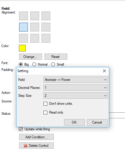

Attached here is the Evolv Default DNA75 Color *.ecig file. Download it to your computer and then click it and see if it will start in EScribe 2.0 (no board or device attached). In DNA75 Color mode then start Theme Designer from there. The 0.2 increment works for me with the 75 Color Theme Designer.... DNA75C Default .ecig file.ecig
I believe you will find that Theme Designer for DNA200 is different than Theme Designer for the 75 Color.. here is a screen from the 75 Color Theme Designer....
You really should have a DNA75 Color board to use the features in Theme Designer for the 75 Color.... when hooked up to a DNA 200 you can't get to this screen (as far as I know)..... I set the increments using a DNA75 color board as seen here and the increments will change by 0.2 watts.
