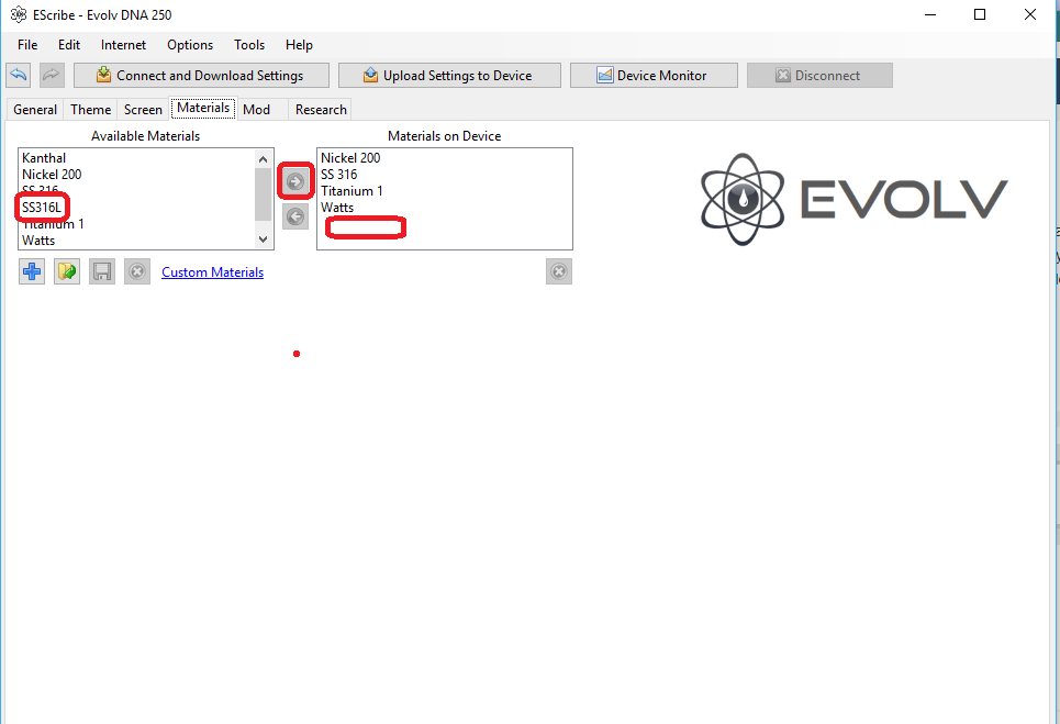

In EScribe you add SS316L to the Material on Device side and upload to the device. Select SS316L as the material when setting the Profile...
