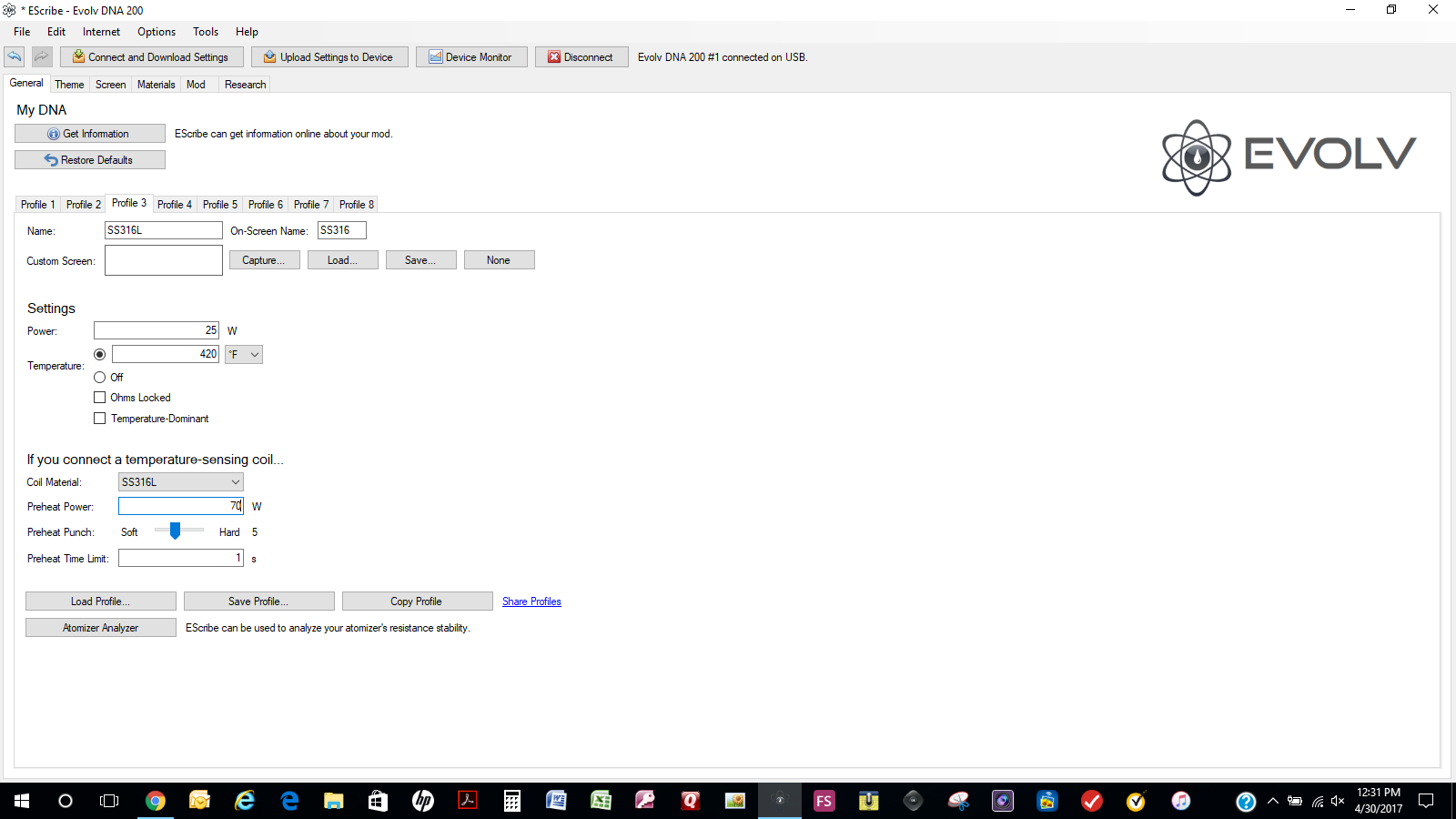

Just set up one of your profiles similar to this and upload it.... You can set the Wattage, Temperature, Preheat, Punch, and Preheat Time Limit to your liking...

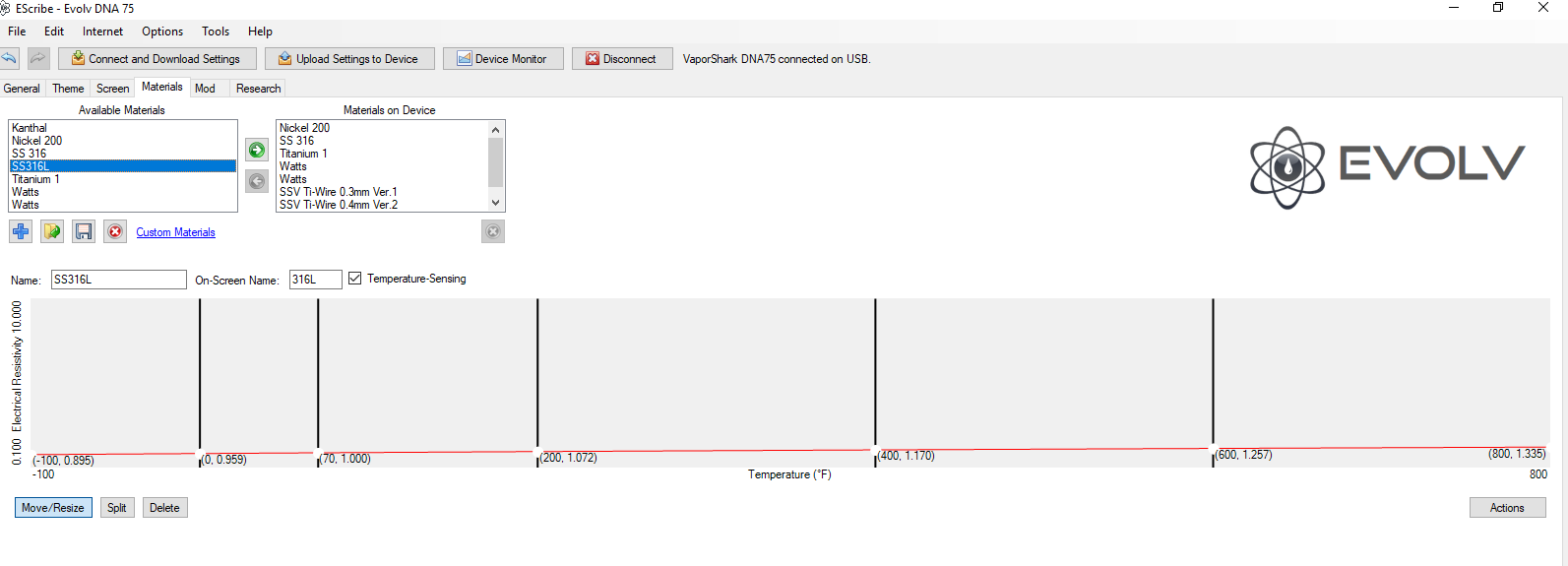

Import this into your Available Materials and then add it from there to the Materials on Device. Then upload to device... Then make your SS316L Profile....and upload SS316L.csv
Can you post a screenshot of the Material tab in EScribe for one of the devices so we can see a list of materials that you have....

giz... I'm backing out as he is confused with more than one trying to help... I think his material SS316L he is using actually is for Ni200... he has 2 materials named SS316L so choose the other one... good luck... -

And I might add..... in Profile 1 the coil material is set to SS316L... check that drop down list and see if there is another SS316L to choose. If so, select it and see if that helps... Your post #4 shows 2 SS316L materials installed on the device... -

You might compare my SS316L material profile to the profile you posted.... they are quite different.... guess you made that profile???? -
