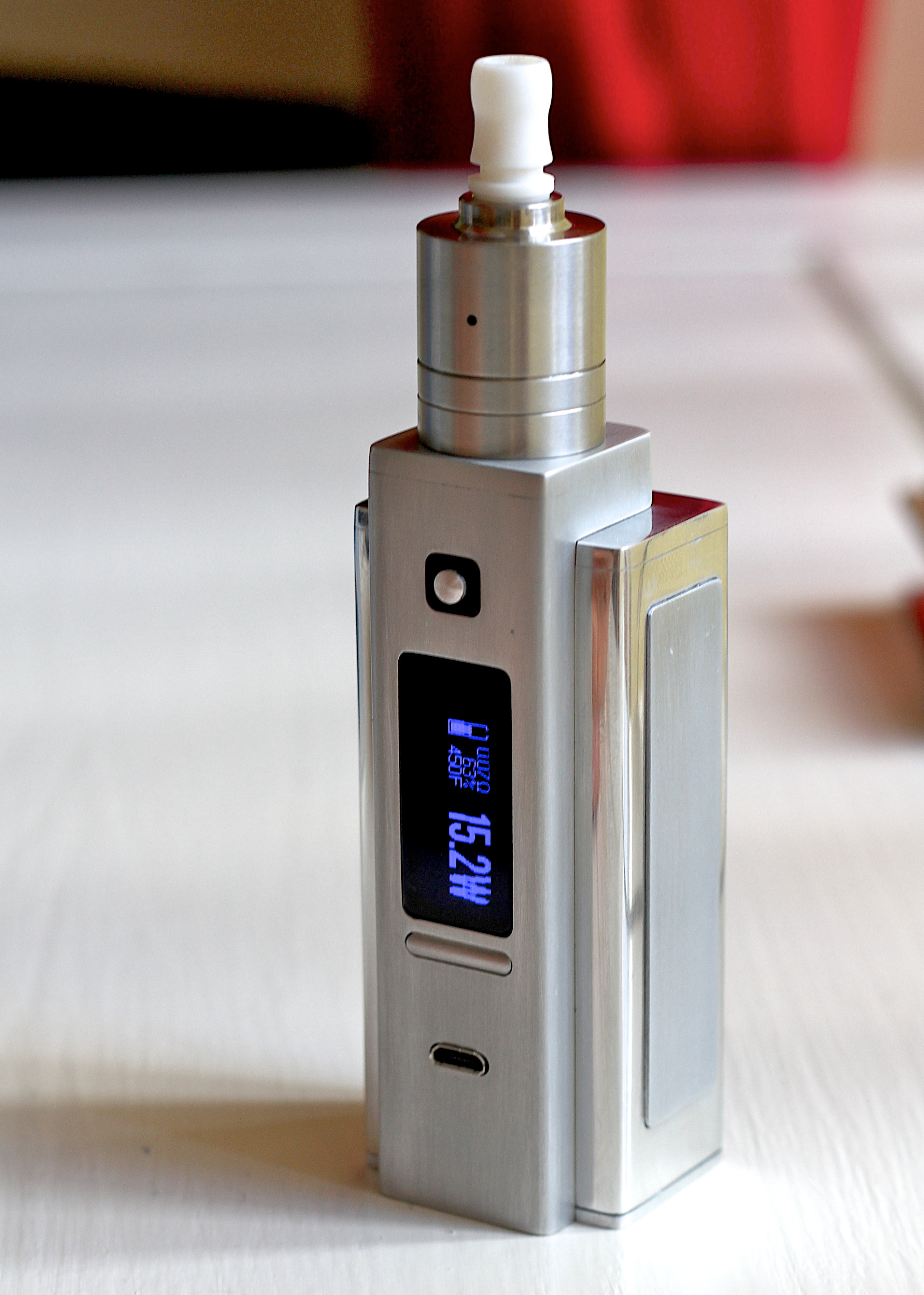

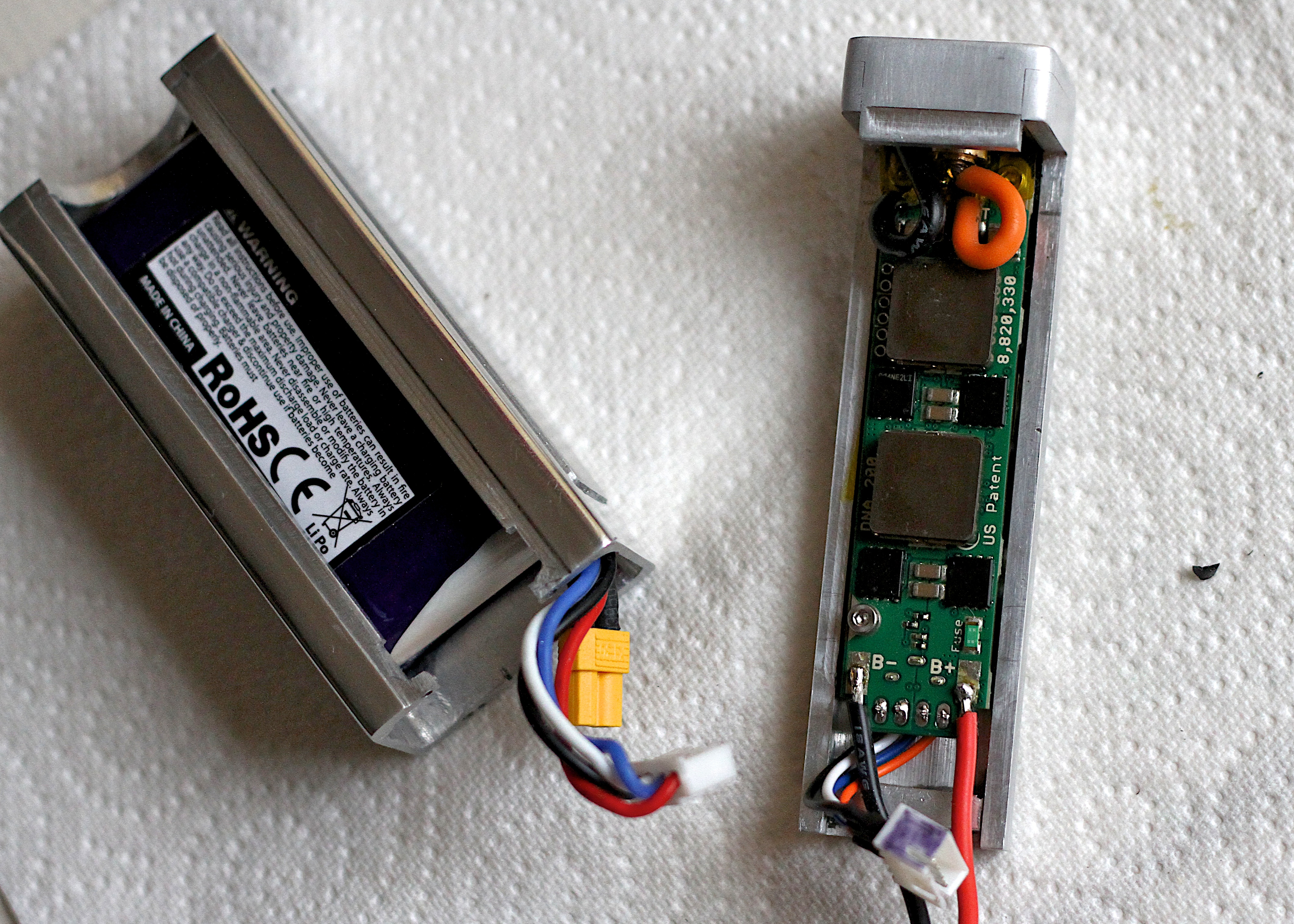

mandro Posted August 15, 2015 Report Posted August 15, 2015 This is my second DNA200 build.It uses a 3s 1000mah nano tech battery. I had to remove the tap connector and wire it directly to the board because it wouldn't quite fit in.
soulseek Posted August 15, 2015 Report Posted August 15, 2015 mandro once again an awesome looking device, probably the best one. Are the parts for the case (and buttons) off the shelf or did you make them yourself? I was hoping to be able to buy them.
mandro Posted August 15, 2015 Report Posted August 15, 2015 soulseek said:mandro once again an awesome looking device, probably the best one. Are the parts for the case (and buttons) off the shelf or did you make them yourself? I was hoping to be able to buy them. Thank you. I made all the parts myself using a micro mill.
blueridgedog Posted August 15, 2015 Report Posted August 15, 2015 Excellent work mandro. The outer battery case looks plated.
turbocad6 Posted August 15, 2015 Report Posted August 15, 2015 mandro, if you don't have enough room for the balancing connector you might be able to fit a pair of the small jst plugs, each one does only 2 wires but if you label them 1 & 2 it works just fine and is much more compact than the big white 4 in a row connector
mandro Posted August 15, 2015 Report Posted August 15, 2015 Thanks blueridgedog, Great idea turbocad, It's wired directly to the board ATM but I will try the JST plugs. The supplied tap connector was only about 2mm too big so I should be fine with the jst's
turbocad6 Posted August 15, 2015 Report Posted August 15, 2015 yeah, I had the same problem, individual jst's solved ithere's a few shots of it wired all up with the 600mah T pack def couldn't fit the big white 4 prong plug

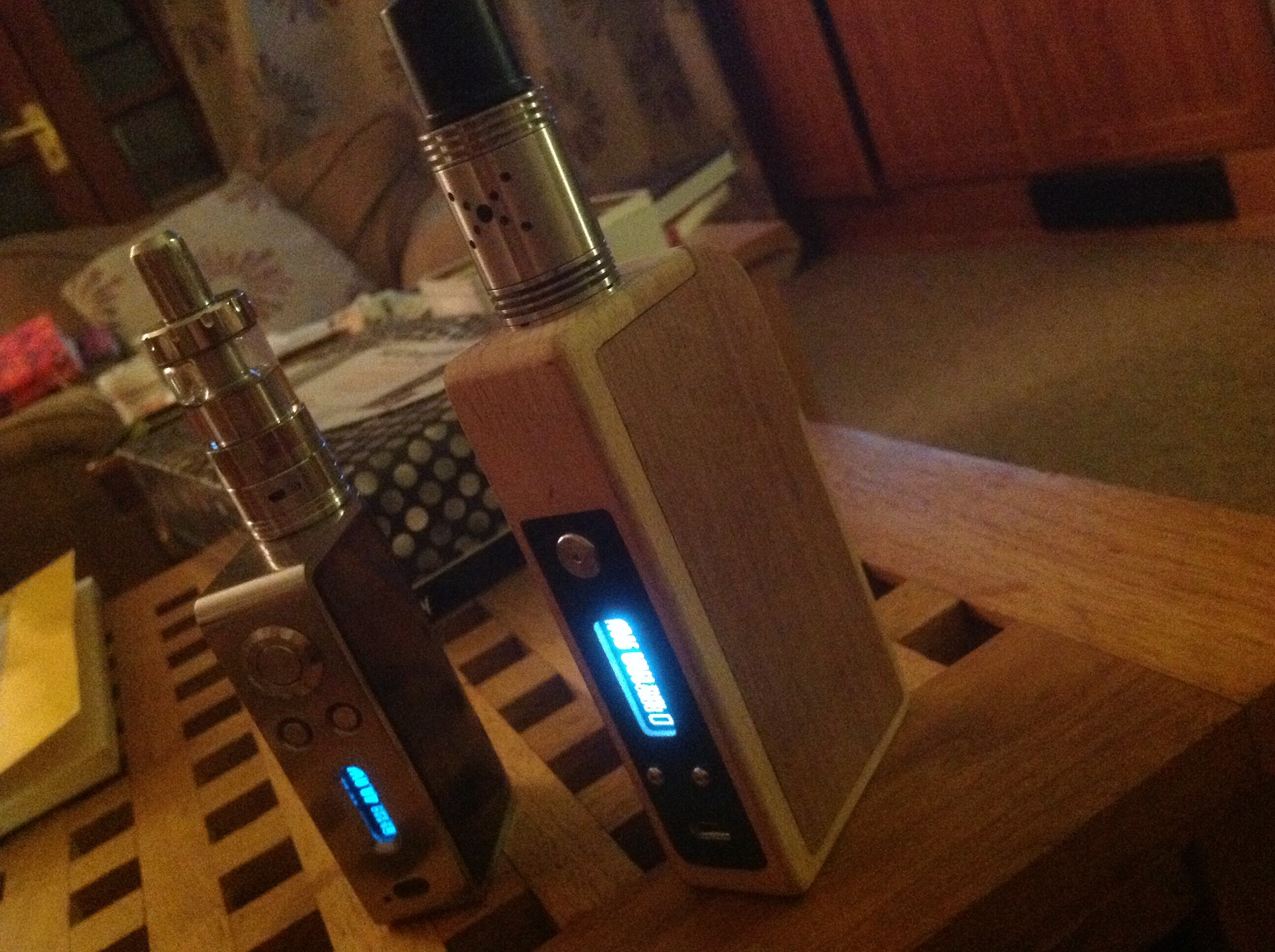

MarkM Posted August 15, 2015 Report Posted August 15, 2015 I broke the screen during my first build in a Hammond box, So I took it apart, replaced the screen and re homed the board in This wood box, much nicer in the hand

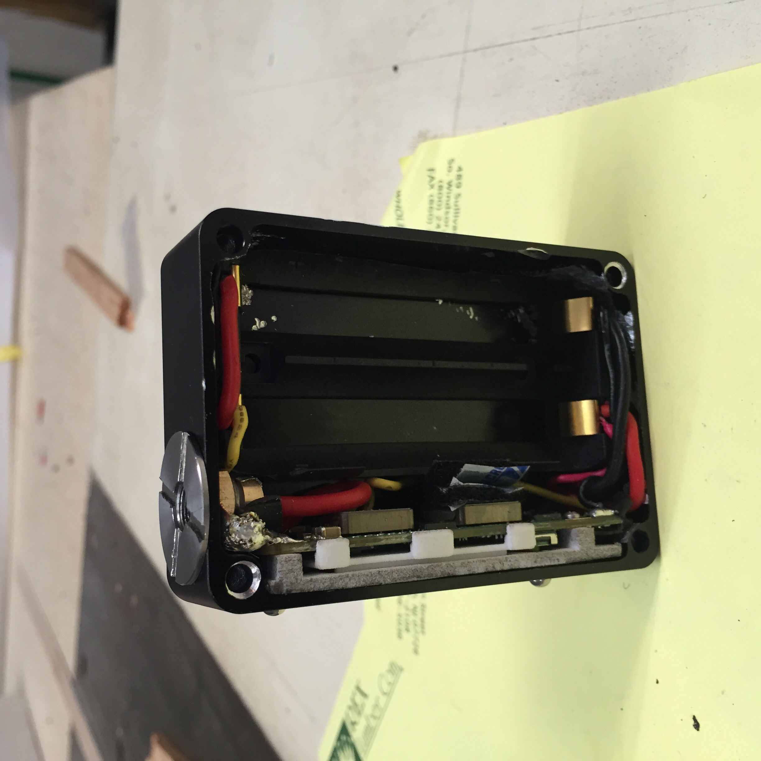

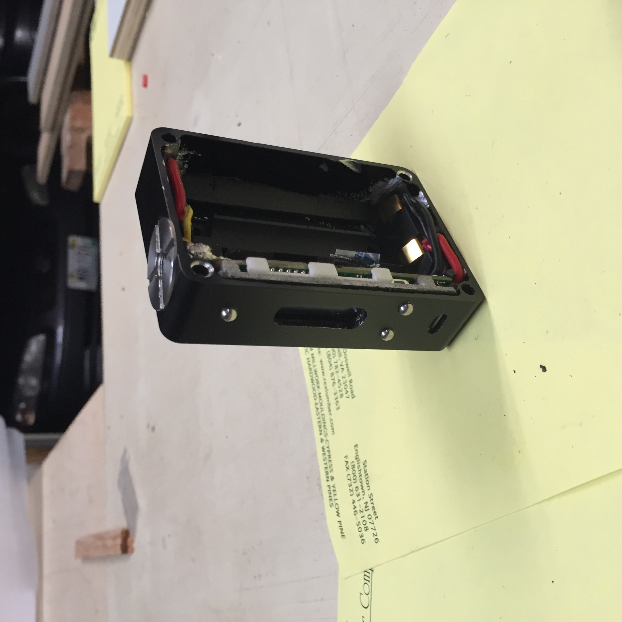

Tomr1088 Posted August 16, 2015 Report Posted August 16, 2015 Just finished this dual 18650 in a Hammond 1550p with balance leads hard wired

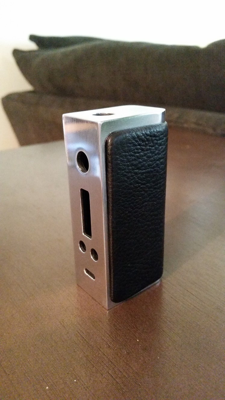

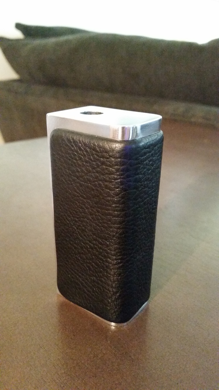

jevon Posted August 16, 2015 Report Posted August 16, 2015 I got a chance to mill out the window for the display using a 3/32" end mill. The screen is registered in place much like the Evolv reference case was. I also decided to wrap the carbon fiber sleeve with leather. It feels nice in the hand, I like the look, and it smells like leather to boot! I'll cut out another carbon sleeve when I get a chance, so i'll be able to change the look if I want. Also the polished aluminum looks great but scratches way to easy. Still going to get it anodized, maybe silver. Thoughts?Should have it working sometime this week.
FireBALL Posted August 16, 2015 Report Posted August 16, 2015 mandro said:This is my second DNA200 build.It uses a 3s 1000mah nano tech battery. I had to remove the tap connector and wire it directly to the board because it wouldn't quite fit in.Looks really good
Guest Posted August 16, 2015 Report Posted August 16, 2015 Tomr1088 said:Just finished this dual 18650 in a Hammond 1550p with balance leads hard wiredwhere did you get that gray part that's between the case and the white screen holder?
epicwood Posted August 16, 2015 Report Posted August 16, 2015 Laguz75 said:[QUOTE=Tomr1088]Just finished this dual 18650 in a Hammond 1550p with balance leads hard wiredwhere did you get that gray part that's between the case and the white screen holder?[/QUOTE]It looks like a mamu faceplate on the inside. the faceplate comes with the screen holder as well.
