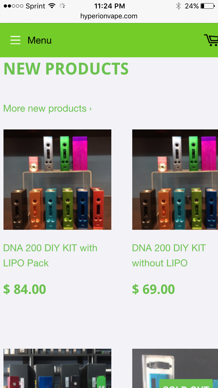

Anyone see these Hana mod enclosure kits on Hyperion Vapes site. Only 85 bucks with lipo. Chip not included. Apparently these were Hana production units but Hana never made them. They stuck with the pre production design. Weird. -

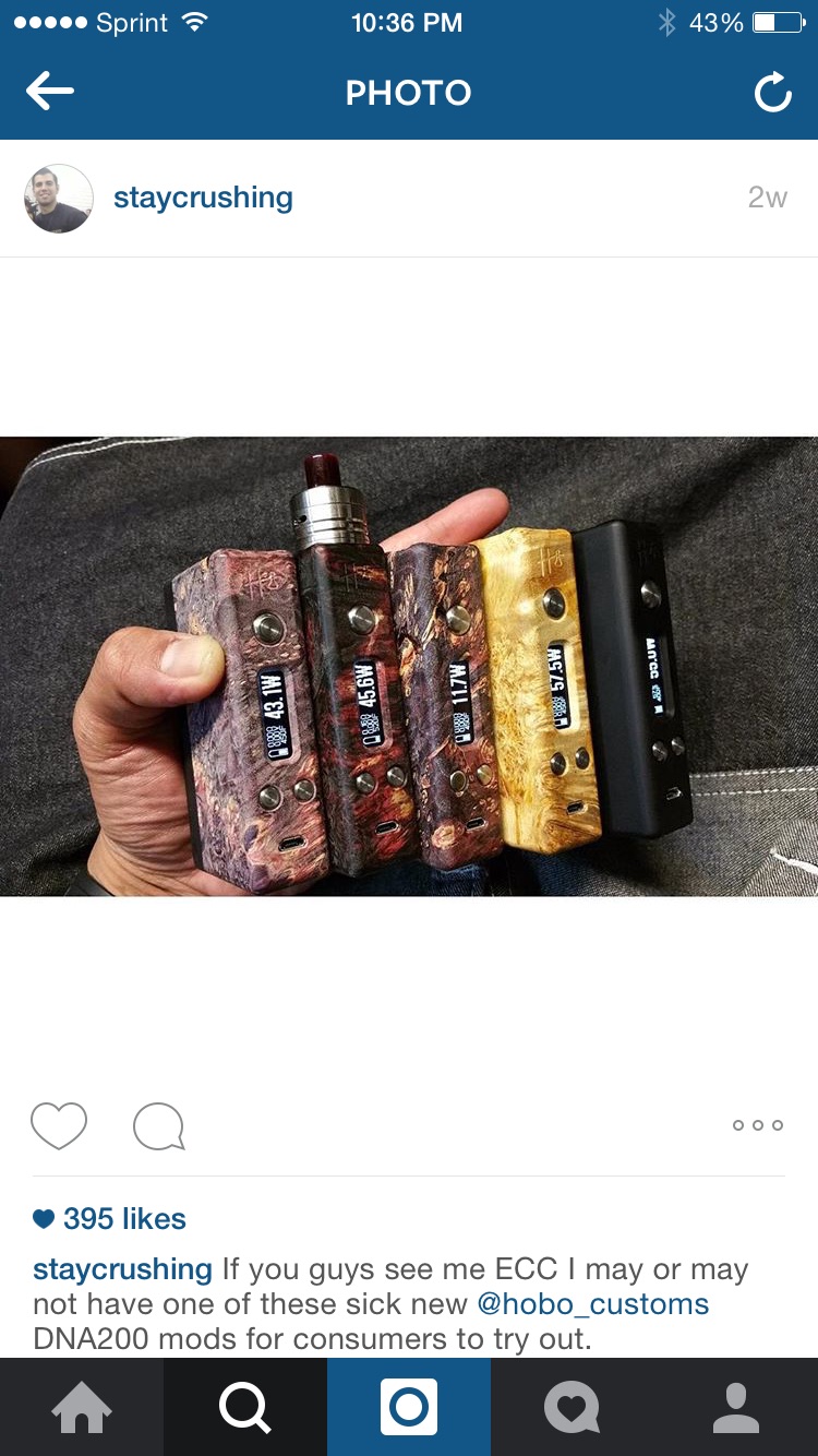

I know what you mean that's why I'm getting a hobo customs dna200 as soon as they come out. Gonna get a hybrid stabilized wood version.
I cannot wait to get one of these hobo customs dna200's. Available in 1300mah and 900mah. 1300 mah being about 3.75x2x1 inches. Stab wood 350, stab wood hybrids 390, aluminum 200. And made with perfect quality and wiring.
Also should ass it's about the same size as the esquare Dna 40 but a little taller. For 1300mah capacity and also stated as a quality fullymax battery used it seems like the way too go as far as China dna200 mods go. Battery capacity and size. And looks imo. I think it takes the cake.

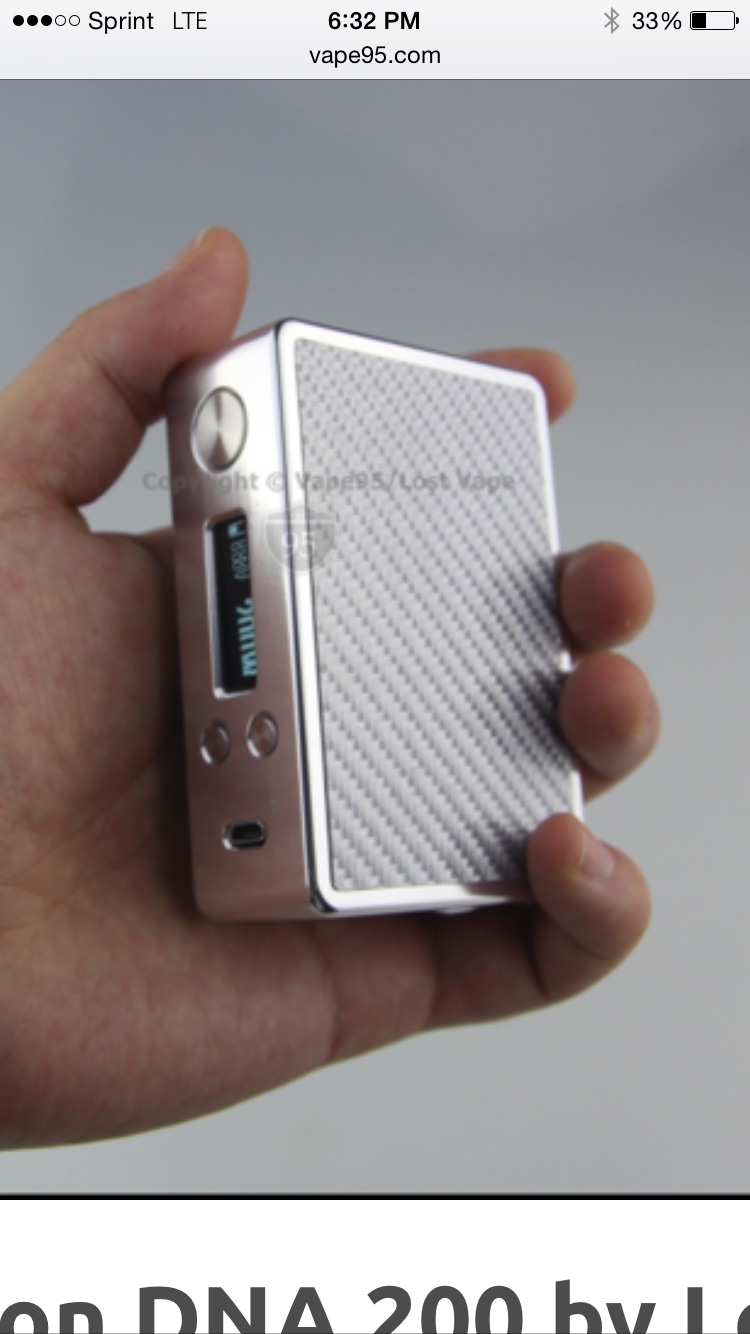

Just saw this. Although after receiving their esquare Dna 40 I returned it for poor wiring and cheap button crunchiness and overal feel. For the price it looks not bad for the dna200. Has removable 1300 mah battery and pretty small. And for 170 that's not a bad price. What are everyone's thoughts. http://www.vape95.com/products/efusion-dna-200-lost-vape
