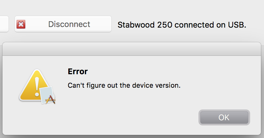

Wayneo Posted February 12, 2018 Report Share Posted February 12, 2018 (edited) System 10.13.3, all the latest updates. Install completed fine. Then mouse semi froze. ~5 second delay. Tried to open 'Activity Monitor' to diagnose what was taking CPU, and it couldn't even paint the application icons. Finally rebooted itself. Escribe ran fine and loaded SP6. Wake up this morning, fire up Esribe, and device appears in Main window, but getting error. 1 more reboot initiated by me and working so far. Mod res - Thank you, Thank you, Thank you. How low will it go? Edited February 12, 2018 by Wayneo Do my screenshots appear abnormally large? Link to comment Share on other sites More sharing options...

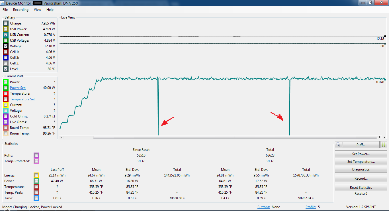

Twiq Posted March 5, 2018 Report Share Posted March 5, 2018 (edited) Hey guys, i've noticed some charging instability on my vaporshark DNA 250 (international i think, since I'm not from US). I'm not sure if this is related to firmware issues or it's battery age issue, but the last thing I did before having this issue was updating escribe from EScribe Suite 2.0 SP5.1 to EScribe Suite 2.0 SP12 to try out the new Boost feature. well, here's the deal : Whenever i charge the mod using 2A fast charging capable power source and cables i get frequent disconnection while charging. for example, i plugged in the cables to the mod, then i read the system stepping up the amps level from 0 to 2,00 A (random numbers), in less than 10 seconds the mod ALWAYS seems to drop to a state like no charger is connected to it, and after 3 seconds or so it ramps up again from 0 to 2,00 A again, and the loop begins.. i have no disconnection issues while using 1A chargers OR using 2.0 cables plugged in to 1A power sources but it sure is dam slow should i be worried? should i ignore the disconnection and keep on fast charging this way? should i downgrade the firmware and try again? any recommendations appreciated. thanks edit : forgot to mention that i've tried using different 2A Chargers/Laptop USB Ports and cables (data transfer capable or not), but it's all the same.. as long as i charge it under 2A it's all gold. edit 2 : i've uploaded the device monitor view while charging with 2A cables on 1A usb port, is it normal having down spikes like that? Edited March 5, 2018 by Twiq Link to comment Share on other sites More sharing options...

Twiq Posted March 5, 2018 Report Share Posted March 5, 2018 13 minutes ago, retird said: Early Release versions may have some bugs or some tweaking may be necessary... I've not heard of any board or charging failures from this yet. I recall reading that essentially Evolv added a protection where if the USB current or voltage changes dramatically in a frame it'll drop charging and re-orient itself. thanks for the heads up, so whenever the current changes drastically within a period might trigger the chip to cut off the charge and reorient itself. i do have to mention that my favorite fast charger adapter randomly ramps up/down rapidly reading at 1.94 to 2.00A before disconnection happens.. but i can confirm that the behavior happens when i'm using previous firmware without disconnecting.. well, i'll try changing the adapter and see what happens.. btw, have you seen my graph above? is it normal to have some spikes like that while charging? or is it the balancer taking control which cells needs to be charged? thanks again Link to comment Share on other sites More sharing options...
HolmanGT Posted March 5, 2018 Report Share Posted March 5, 2018 Twig, Did you apply the new firmware update when you moved up to EScribe Suite 2.0 SP12 ? The new firmware is supposed to fix the problem you are having. If you have the new 250 firmware and it is doing what you show in the screen capture I would suggest contacting Evolv's support guy and telling him your problem. George 1 Link to comment Share on other sites More sharing options...
Twiq Posted March 5, 2018 Report Share Posted March 5, 2018 9 minutes ago, HolmanGT said: Twig, Did you apply the new firmware update when you moved up to EScribe Suite 2.0 SP12 ? The new firmware is supposed to fix the problem you are having. If you have the new 250 firmware and it is doing what you show in the screen capture I would suggest contacting Evolv's support guy and telling him your problem. George yes, i did applied the SP6 for DNA 250, as you could see in my uploaded pic (bottom right).. it sez Version 1.2 SP6 INT i think i will contact them for support tomorrow since i left my laptop at the office thanks george.. for now i'll just charge em with 1A to avoid damaging my device Link to comment Share on other sites More sharing options...
