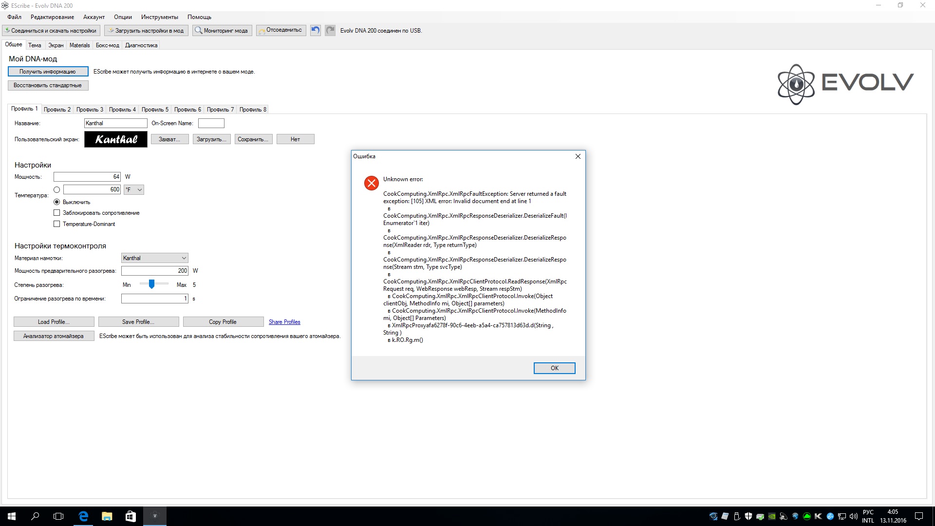

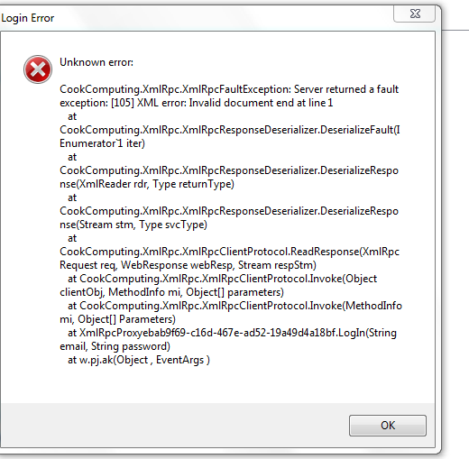

Mgeli Posted November 13, 2016 Report Posted November 13, 2016 Hi. After upgrading to 1.2 SP5, can't log in to my account and Escribe to obtain information about my mod.
retird Posted November 13, 2016 Report Posted November 13, 2016 Mgeli said:Hi. After upgrading to 1.2 SP5, can't log in to my account and Escribe to obtain information about my mod.Yep, same here and others say the same.... Evolv will get it fixed.... it may have to do with Evolv recently moving to a CDN for their downloads, since the traffic was getting kind of high. At least that's my guess....A content delivery network (CDN) is a system of distributed servers (network) that deliver webpages and other Web content to a user based on the geographic locations of the user, the origin of the webpage and a content delivery server.
Mgeli Posted November 13, 2016 Report Posted November 13, 2016 Thanks for the reply Retird.....waiting for the decision....
Yellowhorse Posted November 13, 2016 Report Posted November 13, 2016 Mgeli said:Hi. After upgrading to 1.2 SP5, can't log in to my account and Escribe to obtain information about my mod.I am having the exact same problem. Waiting patiently for a solution.
Modbustersecig Posted November 13, 2016 Report Posted November 13, 2016 Please help me Figure out why i cant log on in Escribe!!!!!
dwcraig1 Posted November 13, 2016 Report Posted November 13, 2016 Gee, got to be 10:30 PM Ohio time Saturday night......James was still working. Kudos to James.
Modbustersecig Posted November 13, 2016 Report Posted November 13, 2016 Thanks James, its working now.

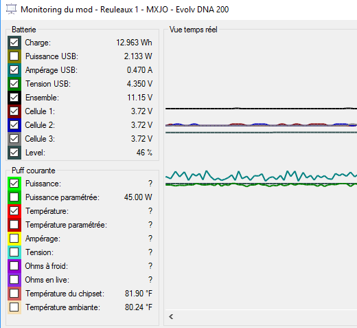

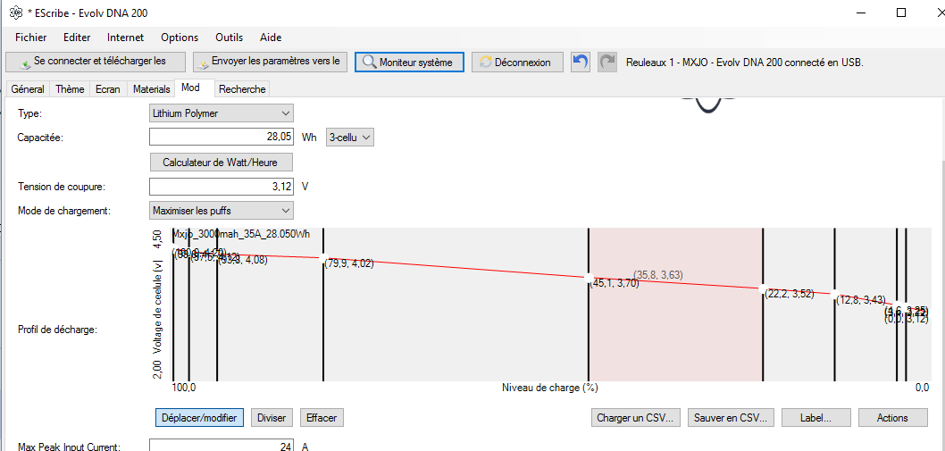

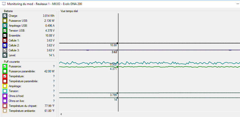

fwa Posted November 14, 2016 Report Posted November 14, 2016 VapingBad said:They have indeed, it was a problem that was only introduced with the early versions of 1.2, a side effect of other changes that should no be consigned to history.Ok, but it seems that we have another problem now. Voltage on the 3 cells is correct, but the level is very strange. When i check on my battery curve in the mod section, 3.63V is about 35.8% so why is it indicated 14% ?
VapingBad Posted November 14, 2016 Report Posted November 14, 2016 I would wait for a charge cycle as it is not just the voltage that the battery gauge uses on the 200 and 250 they also track the usage like mobile phones do.
Spector NS5 RD Posted November 14, 2016 Report Posted November 14, 2016 fwa said:Ok, but it seems that we have another problem now. Voltage on the 3 cells is correct, but the level is very strange. When i check on my battery curve in the mod section, 3.63V is about 35.8% so why is it indicated 14% ? 14% of 28.05 watt hours is 3.927 watt hours. that is very close to your remaining 3.814 charge estimate in device monitor, so that seems correct. can't say why at 3.63v it doesn't reflect 35.8%. however, 14% sounds more accurate than 35.8%, looking at your charge estimate. i'm not even positive if my math is correct.

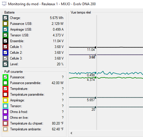

fwa Posted November 14, 2016 Report Posted November 14, 2016 ChunkyButt200 said:14% of 28.05 watt hours is 3.927 watt hours. that is very close to your remaining 3.814 charge estimate in device monitor, so that seems correct. can't say why at 3.63v it doesn't reflect 35.8%. however, 14% sounds more accurate than 35.8%, looking at your charge estimate. i'm not even positive if my math is correct.So if i follow your mind, now the level does not reflect the level of the battery reflecting his voltage but now the capacity.Ok, let's try, i am now at 20% 5675 Wh. So 100% = 5 x 5675 = 28375Wh, which seems correct. It is really strange that before the update, the level reflect exactly the reference of the battery csv. I have always used this to charge at 3.8V per cell my box for storage. I do this for my RC models as for my box .I must simply change my reference observing the charge for my different box, regarding what is the Wh at 3.8v

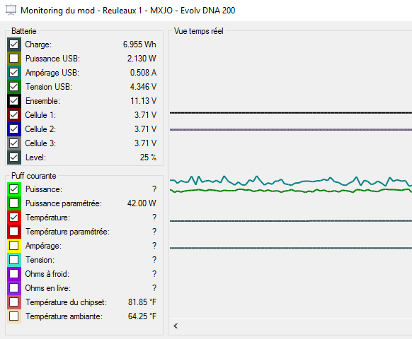

fwa Posted November 14, 2016 Report Posted November 14, 2016 fwa said:So if i follow your mind, now the level does not reflect the level of the battery reflecting his voltage but now the capacity.Ok, let's try, i am now at 20% 5675 Wh. So 100% = 5 x 5675 = 28375Wh, which seems correct. It is really strange that before the update, the level reflect exactly the reference of the battery csv. I have always used this to charge at 3.8V per cell my box for storage. I do this for my RC models as for my box .I must simply change my reference observing the charge for my different box, regarding what is the Wh at 3.8vAn update: i am now at 25% 25% with 6955Wh which mean 27820Wh.... this fluctuate a lot And after changing the power in Kanthal using Escribe, so i reloaded the parameter, i get this: A jump to 46% from before 25%...... really strange

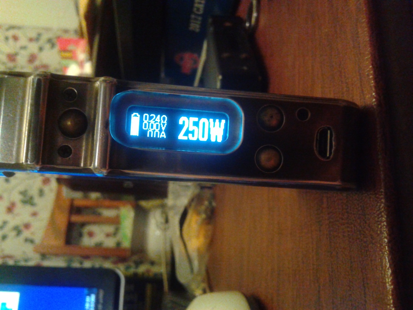

michaelraynold Posted December 29, 2016 Report Posted December 29, 2016 LostVape Triade DNA250I just notice a difference between SP3 and the latest SP5 when i charge it on my laptopSP3 Currently stable at 1.9A chargingSP5 Currently Stable at 0.9A chargingIs this some kind of issues or evolv remove the 2A charging feature on dna 250 at their latest servicepack?Thanks
