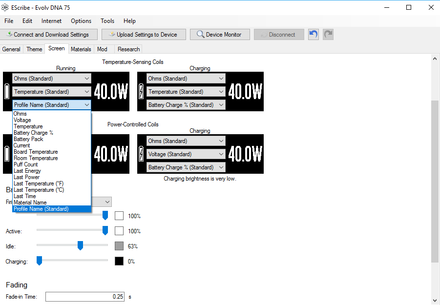

Go to the Screen Tab in EScribe. There are your choices (drop down boxes with choices) to configure what is displayed on screen... Try them out and learn what they do...
