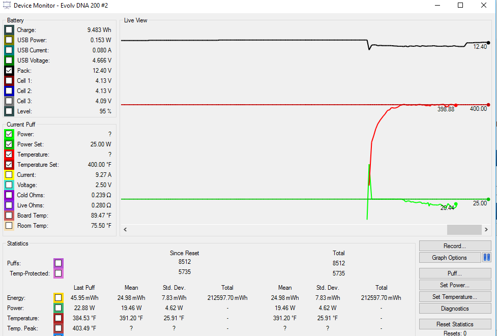

Yep, looks pretty good but what I also wanted to look at was the data on the left side of Device Monitor....the ohm's temp settings, wattage settings, board temp and etc. Kinda like this: -

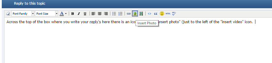

Click "more reply options" first. Across the top of the box where you write your reply's here there is an icon to click to "insert photo" (just to the left of the "insert video" icon. -

I assume the coils used on all three devices are exactly the same ohm's? I assume all devices have the "mod resistance" properly set for that device? All devices with Evolv boards are not built the same and manufacturers configure them differently. With Yihi a SX Mini Q is a SX Mini Q.... every Q is the same whereas there are many devices with the only thing common to them is they have an Evolv board in them.. they can have different guage of wire, different 510 connector, different battery sleds, and etc. A minor adjustment in temp and wattage on the one device that is not reaching temp (to the point of flashing the message) should give you the flash... In Device Monitor you can check the boxes for power, power set, temperature, and temperature set and then see how close to the temp you are for each device. Probably not the best explanation and could write much more but that's the short version.... If you want to post a screenshot of each device from Device Monitor while firing the devices (with the boxes checked that was mentioned earlier), we can certainly look at them and see what they are doing....
