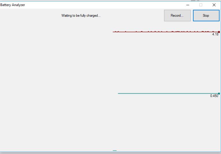

  7. Just let it run until the charge rate drops to zero and let it continue to run and see what you get? Mine charged at 0.450 and dropped to zero at about 4.18 volts.

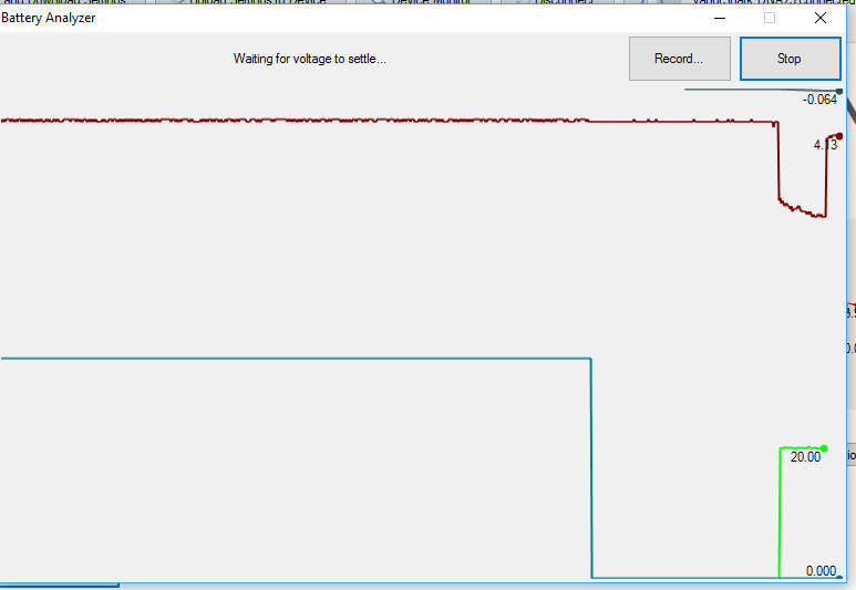

  8. UPDATE: The charge rate dropped to zero and after a short period the message said it was waiting for voltage to settle and then the analyzer started doing it's job. Here is the screen showing the first firing of the device. So, the analyzer works with the Switchbox 75.

  10. In Battery Analyzer as you run it you should see real time voltage and an indication of whether it is charging toward the top of the analyzer screen and you should see a charge rate toward the bottom of the screen. If the charge rate is zero then it is not currently charging.
  11. In Battery Analyzer does the charge rate drop to zero when the device reaches 99 or 100% charged and still is it waiting for full charge in the analyzer?
