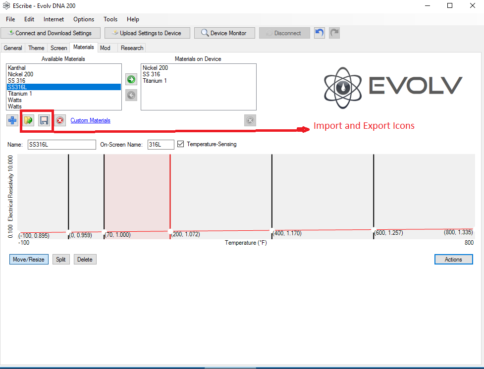

You can get the materials from Evolv EScribe: (you may already have them in the available material list) Open EScribe with no device connected. Click on EvolvDNA200. (under Edit New Settings) Go to Materials. Click on the desired material from the Available List. Select the "Export Material" Icon (below the Available Materials). Save to computer. With device connected to EScribe, then use the Import Material Icon below Available Materials to import the saved material(s). Add the Available Material to the Materials on Device and then build your profile in the General Tab as usual.
