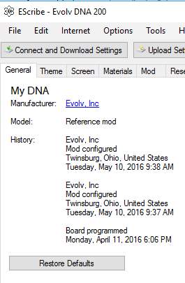

  10. You can click on "Get Information" In the General tab under "My DNA" of EScribe. There is info about your DNA board there that may help in when the board was programmed and etc. Example:

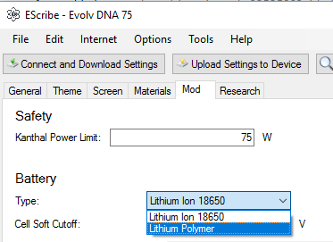

    Don't think you have a choice for 2 cells with the DNA75....
