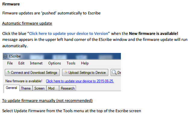

  13. I don't think it will auto-update your firmware but will place a notification in EScribe that there is an update available. Here is a link to an early tutorial that is helpful. A lot has been updated since this video but you can get a lot of "how to use EScribe" from it if you want to view it. https://downloads.evolvapor.com/escribe/guide/story.html Here is a users manual that is a bit dated also and a lot has changed but may be helpful: https://downloads.evolvapor.com/escribe/EScribeManual.pdf

  15. Note that the current recommended version of EScribe is shown in post #1 of this thread linked below. You don't have the latest recommended EScribe. Installing the latest recommended version of EScribe doesn't update the firmware (service pack) on the device until you want to update the firmware. /topic/66731-topic/?do=findComment&comment=900119 If you just connect the device to your EScribe and then start EScribe it should not change anything on the device. You can download the .ecig file to your computer from there.

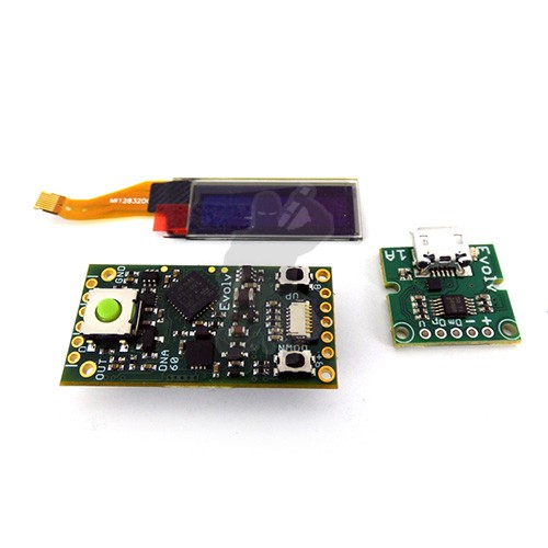

  19. So you have a DNA60 board and the new charge/data board from Evolv? Compare this picture to your boards. DNA60 data sheet link also given here so you can see the wiring pin out for the DNA60 board (I think page 11) of the data sheet. Data sheet: https://downloads.evolvapor.com/dna60.pdf Photo of boards:
