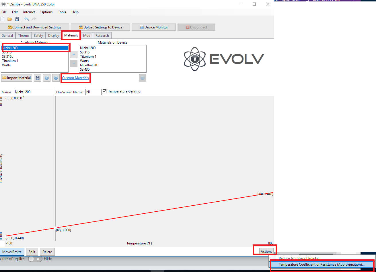

Best guess... N30 wire material per Profile 5... Your ohm's while firing are flat lining.... no change in ohms while firing thus the dna won't recognize the wire as a wire that will work with temp control (like kanthal does too)... Here is a TFR downloaded as a CSV file for DNA's from Steam Engine.... compare it to your N30 CSV.... I've never used N30. DNA200-NiFe30_(Resistherm_-_TCR)-SteamEngine.csv- 20 replies

Can you give us a screen shot showing your Profile 5 from Escribe?- 20 replies
