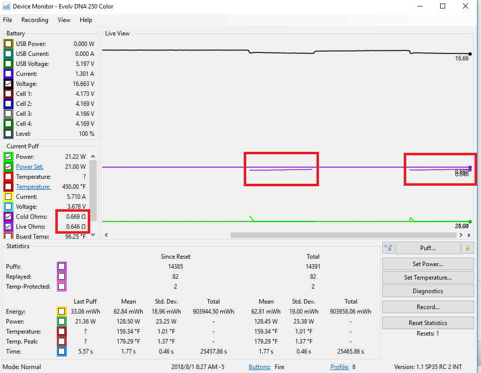

Good.... yep the longer you run the analyzer the numbers will climb because the analyzer slightly heats the atty.... glad we got to the bottom of your concern...
This just could be that you are seeing Cold ohms from Atty Analyzer whereby when using atty analyzer it slightly warmed the atomizer giving the Cold ohms. In use it reads live ohms thus the drop.... I had to dig up a Kanthal coil to see how it reacts as I seldom use Kanthal. My Kanthal coils show the same thing.... Here is my screenshot using a DNA250C device with a pre-made coil head rated at 0.60 ohms........
