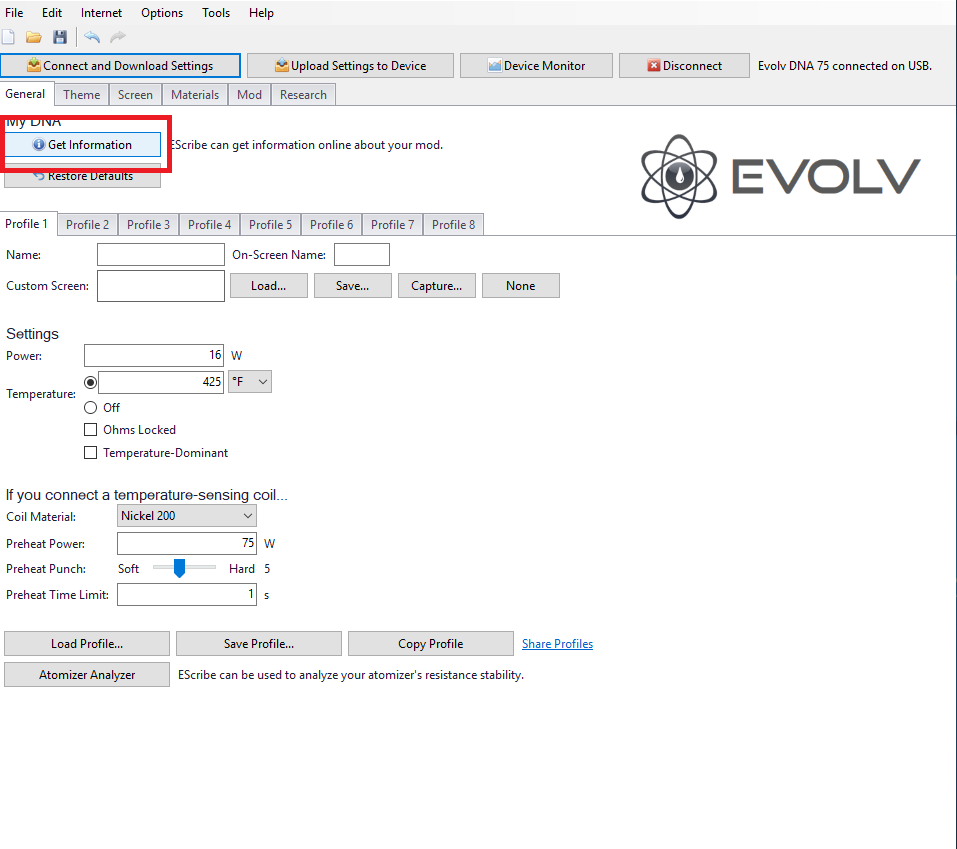

Many things can cause this... more information is needed to try to troubleshoot via long distance without having access to the device, charger, computer, usb cable, and etc. To start with a screenshot of Device Monitor with the device connected is a good place to start...

Can you post a screenshot of Device Monitor while device is connected to EScribe?

Open Theme Designer and click on Space Used.... what does it say? -

hum, kinda sounds like the wire....... so you have set the wire material to SS316 in the profile settings and it runs in TC Mode and achieves the desired Temperature but won't run Replay even when in TC mode using the material setting of SS316?
So the coil works in Power Mode? So the coil works in TC Mode? But not in Replay? What are the settings of the Profile you are using?
